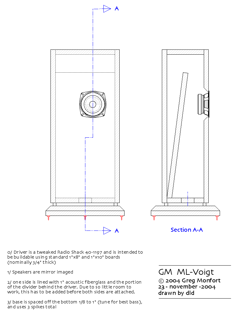

not a T-line, but works like a charm with 2 drivers per side
BD-Pipes
and
Greg M's folded ML Voigt for single
http://www.diyaudio.com/forums/full...ll-range-reference-project-23.html#post535015
BD-Pipes
and
