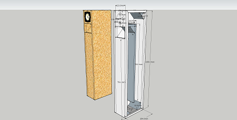

Hi all i would like to create some transmission for the fostex FE103EN i would like to achieve something similar to these fostex in this you tube video

I have made an estimation of the dimensions of the Hexibase Fostex Fe103En TL and here you are (in cm):
External Height: 90-100 cm
Internal width: 12.3 cm (+- a few mm)
Actual tube cross section: 10 x 12.3 cm (S=123 cm2)
Tube length: 180 - 200 cm
Tuning frequency: 41-47 Hz
Volume (internal): 22-24.5 liters
I've spend some time before arriving at those dimensions and I'm pretty sure they are correct within those limits.

You don't need to thank me for calculating them, you are not the only one around the globe seduced by those towers you see in the video.
By the way, if you have acces to the MJKing's spreadsheets you might want to see how it behaves, from my hornresponse simulation it's ok for the volume but it will lose 2-4 dB in relation to the nominal SPL, however it may not reflect reality, in the sense that the peaks and nulls might be much less severe and the depression in the the 50-90hz region (about 1-2.5 db) might not exist in reality. But that doesn't mean it won't sound ok in reality, BIB's have a very rugger frequency response but they sound good in reality (my ears don't know that for sure, I'm just reproducing other people's words).

And another thing - hexibase uses he's own software and formulas which take into account everything, not just the parameters of the driver, also placement in the room and driver placement in box, probably the position of the mouth too ... so in order to reproduce the sound from the setup in the video ... I don't know, you need to be a little lucky, unless you have the means to take into account the room and speaker placement in your design. Just try a simple improvised build of the design (one enclosure) to see if you can get the same sort of sound, and if you can get the song from the video it's even better, I don't know what it is, I would use it my self for testing.
yeah ok i thought by the way he calculates it there is something to do with the placement in his room, But by the looks of the room he has got it in my bedroom is the same sort of size i have got more ceiling space but the plan was to build them and see what happen but after reading your post i might just build one of them and see how i go just in case it turns out nothing to what i have expected

K's TL for FE103En
Hi there K: What is the area of the port? Do you recommend corner deflectors as shown in Supersteve's TL ( deflectors reduce box volume )? ...regards, Michael

I forgot to mention that the tube (TL) has a constant section, the "deflector" is probably a means to maintain the S of the tube constant as it corners in the box... so it is 123 cm2, but don't forget I'm just estimating, I don't know for sure.Hi there K: What is the area of the port? Do you recommend corner deflectors as shown in Supersteve's TL ( deflectors reduce box volume )? ...regards, Michael
I have never heard of anything like "deflectors reduce box volume"; the apparent box volume maybe can be enlarged by adding something fluffy on the walls but since it is not a common practice it probably doesn't do much good.
By the way, I don't know how much a deflectors would help but considering that the nearest wall behind the cone is the magnet itself, and it's very close and in this case very large.

well i have order the fostex but haven't received them yet, i have made a bit of a mock up of the transmission lines using your dims from up the page and put my corals 4a-70 in it to see how they go but not really the right driver for the TL, i'm going to wait and see what it sounds like with the fostex and go from there but somehow i think the bass in the video is too clean for the xmax of the speaker
Even so, you might get an idea of the "personality" of the enclosure... actually it's a tone coloration that is unique to every enclosure, related to all sorts of things (size, material, height of speaker, shape etc.).

I just watched the video. The drivers may play that low in the cabinet but not very loudly. It looks like he is in a small bedroom and it may work well for that purpose, but I would be very wary of blowing the drivers trying to play too loud, and in a normal sized living room you would lose that bass and tuning it that low would limit the voulme of the speaker over all. This design is good for a small room or near field monitors, but for a mid sized to large room these drivers work best tuned to 70hz or above and augmented with a subwoofer. At least that's what my experience and the specs of the drivers would indicate.
some thoughts
Here is the way I presume it was done by hexibase (he's name is Pete in reality): you take conventional alignment theory and add a few more variables such as driver placement in room, room size(s), windows, doors, and the same for the mouth of the TL and make some king of an impedance match between all sound sources and portions of the surrounding environment that are of interest, such as listening position, room in general. In other words he chose the lowest tuning possible for the given acoustic system (driver, enclosure, room), not arbitrarily but by mathematical means, something that you cannot reproduce just by copying the architecture of the enclosure and/or the dimensions; the real question that bothers you or I is how much tolerance you have before you have a faulty design (bad coupling). The truth is that you can probably replicate the effect without the secret formula, as long as you have the time/energy to experiment with what works and what doesn’t in your listening room.
I’m really curios why he chose to place the mouth so far from the floor and so close to the driver.
By the way, the lowest tuning generally used for a TL is 0.707 Fs, and in the case of Fostex Fe103En that would be 58.6 hz (Fs=83hz); tuning at about 45hz would mean to tune almost an octave lower that Fs.

I imagine the high mounted mouth was for two reasons. One being that's where the end of the line ended up being, and two to minimize imaging problem associated with mid frequencies coming out of the mouth. Damping materials (not "dampening") greatly reduce midrange through the mouth but also reduce bass.
