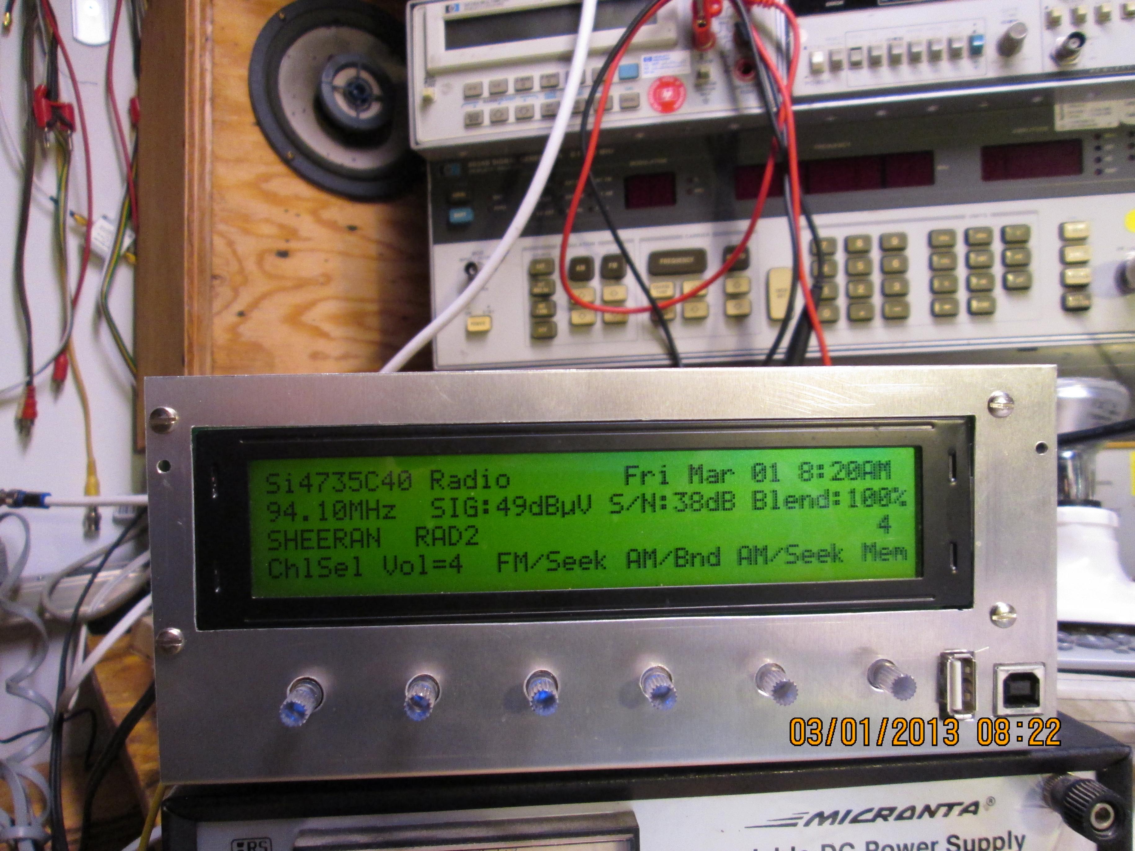

Rsavas built a very nice all-in-one CPU controlled FM/MP3 receiver with a TPA3100 and did not report that interference was a problem. http://www.diyaudio.com/forums/class-d/219730-tpa3118d2-4.html#post3392283
Wether it is because of the area I live in, perhaps I need a roof antenna? With either the tda7297 or tda7294 I get no rf interference.

Shielded inductors as Rsavas pointed out should really make a big difference. Encasing the amp inside a metal shielding box that is grounded and separate from the FM board will help too. But simple use of class A/B amp, if that sounds good to you is an acceptable solution. The class D is more power efficient so for someone using solar power and batteries may be necessary.
