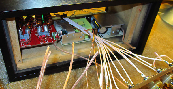

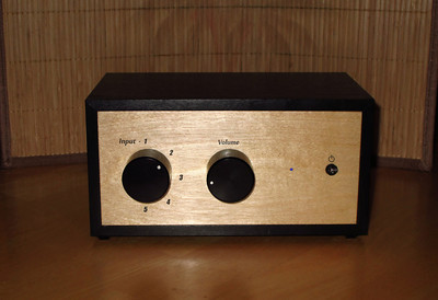

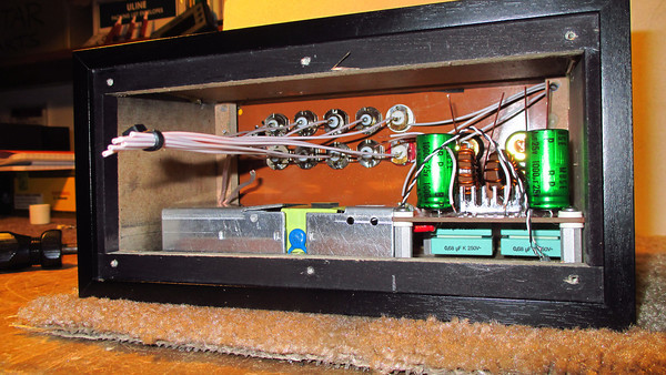

I finished the first of three TPA3116 based amps.
This box started out as part of a a cheap Tivoli knockoff am/fm radio.
I like the simplicity of it's appearance.
These boards really offer good performance for the money.
You should really think about selling. That is really cool. Again, that is serious hipster bait gear.

Wow, you did it again!! That looks really cool!
Is that a SMPS? Did you buid that too?
Thanks!
Making these DIY amps look nice is new territory for me. My projects typically look functional but not very aesthetic, so it's been fun trying to spruce them up a bit. The next one is pretty interesting looking, but it's a ways off from being done.
Inside is a 20V 5A laptop power supply that I had to remove the case from so that it would fit inside the box.
I usually like to use external power supplies but this time I was compelled to fit everything in the box.
