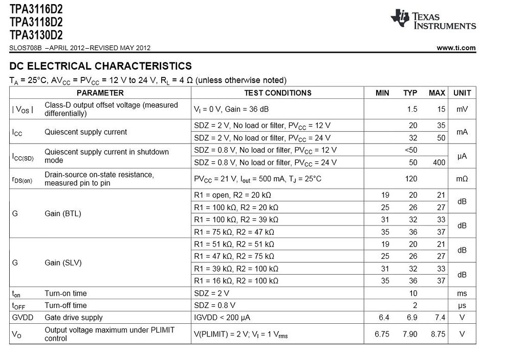

Just curious, how can one change the gain of the board?
It's included in the datasheet as shown here....
I will try it with the next 3116 I'm putting together for a friend.

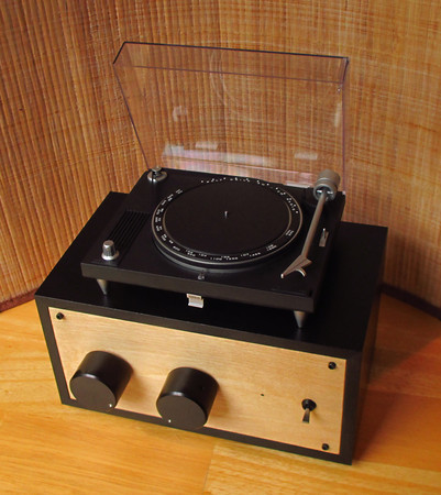

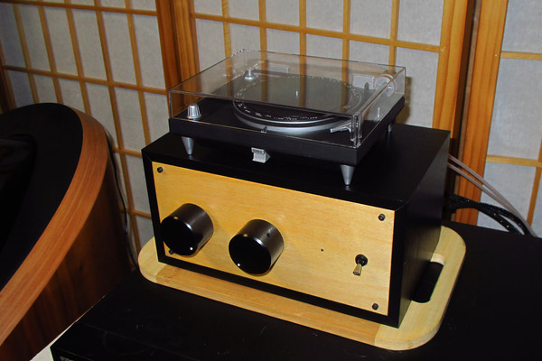

You should really think about selling. That is really cool. Again, that is serious hipster bait gear.
Speaking of hipster bait audio. That amp would go great with something like this.
Love the Cardas posts. They are the best.
Your post about the similarities with the Orbit turntable gave me an idea. I've had this little novelty radio for 10+ years and if everything goes as planned it will eventually be able to serve 24/96 WAV files via an SD Card slot on the back. I like the idea a lot so I think that I'm gradually becoming a hipster too.
