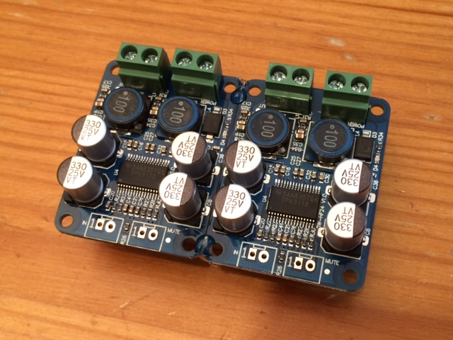

Can someone post which Rxx designation on the Sanwu 3118 PBTL the above TI "R1" and "R2" correspond to? The spec sheet says R1 goes to pin 8 and R2 goes to pin 7. But the lines are very tight and I can't tell. I am guessing it is R27 and R28 on Sanwu?
TI sheet:
Ok, a few minutes with magnifier and probe indicates R27 on Sanwu is connected to pin 7 and 8, and R28 on Sanwu is connected to pin 8. Thus R2(TI) is R27 and R1(TI) is R28.

Please check the current version of the datasheet. They labelled them R1 on the left and R2 on the right now 🙂
It are R27 (=R2) and R28 (=R1) on the Sanwu AFAIK but I don't have access to the boards right now to verify.

What were the resistor values used on the Sanwu that had 32db setting?
I'm probably going to need that.
39k [393] & 100k [104] ... on both boards that I have, purchased at the same time

A quick question. I´ve bought a few of these blue boards and was thinking and using them for bi-amping my main speakers. If i ran the same input into two boards would that cause any issues with input impedance etc.?
Any input gratefully received
Can adding a 4.7k resistor in series help to increase the impedance to make the load less taxing on the pre amp? It probably has enough gain that any signal attenuation by the extra resistance would be negligible.
Change them to 20 dB and your troubles are over. Just remove the resistor on each board. That way they'll be 60 kOhm each so 30 kOhm in parallel.
Pic of one of the two 32dB boards with the resistors very clear:
Remove R28 (4.7 ohm)?
