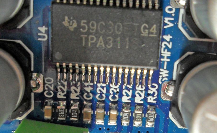

Can someone post which Rxx designation on the Sanwu 3118 PBTL the above TI "R1" and "R2" correspond to? The spec sheet says R1 goes to pin 8 and R2 goes to pin 7. But the lines are very tight and I can't tell. I am guessing it is R27 and R28 on Sanwu?
TI sheet:
Ok, a few minutes with magnifier and probe indicates R27 on Sanwu is connected to pin 7 and 8, and R28 on Sanwu is connected to pin 8. Thus R2(TI) is R27 and R1(TI) is R28.
My latest two boards have R2=753 (7.5kohm) and R1=473 (4.7kohm) or 36dB.
Four (eight?) different sonic signatures available too. I suppose that the hissing selection (36db) isn't valid, so, just 3 then.
20db, 26db, 32db gain settings could make your amp sound different.
Also, 60k, 30k, 15k loads could make your source sound different.
It is valid, just logically higher noisefloor and inputimpedance could create some problems.
What were the resistor values used on the Sanwu that had 32db setting?

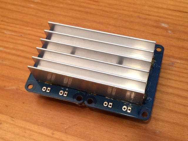

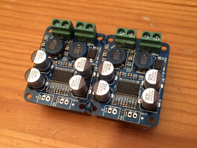

I am putting together my next Sanwu 3118 PBTL. This one is a little stereo amp I am making for a friend. It's got a small heatsink glued to the bottom (took it from a $5 TDA7294). This one has the 36dB gain and I am thinking that is too much and should swap out resistors for maybe 26dB? I added some nice terminal blocks (spacing on pin had to be manually adjusted just a bit smaller from standard 5mm pitch.
