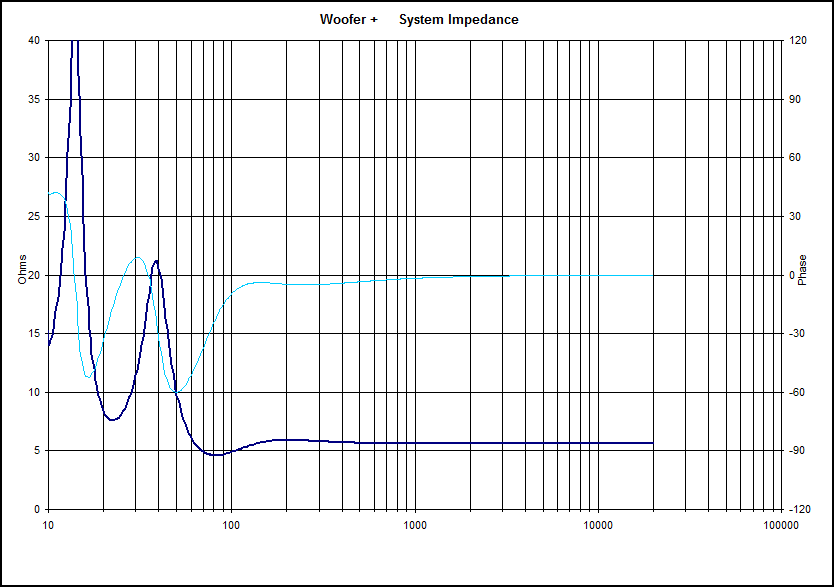

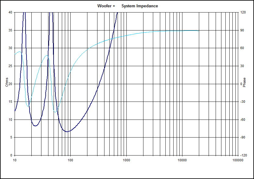

Hi Felipe!
Maybe you forgot to mention in this thread that you are using a large inductor as a first order LP filter and you can't compensate its inductive reactance (Xl) just by inserting Zobel values,for example 9uF and 7 ohm. These can only compensate for the voice coil Le which is about 1mH at 1 kHz (SB23NRXS 45-8) and your values are ok for that matter but in order to see that in an impedance plot you'd have to remove the LP filter inductor. The only way to completely flatten the impedance is to place an RC filter before the LP filter ( directly in parallel with amplifier output) but that would not change one bit of loudspeaker SPL assuming you're using a typical constant voltage amp. So, the rise in impedance that you measure is normal. Zobel filters are usually good when there is a need to shape the response in a certain way to accomplish better summing at XO frequency.

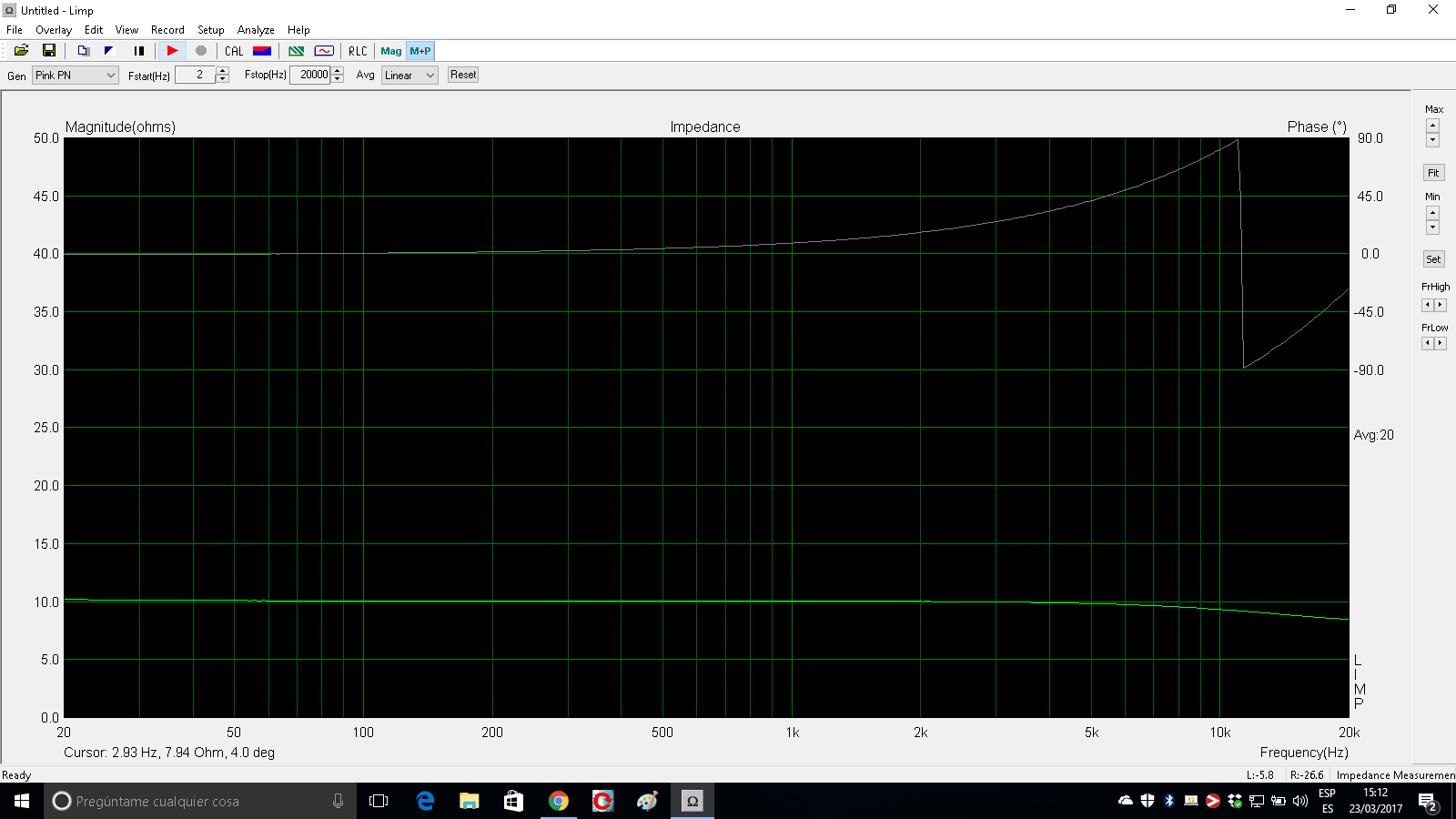

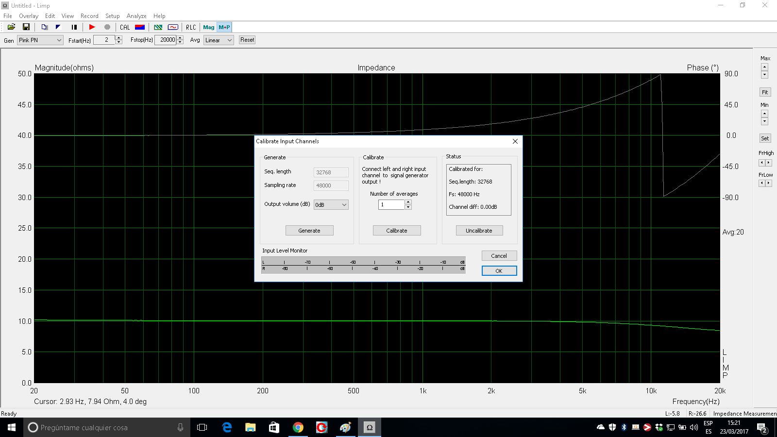

Hi merlin el mago,
Before you run an impedance test in Limp, make sure you run a calibration test via the CAL button.
After that, measure the impedance of a resistor (for example 8.2 ohms metal film or metal oxide). If the response (in ohms and phase) is nice and flat, you can then be assured that your loudspeaker impedance measurements will be accurate.
If the response in ohms or phase are not flat, you may be able to correct this via the cable compensation button next to the CAL button.
Hope this helps.:)
Peter
Thank you Peter, this is the best curve I can get with 10R 0,5% tol. metal film resistor, is OK for measurements?

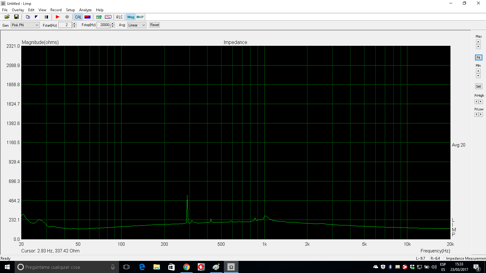

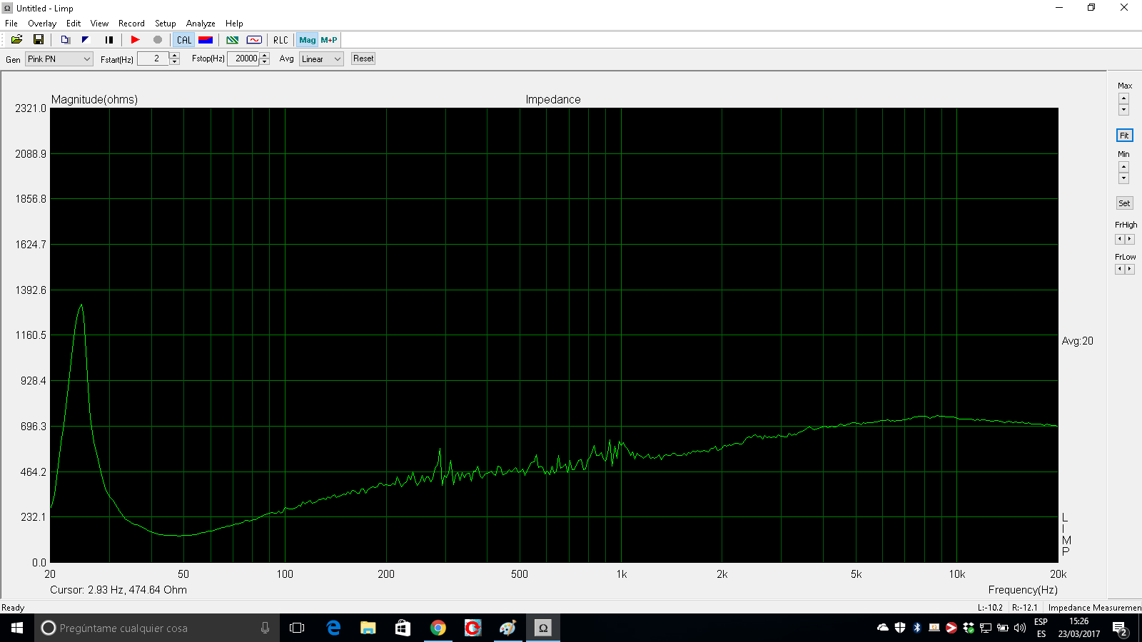

Measuremet only zobel 121uF + 8R2 without any kind of filter.
Your measurements of a driver and a Zobel are unreal. Whatever you've placed in the impedance jig now reflects itself into the total Z magnitude. You have 8 ohm speakers with impedance in the range of 100 Ohms! That's obviously wrong. Go to ARTA thread and ask for help. The measurements of 10R and 2R2 resistors only shows that these ended up being okay.
Joined 2009
Thanks. Do you have link to ARTA because using the search forum I only get a thread telling when a new release is coming.
