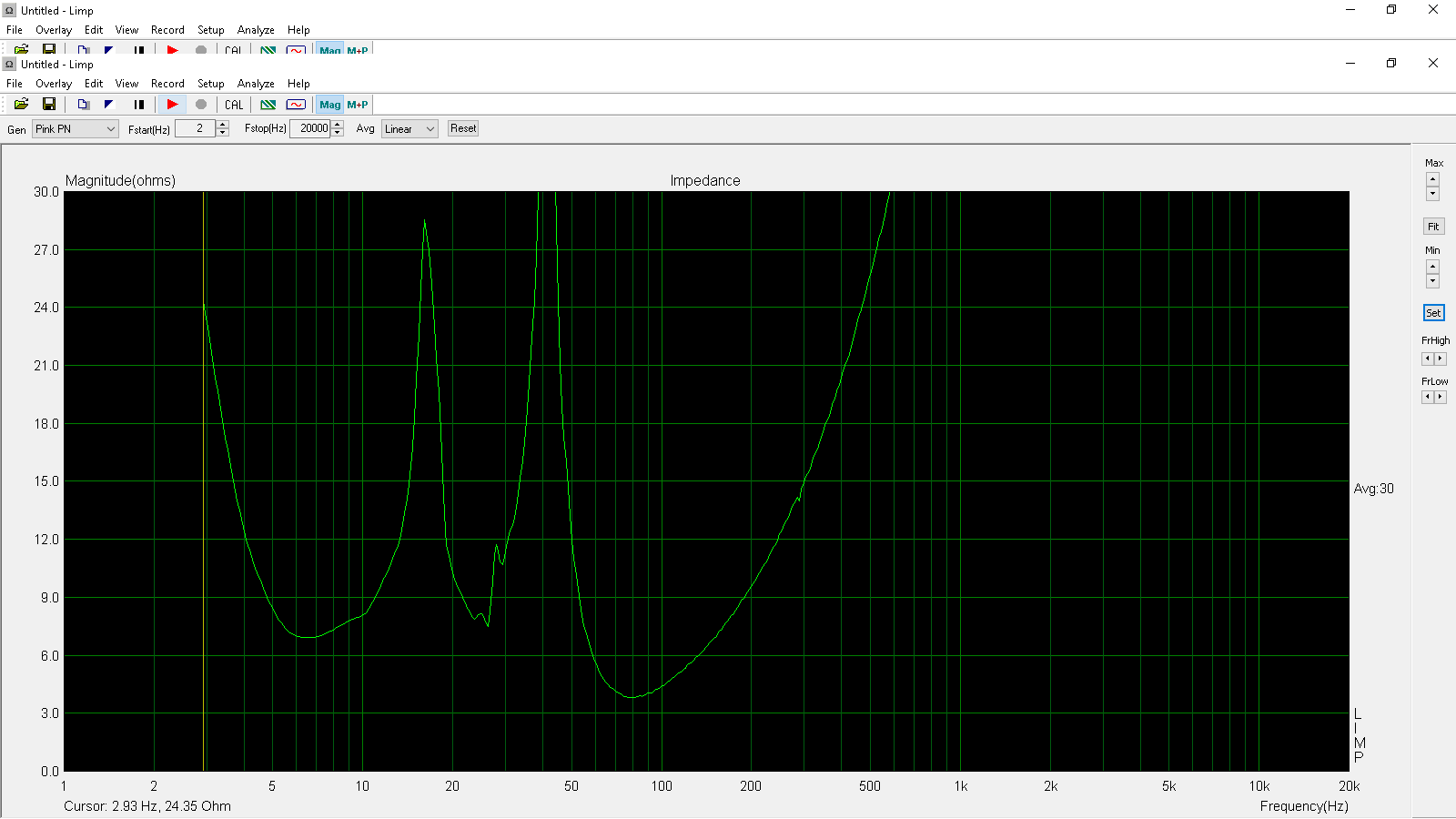

I fail to understand why you need a Zobel on that driver, considering the fact that you want to cross it under 1.5KHz, and preferably under 1KHz. What Steve is saying is that not every RC across the driver is a Zobel. The TG crossover has a 2nd order electrical slope on the woofer, as is seen in many other designs - search on those in which you can see the values of the components.

3.9mH with a 56uF and 1R
Not a bad choice, but there are plenty of similar ones which we might call "damped second order filter", nothing to see at all with what some would erroneously call a first order + zobel.
In most situations linearize the impedance curve is totally overkill, and you just need to fine tune the value of the resistor to "damp" this second order firter to a proper Q.
There are no magic formulas to get this done. You can use the Optimizer in Lspcad for that purpose: just define your target ( xover type point order slope and level), and you are done.
In this case ( i used your impedance data), it's better avoiding too low xover points like 200hz if you want to keep simple, but 400-500hz are easily achievable targets.

Copper sheath over the centre pole.
What will be the best xover point, when the phase is 0º 500Hz?
The SB Acoustics speaker uses this copper cap method to minimise the inductive coupling of the coil to the iron components of the magnet assembly . This is clearly indicated in your Notebook readings and I would consider for this speaker that a correction network is not required if you choose a crossover frequency near 500Hz. I would consider that a conventional second order filter such as the Linkwitz Riley would be a better match considering the anomaly in the frequency response around 1kHz.

But VaNarn has got it right here. This SB Acoustics woofer is such low inductance, that it is scarcely worth correcting it:
It sure goes to pieces above 1kHz, though. Not your well-behaved bass driver suitable for a two way.

Imho, the way to go is get a set of frequency response / impedance measurement, chose a target and a circuit topology and check with your favorite cad tool if you can get some useful component values for the choosen target and topology.
Civilized drivers allow simplest topologies. This SB model is a piece of cake as a woofer provided you avoid using it as a mid-woofer, AND you cross it also high enough to avoid the influence of the impedance peak in the bass. Or will you try to hammer this flat too with some kind of mastodontic LCR stuff?
