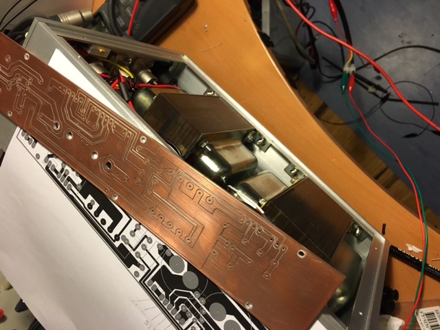

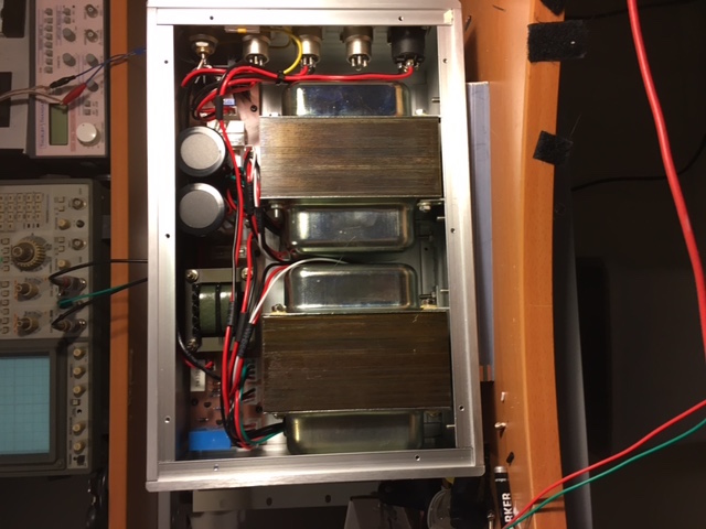

My Zeus Ver.2.0
After long time I finally completed the reconstruction of my Zeus amp after finding impossible to reduce to an acceptable level the noise of 6c33c and replacing the tube with a mosfet.
The setup
Single-ended to Single-ended Mosfet driver at the input IXTP08N50D2 28V 430mA
Single ended - push-pull interstage transformer 1:10
Push-Pull power stage IXTH20N50D 34V 800mA each
Linear Phase Shift from 20 to 50KHz <2 degrees
It sounds amazing.
What first impressed me:
- Sound stage
- Fast
- Air
- Detail
and finally is totally quiet.

Hi!
Could you give me some more details about your Single ended - push-pull interstage transformer 1:10?
Greets:
Tyimo
I tried a few winding configurations and methods. I tried to do a perfect layer winding with 0.14mm wire under magnifying glass without crossings but it gave worse results in terms of bandwidth. The winding arrangement I attached worked best and the winding is just an easy one without layers. This gave best bandwidth results.
I hope it helps.
  • interstage.pdf

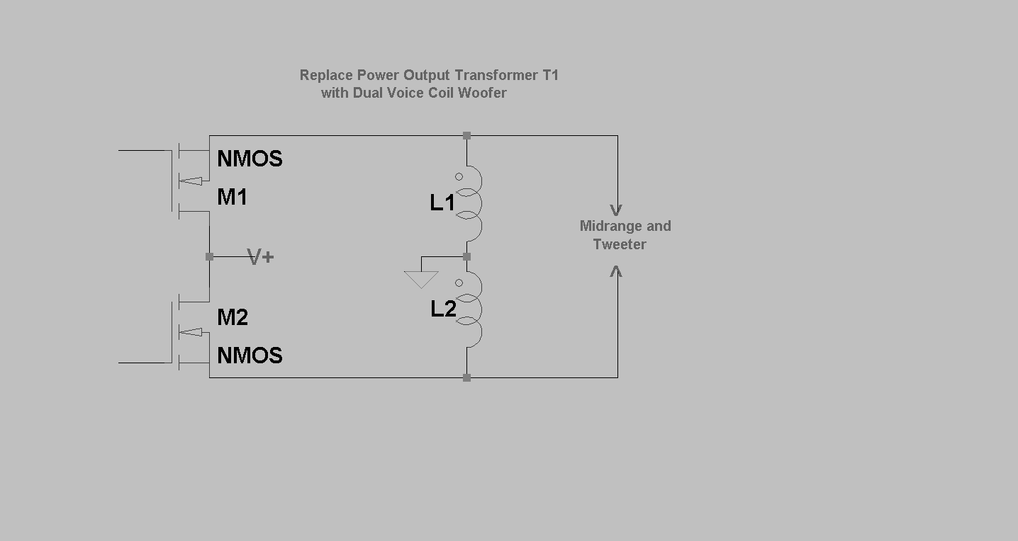

Post # 1 of this thread shows T1 power output transformer. The attached schematic suggests using a dual voice coil woofer instead of T1. Maybe this approach is already buried in one of the 1600 posts!
T1 is actually the input transformer. T2 is the output transformer through which each mosfet pull 750mA@34V from the C/T ground.
Are you sure you wanna do the same through the voice coil of the speaker?
Surely you will smoke it immediately. Besides a speaker is not a transformer nor a choke .
Susan quoted “An important thing to understand is that the output transformer's primaries swing negative as well as positive and the MOSFET for the half of the cycle which is negative is still powered but "idles" with most of the current flowing through the MOSFET going positive. However the negative arm MOSFET "WILL" regulate if something tries to overrun the main positive arm MOSFET position.”
I think the schematic would suggest to use inductors (or half transformer) instead of the transformer's primary and secondary. I remember Susan commented that particular circuit by connecting both mosfets and speaker on the primary of a transformer.
