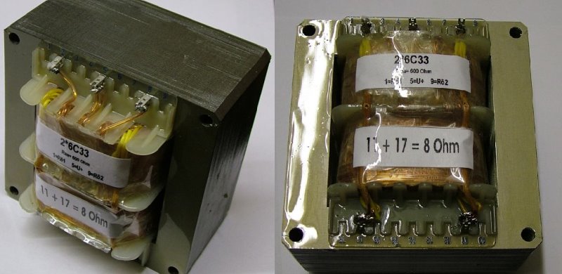

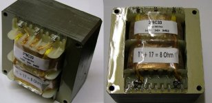

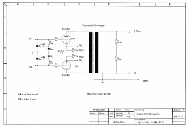

Output Transformer orig. for 2x 6C33 Trioden
@susan !
Hi Everybody,
what about these Output Transformer; orig. for 2x 6C33 Trioden for the Zeus Amp ?
I found these information about the Output Transformer:
Raa = 600 Ohm (Gegentakt == push-pull)
R = 8 Ohm Out
Kern M102b
0,35 Blech
And some infos on Trioden Push-Pull Vollverstärker with the 6C33
See this picture from this PP Tube AMP:
Any comments ?
Thanks !
(This is the Transformer)

Zeus 6C33C Triode Amplifier
Hi Uwe,
Thank you for your post and the info
Ah! Okay, I was hoping to have a bit more think time before getting down to details on this one
Here is my concept schematic for the tube version of the Zeus amplification stage which I mentioned in the previous post.
Note that one would use two of these stages.
Either the first as a 600 ohm line driver and the second as the power amp where the two are separate, or the first driving an interstage transformer to the second stage.
Please note that the bias and supply voltages for each stage will be different.
The "B-6C33 HiFi push pull transformer for power stages with 2 x 6C33" could be used here for T3.
Frequency Response is quoted at 20 Hz (-0.2 dB)...100 kHz (-3 dB) which is good
==== Note ====
I would however not use these transformers for the mosfet version as the step down ratio is a lot higher than that needed for the mosfets. It will work, and if you only need one or two watts for a super efficient horn speaker or headphones then should be okay.
To be honest the output transformer for the mosfet version is easy to make and if one has the skills necessary to make the amplifier then making the output transformer is not difficult - honest.
Getting the bits may be slightly awkward, but Thomas and Skinner will sell the laminations in small quantities to us direct, and enameled wire is available from several sources.
I am thinking of doing a small bulk buy on EI120 transformer bobbins (unwound) - (please let me know if you are interested) - as these are the only parts that are difficult to get hold of in ones and twos.
Even the version of the output transformer with the split bobbin can be wound by hand, and whilst identical number of turns is preferable to get the best performance one or two turns unbalance between the sides isn't a problem because of the way the primaries are wired up with half of each leg from each side.
==== End Note =====
The 6C33C power amp input/interstage transformer will need to be something like 1:20+20 just to get some some step up, which is quite a hard load to drive.
The B-6C33 output transformer is from "EXPERIENCE electronics":
http://www.experience-electronics.de/englisch/bauteile/ausgangsuebertrager.htm
... N.B. the B-6C33 info is at the bottom of this page.
Price Euro: 149 each.
In the zeus configuration with a pair of 6C33Cs I would expect to be getting about 12 watts into 8 ohms, 25 watts max.
It should be possible to prototype a single stage 6C33C amplifier using mains toroids, although the bandwidth will be much reduced (20-ish kHz max).
Please note that the zeus 6C33C tube version is very much at the formative stage in my thoughts and the schematics shown are only general arrangements and do NOT show any bias arrangements or additional components that might be required in a specific implementation.

dx.master said:@susan !
Hi Everybody,
<snip>
Any comments ?
Thanks !

I found these nice Push-pull Tube 6C33 Transformers for only ~ EUR 49,- !
See the Ebay the auction
And so i think don't ask why?
Now i have the answers !
Many Thanks to Susan !!

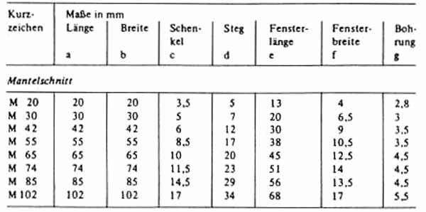

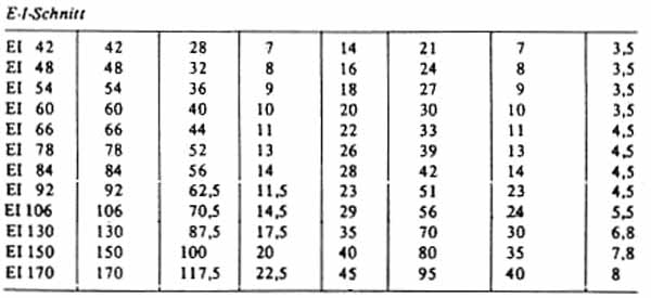

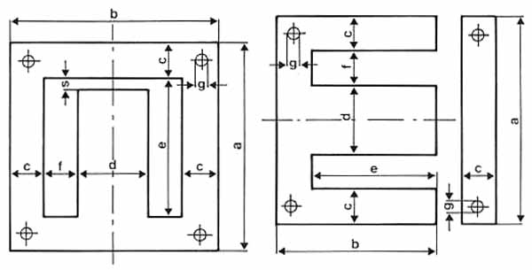

Bases to the winding of transformers
@ all !
i found something more about m102b an so on..
German: Grundlagen zum Wickeln von Transformatoren
English (translatet by google): Bases to the winding of transformers
So i can learn mutch more about "winding of transformers" !
