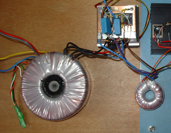

Hi Graham,
Nice to hear from you
I appreciate you spending the time, thank you.
I am pleased that he liked the system
Yes...
For any given bias setting there is a trade off between transformer mode (2:1 or 4:1 step down) output power, impedance and distortion.
I can get higher powers by increasing the PSU voltage. But this increases the quiescent dissipation unless I decrease the bias (but this increases the distortion levels) or requires bigger heatsinks.
I know you know this one
High powers in the hundreds of watts are possible, as has been demonstrated, but this is not my personal interest (100 watts peak into 4 ohms for a low bass driver is probably as much as I would ever need).
Test setup summary:
Maximum Output (PSU approx 34 Vac).
4:1 Tx = 10 Vrms = 12.5 watts
2:1 Tx = 20 Vrms = 50 watts into 8 ohms.
THD+N, 1 kHz at 2 watts into 8 ohms:
4:1 Tx = 0.0058%
2:1 Tx = 0.027%
Output impedance, 1 kHz:
4:1 = 0.25 ohms
2:1 = 0.99 ohms
N.B. I measured the TPA6120 line driver THD+N = 0.005% so I am at the limit of my current setup (and the 4:1 levels may be even lower).
Residual noise is down near the minimum levels capable of being measured by a 24 bit converter i.e. -146.25 dB (N.B. most of the graphs have test signal at -6 dB). (I need a higher resolution converter.)
Still sorting out some of the methodologies for the testing.
I am building an amp as per my 3D sketch (I have the boxes and a heatsink). I will then repeat the current tests and do what I can of the others.
I will then build a pair of "definitive" amps to this design...
... then some serious listening tests.
Something to keep me busy over the holidays.
Best wishes,
Susan.

Hi Darkmoebius and All,
This is what I have been working up:
http://www.susan-parker.co.uk/zeus-lateral+pre-amp-testbench-0_022-thd-full-1-600.jpg
And it's FFT:
http://www.susan-parker.co.uk/z-lat...m-2watt-ip-6db-0_021-thd-45hz-96khz-1-600.gif
THD for the line driver is about 0.01% with IRFP140 mosfets and a 15VA toroid.
Will be working up a "proper" version over the holidays with matched mosfets.
Line Driver = IRFP140 bias at 250 mA total.
Input = Gardners 1:4 transformer
Output line drive to power amp input transformer across mosfets/transformer windings.
Power amp = Lateral FETS
2:1 Transformer:
0.022% at 2 watts
4:1 transformer:
0.0146% at 1 watt
0.0172% at 2 watts
0.0216% at 3 watts
0.0251% at 4.5 watts
0.0302% at 6.5 watts
I will also make a full set of tests etc.
Best wishes,
Susan.
P.S. I would also point out the 50 Hz spike and it's harmonics marching right across the graph. Which is why I have been looking at better PSU designs and also the use of steel enclosures (not just aluminium).

Hi Fuling,
500 VA toroid output:
For your application you will probably need a heatsink a little larger than this.
Main heat depends on the bias setting and the overall voltage. If you can abide the slight noise fan cooling does dramatically reduce the heatsink size.
Large fan(s) running slowly to reduce tip speed is best.
Thermal tracking bias is recomended for higher powers.
Best wishes,
Susan.
