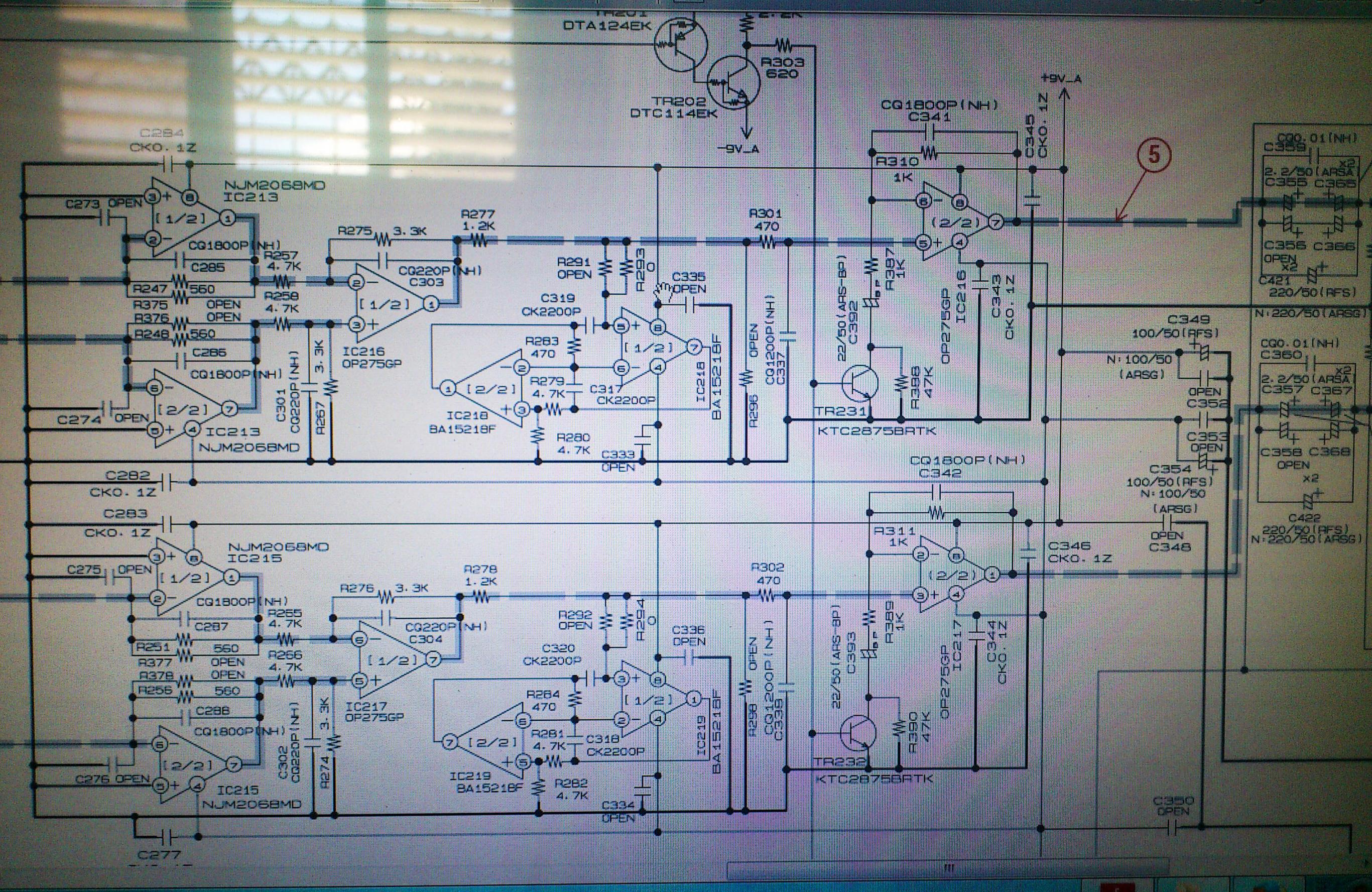

I now only remains to decide which OP AMP to place
BA15218
(This audio circuit diagram of 3910)

Thats similar in concept but with very different values. Gain of that stage is 2 and the feedback return is DC coupled.
For the unit you are working on you need to measure the base/emitter voltage across the corresponding points where the transistor was fitted (and that you have now removed). If there is B-E voltage present in playback then it means the transistor was on (conducting) and so should be in place (or a link fitted)... ut then you loose the function of what happens when its supposed to be off. Its there for a reason and whether you remove it or short it out means you loose that function.

Hello
Today i make the order to all the other parts of the finsh project
Its left only one thing to decide
After I changed in the circuit of 2900 The OP AMP
(I/V) NJM2068 to LM4562
(buffer) OP275 to
AD826

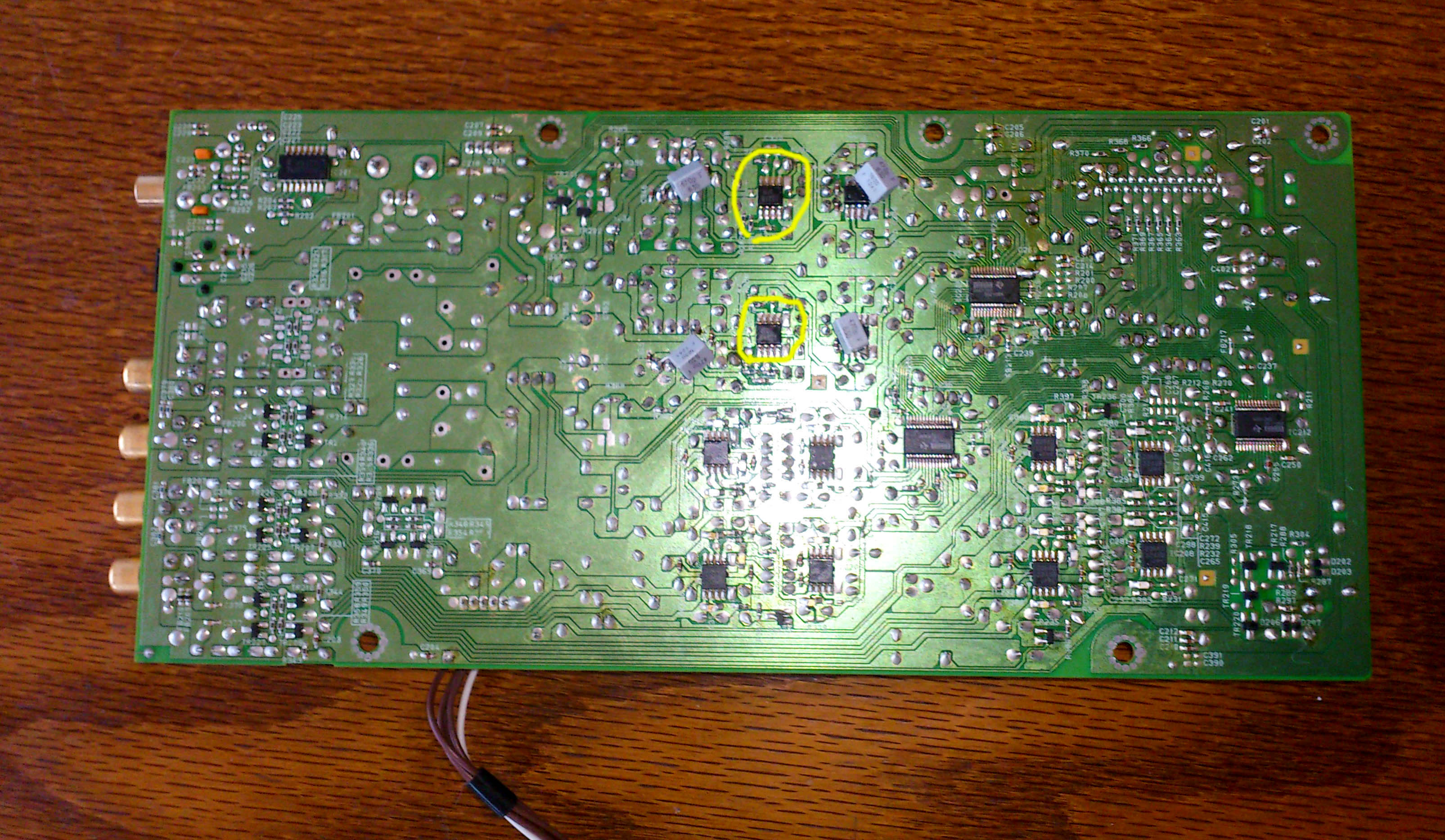

Is left to replaced the filter OP AMP's - BA15218F
IC218
IC219
Like all good battle
There are two candidates in the arena ;)
OPA1662 VS LM6172

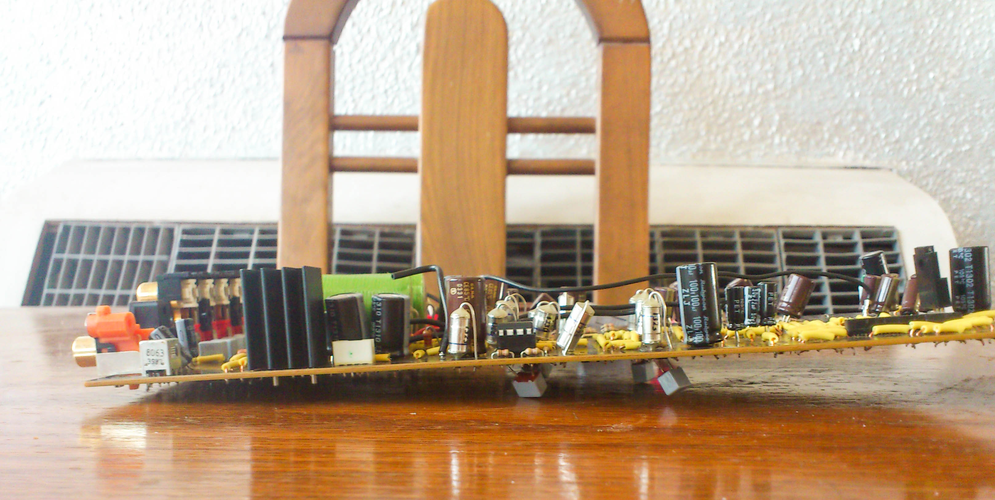

Thanks I'll buy it
And I'll see how it affects the circuit ;)
I have some tests done
when All the parts arrive.
