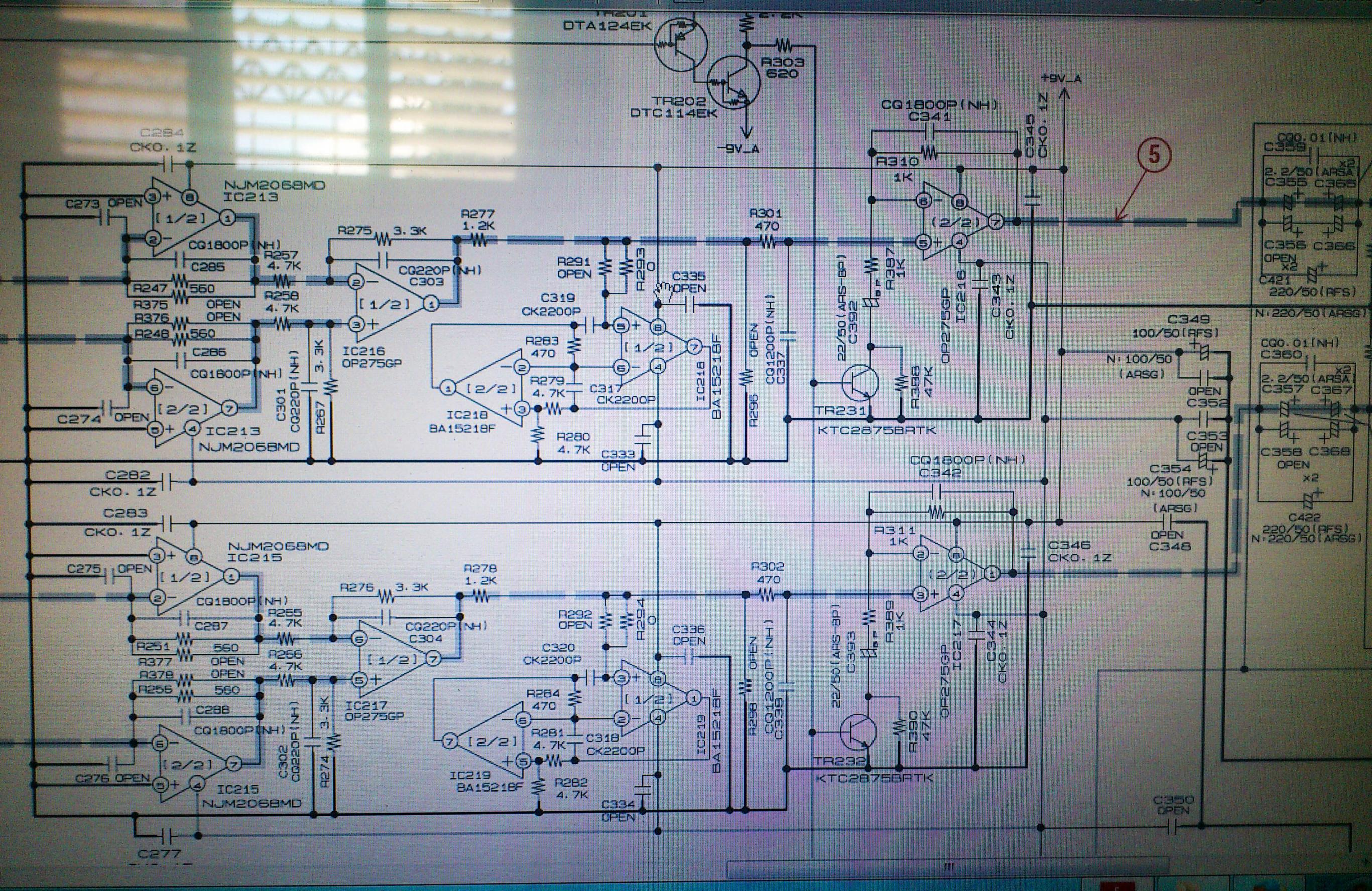

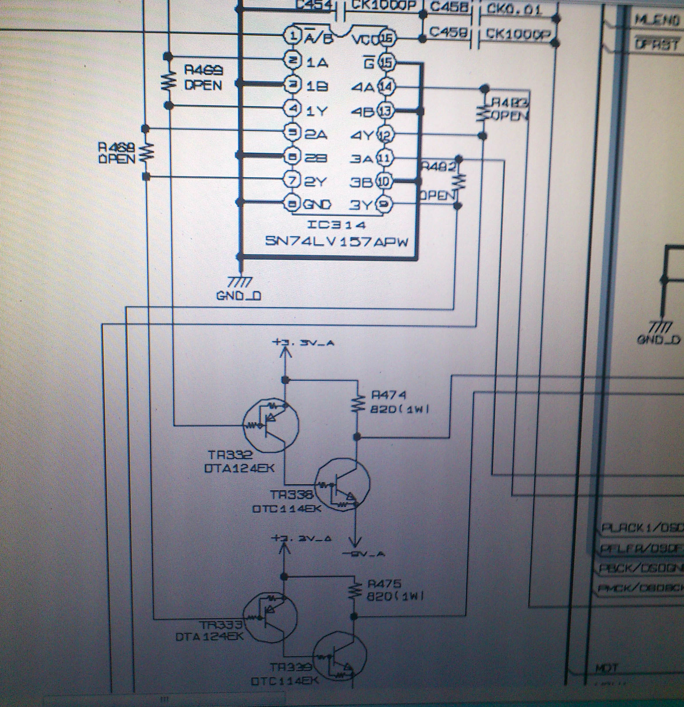

I wouldn't like to say with regard to just copying another player and without seeing all the component values etc. All the little details come together.
This player is obviously designed (and the gain and response of the stages calculated and correctly configured) to work correctly. If that transistor is normally off under all the conditions that you use the player in then you can remove the transistor.
That has to be the first thing to measure before you alter anything. See if the transistor would conduct under your normal usage. If you remove the transistor then there is a slight influence of that 1800pf cap in combination with the 1k +22uf +47k series chain. The effect is extremely small (negligable probably).
If the transistor conducts under any of your usage conditions such as DVD playback, CD playback etc then you should refit them.

The 2900 works perfectly finished mod yesterday as well as I changed the OP AMP NJM2068 - I / V
to LM4562
I now only remains to decide which OP AMP to place

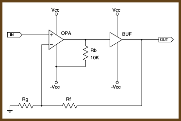

Thats similar in concept but with very different values. Gain of that stage is 2 and the feedback return is DC coupled.
For the unit you are working on you need to measure the base/emitter voltage across the corresponding points where the transistor was fitted (and that you have now removed). If there is B-E voltage present in playback then it means the transistor was on (conducting) and so should be in place (or a link fitted)... ut then you loose the function of what happens when its supposed to be off. Its there for a reason and whether you remove it or short it out means you loose that function.

The decision to remove this transistor made
After reading a lot of people did on the 2900 Mod.
So after removing it sounds A lot better

Now I installed the audio circuit on I / V amplifier LM4562
And buffer AD826
To what OP AMP would you recommend switching from BA15218
The 4562 is as good as anything for most situations. When swapping opamps you need to be aware of stability problems that might arise although there shouldn't be any problems with this. Not sure if you've seen this or not,

After I changed in the circuit of 2900 The OP AMP
(I/V) NJM2068 to LM4562
(buffer) OP275 to AD826
Is left to replaced the filter OP AMP's - BA15218F
IC218
IC219
Like all good battle
There are two candidates in the arena
OPA1662 VS LM6172

moolyImpossible to say without seeing how they behave and hearing them
I need your professional experience
Is the OP AMP
OPA1662
Can be used in a filter stage ( ic218.ic219 )
I have to decide today whether to order it
Thanks I'll buy it
