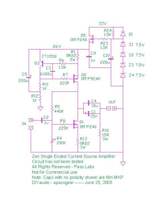

Apassgear, thanks a lot for elaborating on R1. I will have to meditate a bit on your suggestions and try to incorporate your thoughts in the .sch this monday! I am quite dissappointed about myself, not sending the file home. I doubt I will have time to draw it all again this weekend. I would love to post a nice schematic of this amp though Might be usefull for some people, I hope

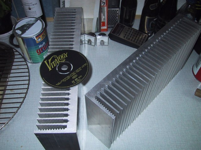

My Zen is built with the original Pass Labs boards Yours look pretty good to me, but if the heatsinks arent up to the job.... too bad. I intend to make a hole new chassis with these heatsinks, I think they will do allright 8,7 kilo's a piece What do you think?

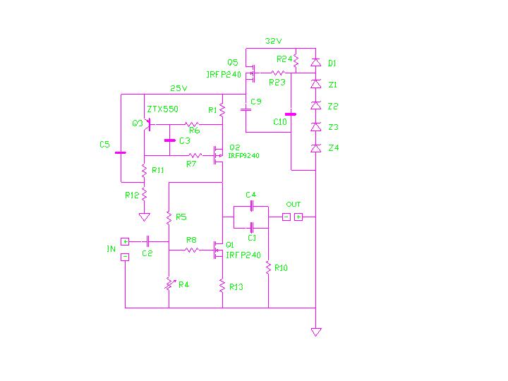

Vix said:Schematic seems fine, except one thing: R1. I would connect it directly to the Gate, as close as possible.
I have written before about my concern for the imput impedance. As I understood, we can put , say, a 22 KOhm resistor in front of C1 and then this circuit would have 22 K input impedance?
the 221 in series with the Zener makes it OK as you see it -
sometimes with the Zener directly at the gate you see some
parasitic oscillation, and placing some resistance in series
with the Zener takes care of that.
As to input impedance, it will be the Gate resistor to ground
in parallel with the 440K (dc feedback) divided by the gain,
and of course the capacitance of the Mosfet which 1,000 pf
or more. The less voltage gain, the less D-G capacitance.
Thanks, Nelson So the zener arrangement is ok. I just took R1 and put in place, where it sits in the ZenV1!

and so on I guess this means I can let R1 sit where it does for now? Hope I am not being rude, asking that question?As to input impedance, it will be the Gate resistor to ground

steenoe said:My Zen is built with the original Pass Labs boards Yours look pretty good to me, but if the heatsinks arent up to the job.... too bad. I intend to make a hole new chassis with these heatsinks, I think they will do allright 8,7 kilo's a piece What do you think?
With those sinks you can make 4 channels
Lucky you!!!
Yep, I do feel a bit lucky, with those heatsinks Guess what, I had them for soldering a preamp for a friend of mine. An OPA627/buf634 on PMA's boardsLucky you!!!
Piece of cake If I could just do more business like that
The sinks measure like this: 400x200x85mm's! Quite heavy stuff

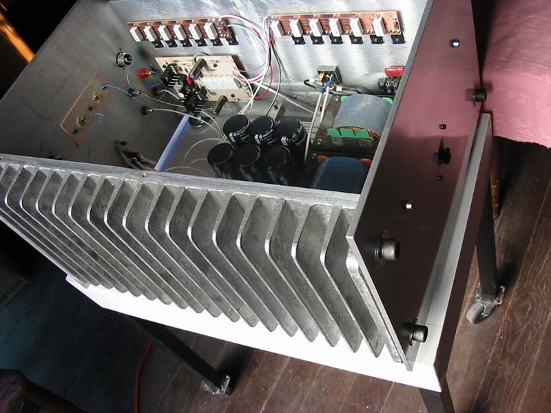

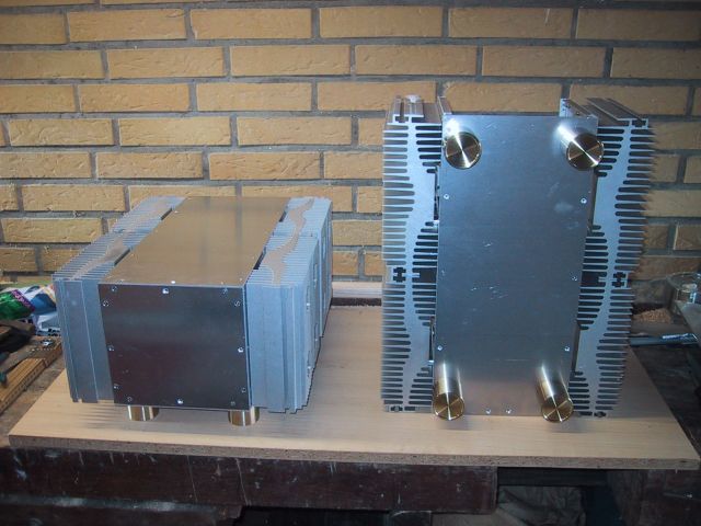

The body is 15mm's. Still they cant compare to the sinks I am using for my A-X. I am building monoblocks, 100 watt's. Have a peek at my not finished chassis's. I did manage to get 12mm faceplates for them. Thank's Magura What do you think of those then Well, a bit brawling, I guess

Those sinks look heavy, indeed What are those source resistors?? Seemingly, I am on an eternal search for suitable source resistors!These are bigger than those...

As Magura points out quite strongly, the fins have to sit on both sides of the body plate That will give you the most efficient heat transferring. Guess he's right about thatThese are bigger than those...
Source resistors are regular sand whiteis wire wound, nothing special.
The sinks were specialy casted for the Aleph4's. Never weight them but asume maybe more than 10 Kg each.
they mesure 260x560x70mm.
Magura is right, that's the best configuration but dificult to get on the size of interest unless you machine them, as magura does. But $$$$$...
Magura is right, that's the best configuration but dificult to get on the size of interest unless you machine them, as magura does. But $$$$$... [/B]
I just wonder if it is actually cheaper to water cool the amp. All the water cooling stuffs are pretty cheap on Ebay.
Nope, they are not machined! The ones, Magura use for his ZenV7, are machined, allright But only to fit his circular chassis I guess you need to have a Danish passport to get some of those sinks though Luckily enough, I doMagura is right, that's the best configuration but dificult to get on the size of interest unless you machine them, as magura does. But $$$$$...
