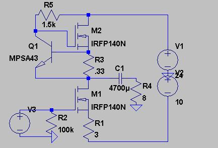

i was toying round the idea of a negative rail. i`m a newbie to mosfets and i`d love to learn more.
i was played around and this is what i came up with. its very crude and isn`t really stable. can anyone help me make the circuit work? whats wrong with it? i know i`m getting too much local feedback and thus the gain is rather low, is there anyway to solve this?
GRollins said:The Aleph current source counts as feedback since it derives a signal from the outputGrey

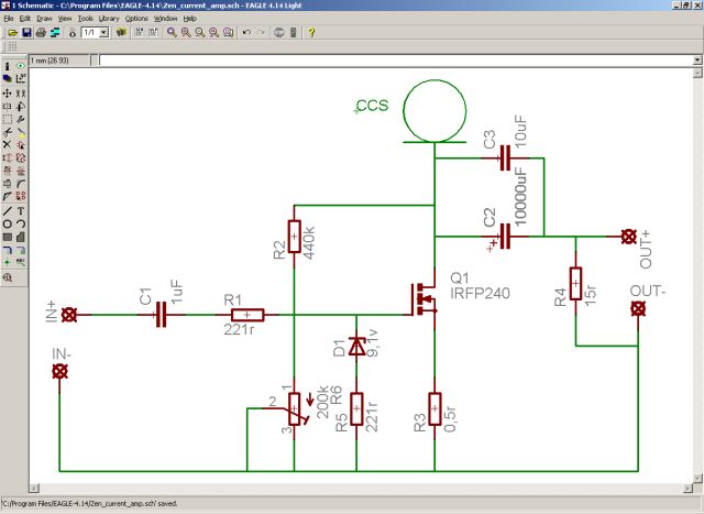

steenoe said:I tried to collect the "breadcrumbs" and ended up with this result.
Is this schematic "pass"able, as a single-ended, non feedback, current source Zen amplifier? Any suggestions?
Steen.
Traditionally Zen has not use the zener protection so you can do without it to keep the spirit. Though it’s a good idea to protect the gate.
As I remember NP does not use any resistor when using zeners as protection. If you use the zener remember that R1 should stand between the zener and the gate.

So you mean R1 should sit right after IN+, also maybe a higher value? I will drive this amp off from the BosoZ, so the low input impedance might be ok? I thought of 600ohm as NP said earlier on this thread.Schematic seems fine, except one thing: R1. I would connect it directly to the Gate, as close as possible. Everything else would be connected after this resistor. This is my opinion, of course Nelson may have to "approve" it

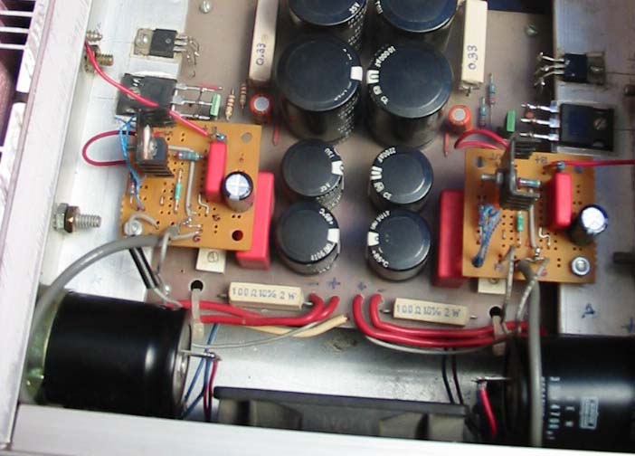

I have the original Zen amp, and will modify it to preferably something close to the F2 I will use the P channel CCS. Maybe I will use the regulator too. I have used that reg. on several amps with good effect.CCS will be as the original Zen and will have a regulator as shown on page 2 of Zen Variations part 3 (the simple one, not the Aleph sliding CCS or sliding regulator).
I believe to remember NP said he would never let a zener see the outside world, thats why I put the R in front of it. Parasitic oscillations might occurAs I remember NP does not use any resistor when using zeners as protection

I think Vix tryed to explain the same that I did regarding R1. The resistor should be as close as posible to the gate as the last element before signal enters the trany. This way the zener does not look directly to the gate. Yes I also remember NP saying that zeners should no look directly to the outside world. R5 could be at the top also hiding still more the zener. Anyway I dont think it will make much difference as long as R1 is on said position. Regarding value for R1 I would stick with what Nelson uses, 220R.

I was thinking on the same line as you, updating my old original Zen and thats the way I started thinking to build this "F2" Clone. but after my initial intentions found out that the box for this is way to small for the components I have in mind. So I will mock up to test over a playwood and if all goes well I'll do a proper box.
My original Zen which I added a front end a la Z4...
