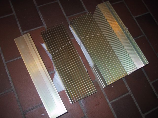

I was concerned about the vertical fins, but wanted to try them for the cosmetic impression. They do get hot, but so did every Zen I made, even the Zen8-9 mix with the big big heatsinksAnd those heatsinks look swell. Are they getting hot?
was getting really warm after a couple hours. This new ZenV9 is thermally stable, but I wouldnt like to use smaller heatsinks.
BTW, I was lucky to get those heatsink at work. They were sitting in a powersupply for some welding gear, that was thrown out.
I have 4 more, a little smaller, that would be perfect for a pair of Aleph-J monoblocks You know, Choky's Babbelfish

Thanks Richard. No, unfortunately I dont have the rating. I wouldnt use anything smaller than those on the pics, as they do get hot. After the above posts on the subject, I set out to monitor the temperature on the sinks. After more than 3 hours being turned on, the temp had settled around 63,5 deg C. Measured right above the cascode fet, so I guess this is the hottest point. Thats a bit too much for my liking. I am considering to modify the chassis at this point. If the sinks with horisontal fins (not vertical as I said above) are cut in half and each half turned 90 deg. they would be able to dissipate more heat. So there goes the F-amp look I wanted But what, better safe than cookingDo you know the rating for power dissapation for the heat sinks you used?

I have connected the fets through leads and placed them evenly on the heatsinks. That helped a lot. I have to admit that the boards of PD and Veteran invites you to place the fets close to the topend of the heatsink. In this case it was a nono!!! Placing the fets at around the middle line of the sinks did the trick Aftermathing on that: its pretty obvious isnt it?

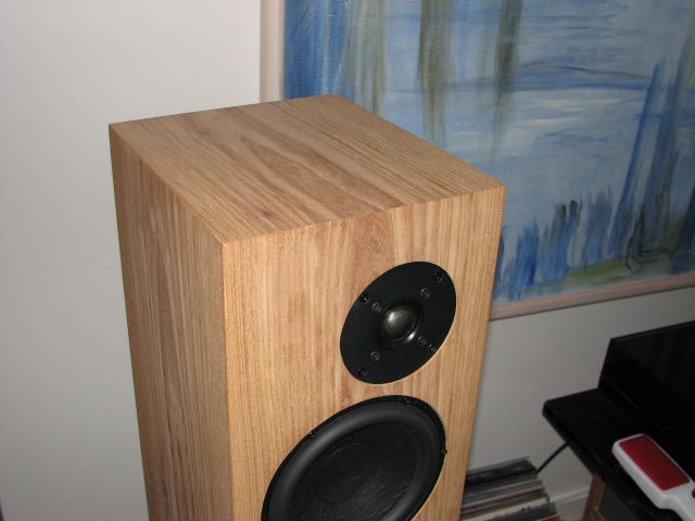

Yes, its a pair of selfmade Proac Response clones. I veneered them with Elm tree.Are your speakers home made ?
Steen
jleaman said:Are your speakers home made ?
Nice work.
If they were mine, I would prefer they were called custom built or made.

Well they look REALLY good. I like them. I hope that i can get my speakers that im building done some day.
Thanks J' I am sure you will finish them someday. As always when building something, you want to finish tomorrow But it rarely goes that way, does it! With a little patience, you can achieve your goal. Here is another piccie of the speaker, as you can see the veneering sheets were selected so that the front veneer fibre markings, continued on the topWell they look REALLY good. I like them. I hope that i can get my speakers that im building done some day.
