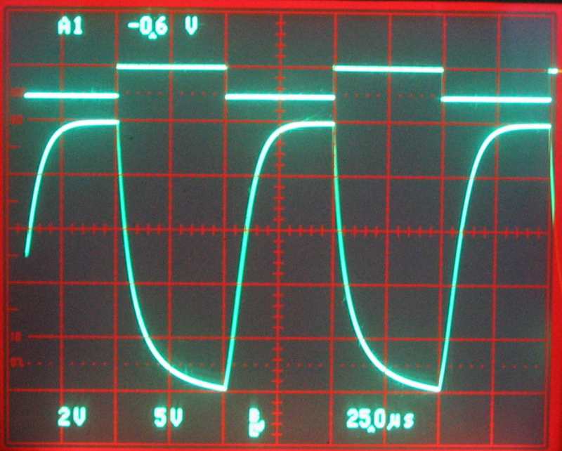

hi guys,
at first: The sound is still terrible
And after several checks i mention to say that the amp seems to work correct. I´ve done some additional measurements with 150mA bias current and a 75Ohm load at 24V supply.
Please have a look at them and give me your comments.
I know that squarewaves are a hard food for an amp, but the sinwave (one chanel inverted) is also not really symmetrical from input to output. May be I have to widen the bandwidth (or to give up this project)?
greetings from despaired Bernd

Bernd,
I've seen your screenshots, and they look right to me.
The 10KHz square wave behaviour is due to the limited bandpass of this circuit, in my unit the square wave, even if asymmetrical, is a bit "faster".
Anyway, I dan't think that this could lead to a "terrible" sound.
Check your components' quality (surplus caps?!). Or more simple, this could not be "your" sound, but believe me, this circuit topology hardly leads to such an "hard" sound...
Marcello
Post Scriptum: the output load is made by a 33R non-inductive resistor
