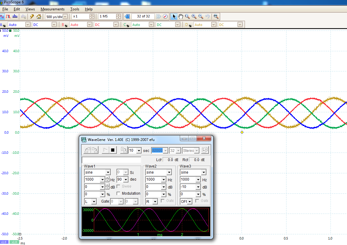

DAC looks OK. This is the output of the DAC in 1 ohm resistor with nothing attached.
