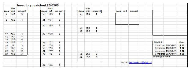

A dual mono BufIII will output 16mA per Iout. Your bias will need to be around 64mA allowing for only 25% swing. I see in the DIYAudio store a "D" grade LSK170/LSJ74 can be as high as 30mA Idss so you could try a matched pair k170/j74 per channel for CEN (can the XEN sinks work for this?) or more reasonably find a quad of 16mA Idss for which you can then use the boards as is, if available. The Riv will probably need to be lowered (perhaps 100Ω), but you will have the benefit of an even lower Zout.

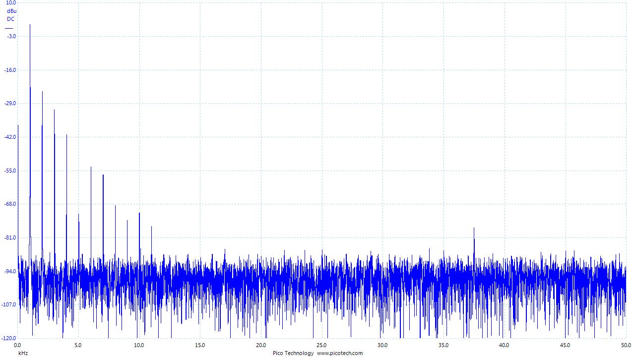

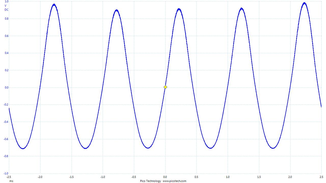

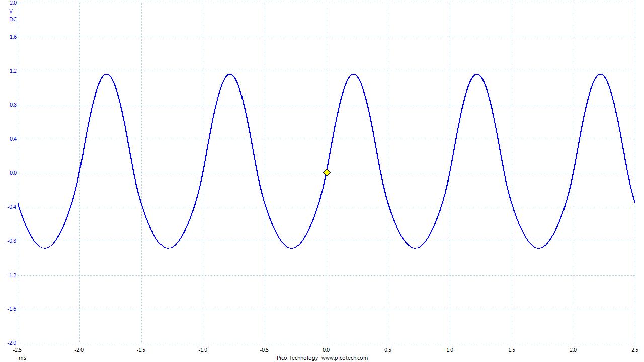

There must be something I am doing wrong: I have a sen for the ESS9018. The sen has 4 2sk369 and drains 44mA. Riv is 400 ohm. I get 0.6V signal with 3% distortion. The sen is fed with 16.2 V batteries. Vref is around 1.6V.
Any hint ?

Did you scope it?
Gate stoppers?
Cap over I/V resistor?
