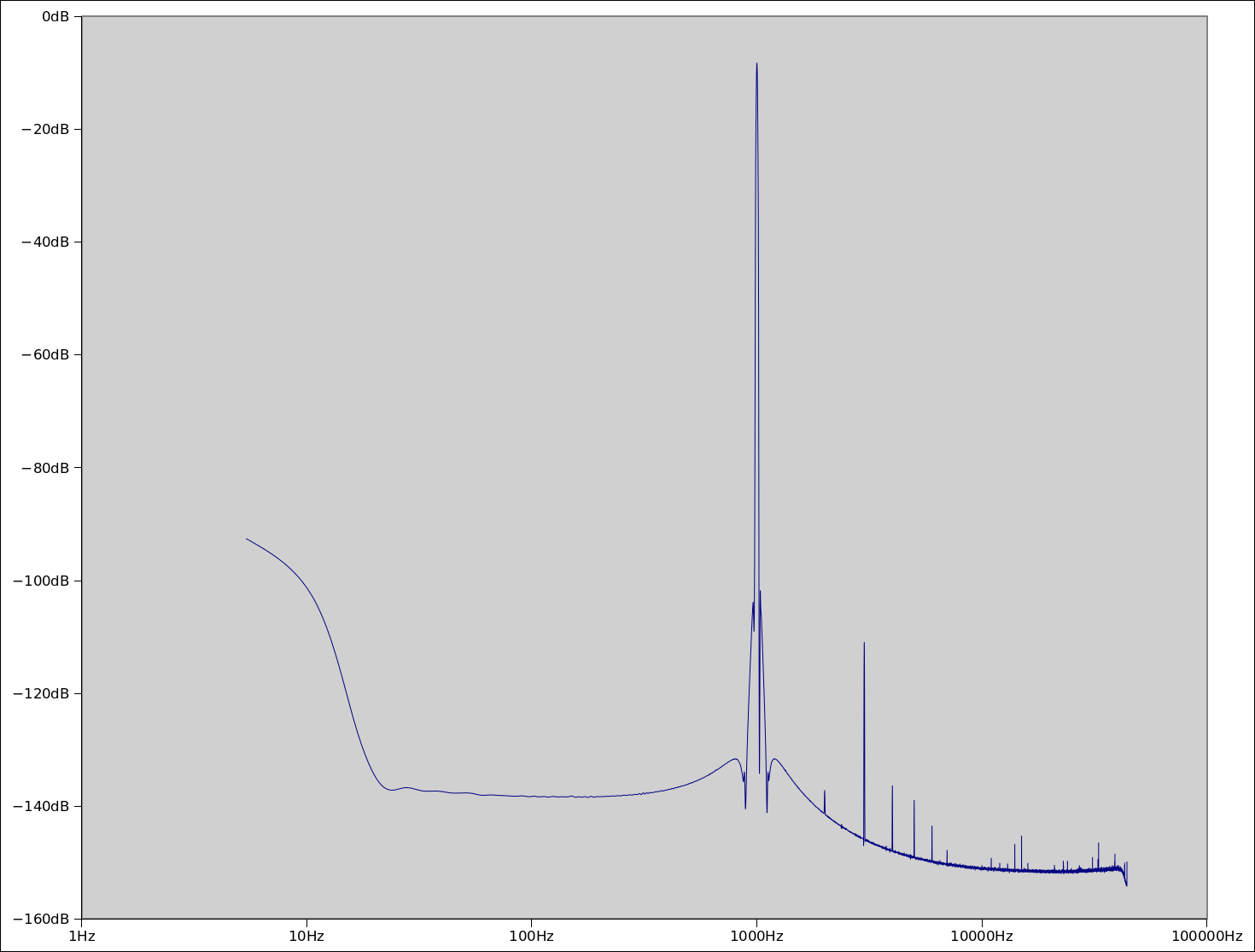

PCM1794A
This is where I ended up with my Sen variant #998 (with 0R for RM) for PCM1794A described above:
Analyzing "mysensample.flac"...
Frequency: 999.977933 Hz
THD+N: 0.0009% or -101.3 dB
This THD+N is 20-700Hz+1300Hz-44.1kHz with 88.2kHz sample rate.
You can see from the spectrum that THD+N is mostly 3rd harmonic distortion at about -101dB, I'm guessing from the gate capacitance of the pair of JFETs which set the ground reference for the other JFETs in my circuit.
I'd be interested in seeing a measurement of your PCM1794 Sen version with the 2SK369V. Have you got any results from that yet? How does the sound compare to the other ones you have built?

Subjectively AD1865 sounds much better.
Stunning was the word used for the AD1865.
But the front end is different (CS8416 SPDIF for 1794 vs Ultimate Source 2 for 1865).
So it is probably not a fair comparison.
At least we know it works for AD1865, PCM1704, ES9018, PCM1794, ....
And we might try AD1955 some time, but very low priority....
Patrick
