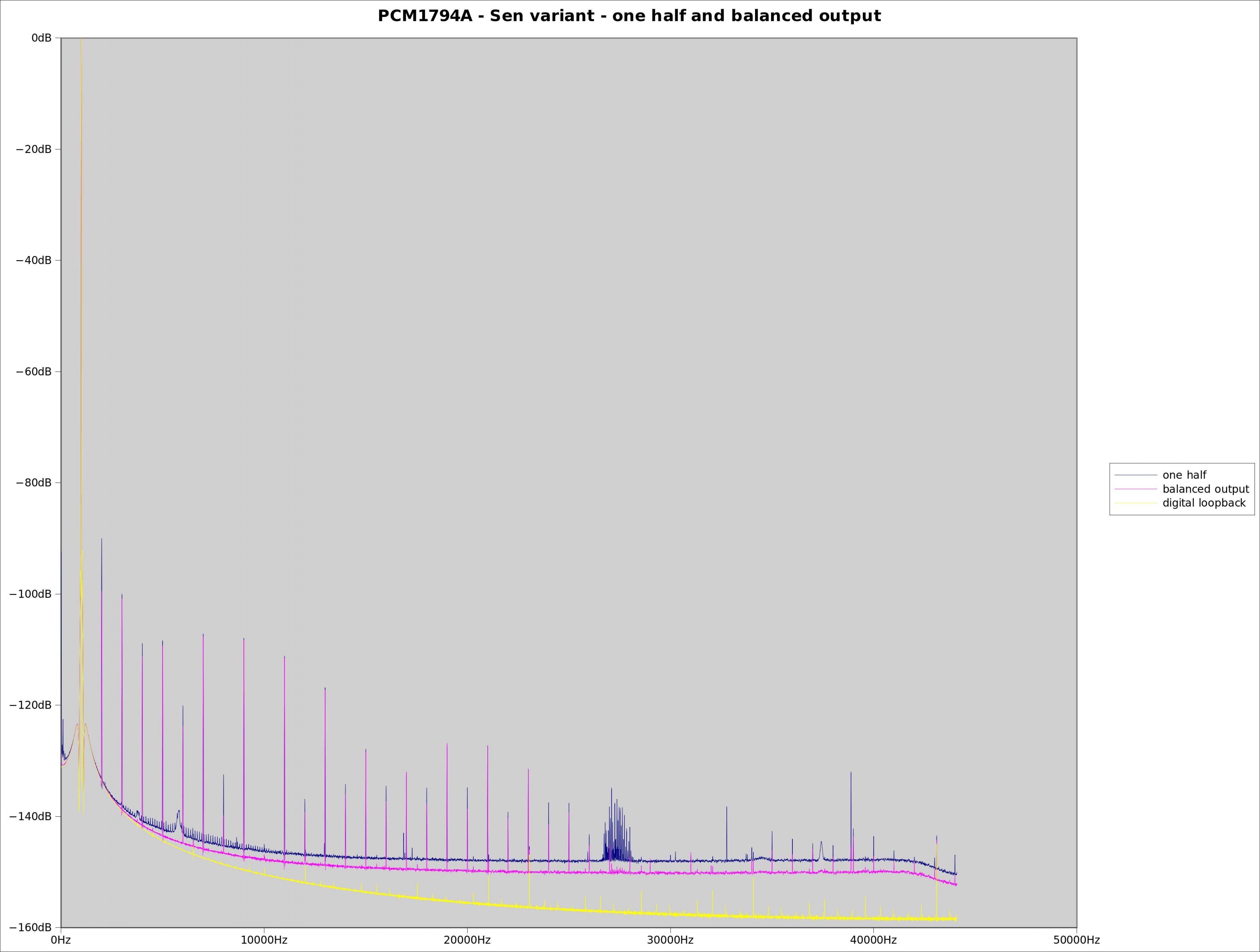

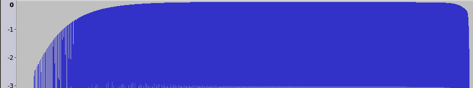

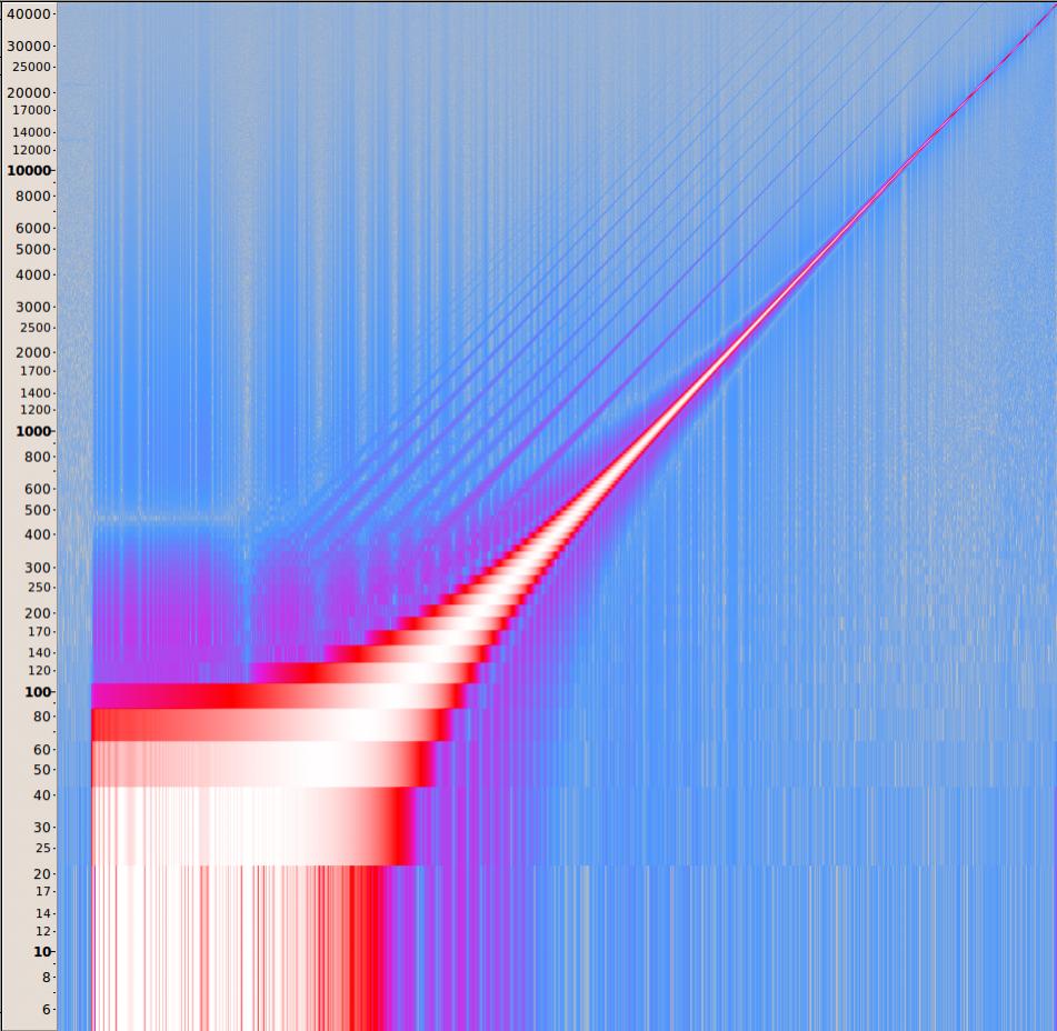

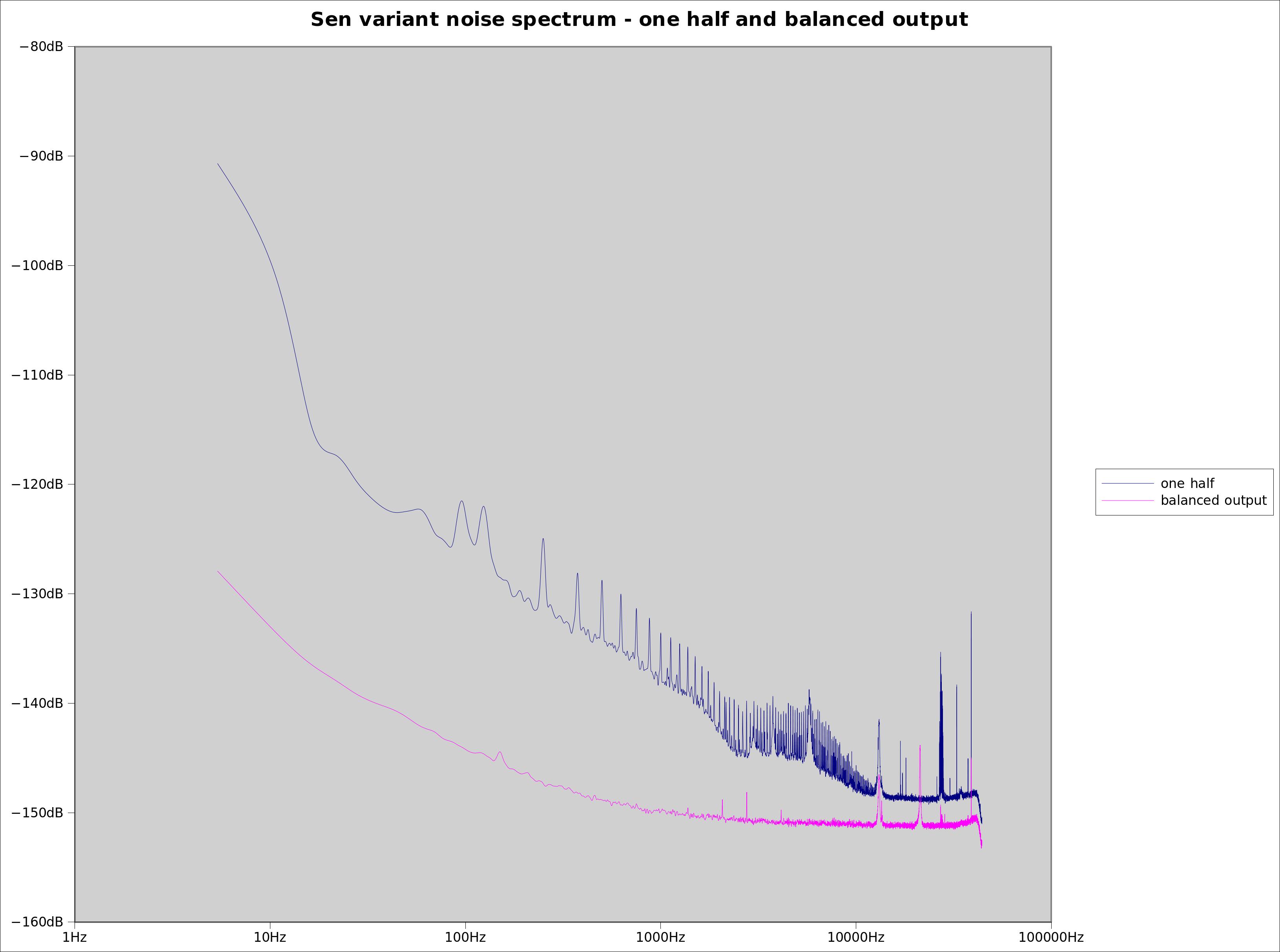

Finished?
I think I might finally be done.
I have built a version of the last Sen variant I posted with RM=2.2MEG (the largest resistors I have) and Riv=910R using the most recent servo I posted with one extra decoupling capacitor on each servo and 3 150pF Civs per balanced channel. I used 6 pairs of JFETS per balanced half plus the extra pair of drivers to drive the gates to avoid the distortion increasing with frequency.
The last Sen variant I posted has much wider bandwidth than Sen owing to the extra pair of driver jfets and needs at least 1 Civ per balanced pair to reduce the bandwidth and eliminate radio frequency noise.
Initial listening test is very promising - retaining the clarity of my first successful Sen variant and a little less liquid at the high end - maybe a bit subtler.
Here are the measured results including comparisons between one half and balanced output which someone requested:
Analyzing "sen-variant-final.flac"...
Frequency: 999.927046 Hz
THD+N: 0.0019% or -94.5 dB
Big thanks to Patrick for posting this thread.

My solution is just to put it in an enclosure. I get the results I posted in #1069 which I think are good enough and the original Sen is better for noise than my variant so you should expect better.
I can get better results than those of #1069 if I reduce RM - noise goes down and distortion goes up a little.
