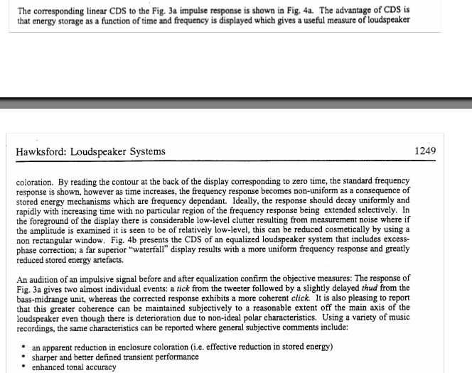

Here is another paper about digital equalisation and a passage about reduction of energy storage.
http://www.essex.ac.uk/csee/research/audio_lab/malcolmspubdocs/C72 Active loudspeakers.pdf

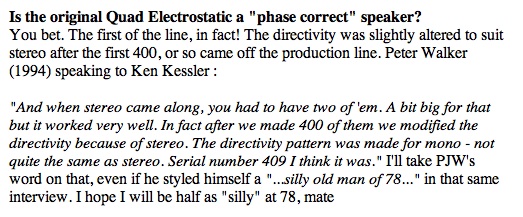

After all this discussion about dispersion and diffraction here is what Peter Walker had to say. He calls the radiation pattern of a loudspeaker "directivity". It is also a parameter defined for speakers that are used in German Radio Stations or for TV broadcast. I think there is also a "Directivity Index". How that index should be is an ages old problem. Peter Walker talked about that somewhere else but i can not find the original material at the moment. As far as i know he optimised the directivity of his speakers by listening tests, based on measurements of cause and came to the conclusion that it had to be optimsed by ear.
