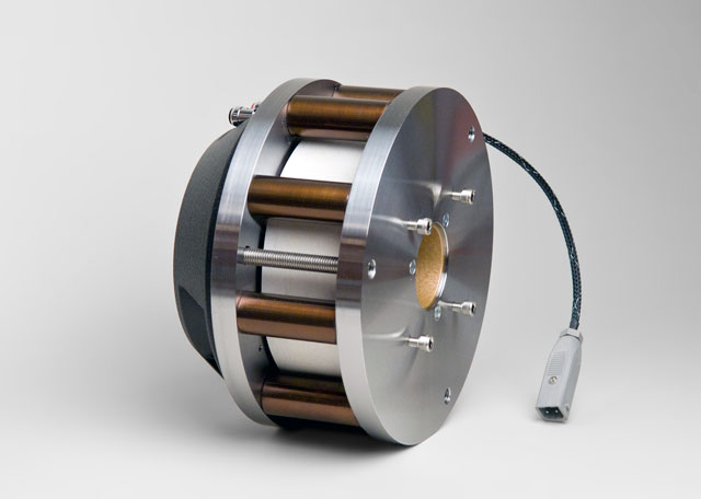

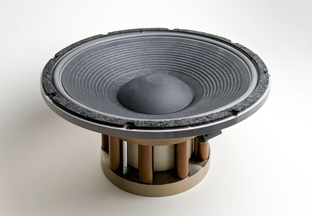

Yes. And buy the right kind of these woofers and you get a very linear magnet system thrown into the deal and a copper or aluminum cap on the center piece that kills Le dead and so kills Le modulation (you cannot modulate what is not there)...
JBL makes a few good ones like that (and has for decades), not necessarily the super flattest response, but usable. I still remember the custom JBL Systems we used to install in the occasional club (most took the cheaper Ramsa stuff), set right these made awesome High Fi...

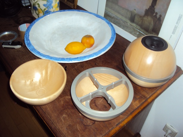

This project was delayed much. One reason was that i set up my new company Neue Seite 1 and the other reason was, that i was not 100% happy with the sound of the nylon spheres. By chance Jan Didden offered me a pair of reworked IKEA bowls that are ideal for the purpose. They have metal stabilizing rings designed by EUVL.
