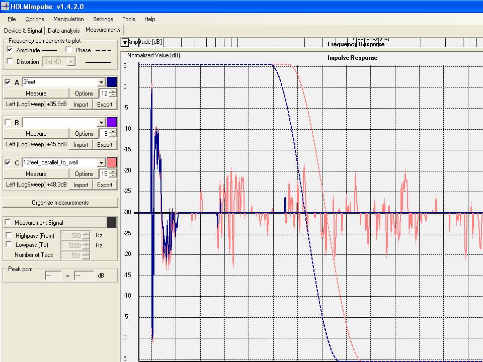

As for locating the speakers in space, it's fairly widely acknowledged that later reflections have more impact than early. And as Joachim hinted earlier, listening distance has a huge impact. The attached plot positions a 1 meter measurement against a 4 meter measurement in the same room where the longer distance was measured fairly close to a side wall. Clearly, the ratio of direct to reflected energy is vastly different at 3ms on out. These are the cues that are telling us where the speakers are in the listening space. In contrast, the sub millisecond timing and amplitude differences are the ones telling us for example that the bass player is positioned a few feet to the right of the drummer. Apples and pomegranates.
