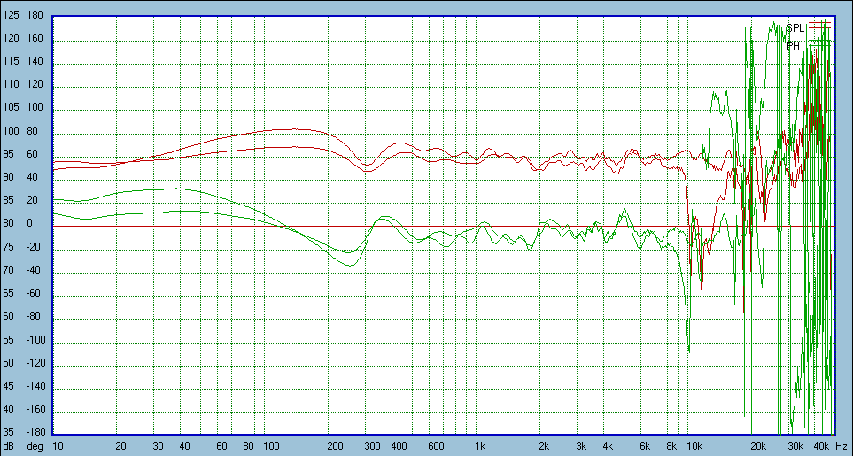

I did a quick and dirty EQ on axis,
Results measured at 0 deg and 30 deg

The point Earl is making can be seen by example. On axis suppose you have a 3dB dip in the response at some frequency because of cancelation between the direct and cabinet edge diffracted sound. Off axis you might have a peak at the same frequency becaus eof the difference in the phase relationship. If you flatten the on axis dip, the off axis peak can get worse.
Most acoustical problems differ at various angular points, while virtually all mechanical and electrical resonances do not. The later is correctable with EQ, but the former is not. In Georges case it sounds like the mechanical problems dominate. This is why I like polar maps because these things are so clearly easy to see (but ONLY IF you DO NOT normalize them). The correctable problems are vertical ridges (which disappear if normalized just as EQ would do) while the uncorrectable problems are arcs.

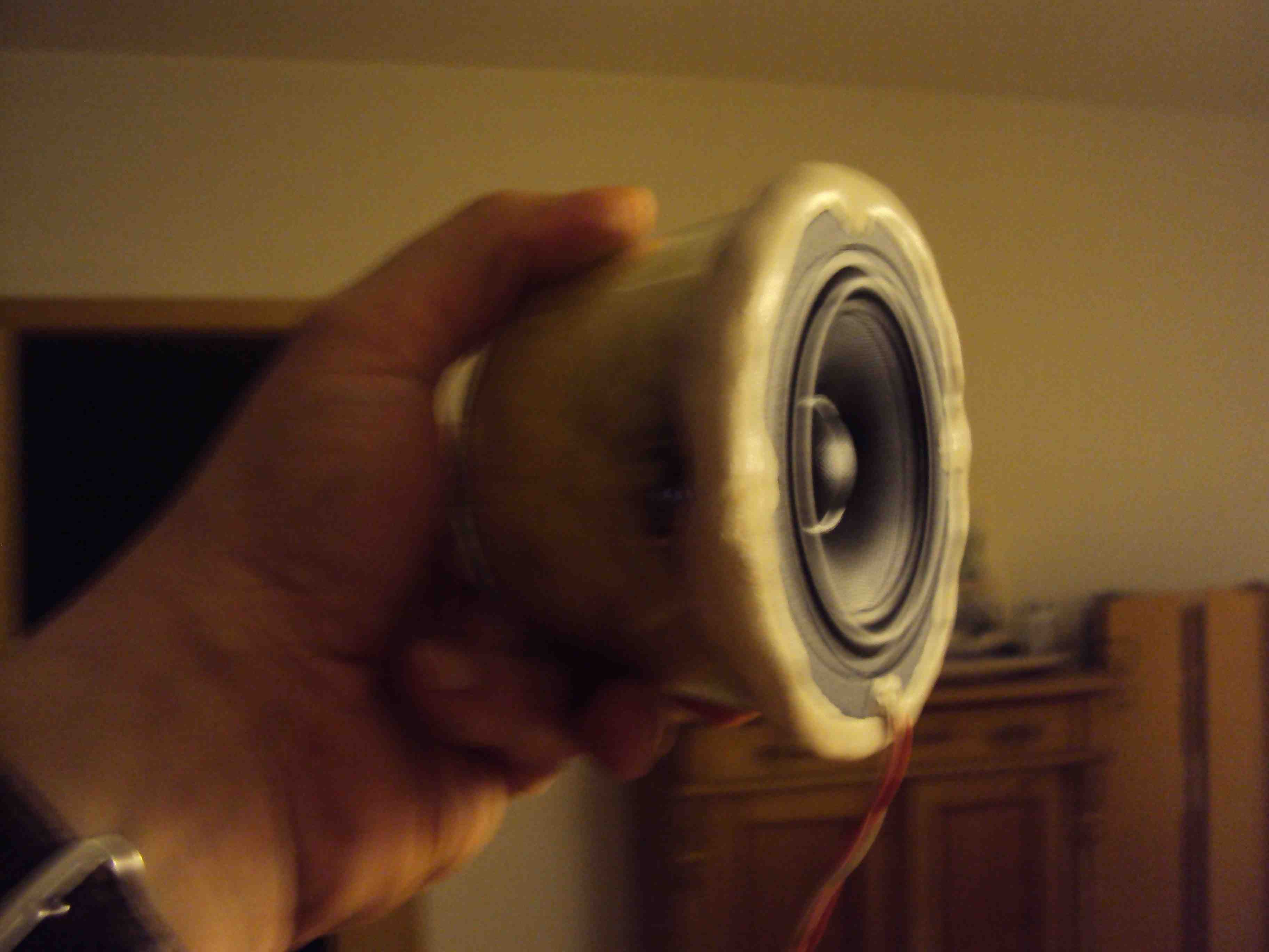

fntn, now me being a half satisfied member of the linearity camp i must disappoint you again. I have put the idea aside to put the Scan wideband in a transmission line tube for now. I have your tapered tube idea firmly in my mind as an alternative and i will leave the linearity crowd as soon as convincing prove comes about that an unpredictable unlinearity effect exists that is audible.
What i found is that the Scan does not neead a big volume to work satisfactory down to 250Hz with resonable sensitivity. I simply put it in a small glas bowl and made a first attempt at a crossover. I think an LR4 is posible at 250Hz and a first order crossover is posible at 2.5kHz.

Michal, i build my first Isobaric in 1980. I know about the problem that the volume between the drivers create. That is the reason i plan to fill the volume between the drivers with a solid material. Crossover will be at around 250Hz. In case of an LR4, amplitude will be down 6 dB already at this point. I do not claim that all problems are circumvented that way but i try to mimise the deficiencies.
