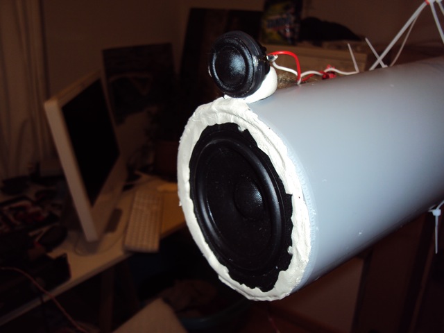

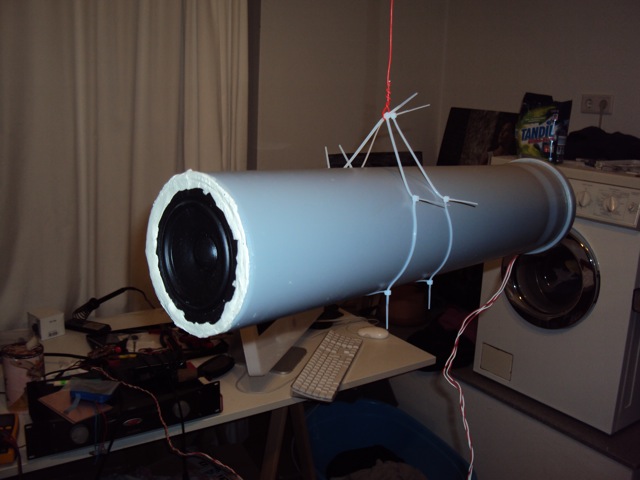

Here is a picture of the Scan wideband in the PVC tube and the OX tweeter on top.
