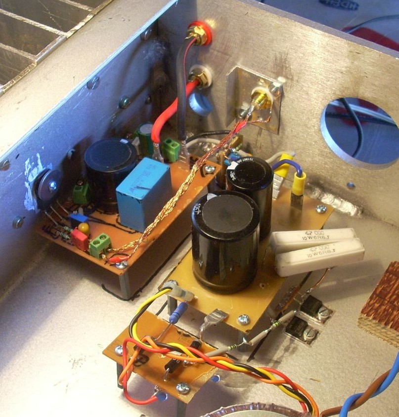

Here are pictures when it was clean:
Note "charge-transfer supply" only needs a few Schottky (or plain) diodes and a Mosfet, plus a a few resistors. To the right is the little PowerReg. This one has Siemens polyprop cap at output (//electro) but the other has now Russian NOS PETP, which is clearly better. I just had no time to upgrade. Since I have lots of them, I will probably exaggerate.
Can you see where the speaker cables are going?

Can you publish your version of the build with component values and manufacture e.g. Wima 0.1uf poly? And PS too.
Have you thought about the MCA? You could be the very first person to ever build one.
I remember I strictly adhered to your schematic. Yes, input cap is Wima 0.47uF.

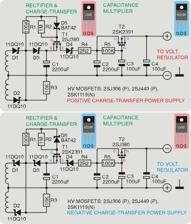

This is "charge transfer supply":
One can choose high power mosfet and diodes.
