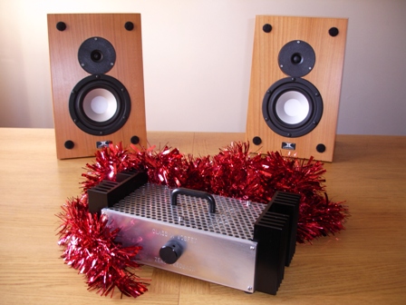

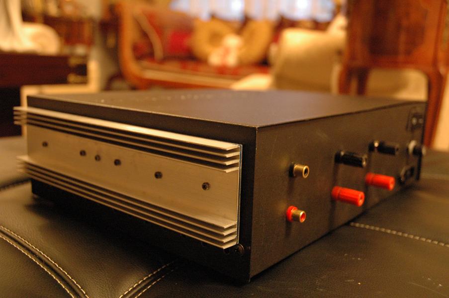

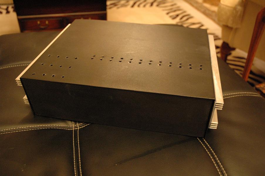

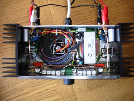

small but musical...
My lil ZCA amp playing music passionately. Does cough with my 94dB 4Ohm speakers at louder volumes, but great for late night listening. Super deep bass is present but offers less control compared to my other amps (P3A and Aussie Amps nxv200). Midrange is special for vocals and piano.
The ZCA is a rare beast. Yes all 5W of it. I’m yet to hear from anyone who has built one (to the ZCA formula) and are not extreme pleased with the result. Please let us know how it goes.Mark,

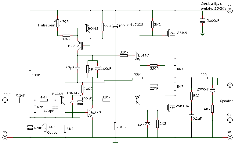

Just an update to this thread (which I only stumbled across) try reducing the input cap to something like 0.1uf. Use a quality metal film of course. I developed the next ZCA called the MCA - Minimal component amp. I wanted to use a bipolar as the power device and get away from FETs.
What I tried and luckily worked was using a jFet, 2SK170, driving a 2N3055 in a darlington pair configuration. The PS and bias setup is exactly same so you could even build the ZCA and MCA in the one case and have switch to chose which amp you want play.
What I did discover when prototyping the MCA is that the input cap only needs to be 0.1uf. When made bigger the square wave at 1KhZ rounded heavily on the leading edge. No one has built a stereo MCA as of yet. If anyone is interested I will post the schematic. You could be the very first to build a MCA. Under the CRO the MCA way outperformed the ZCA and sounded punchy. It did only produce a watt or so, so bare that in mind.
I hope to go back to the MCA because I think I may be able to get about 2W from it.

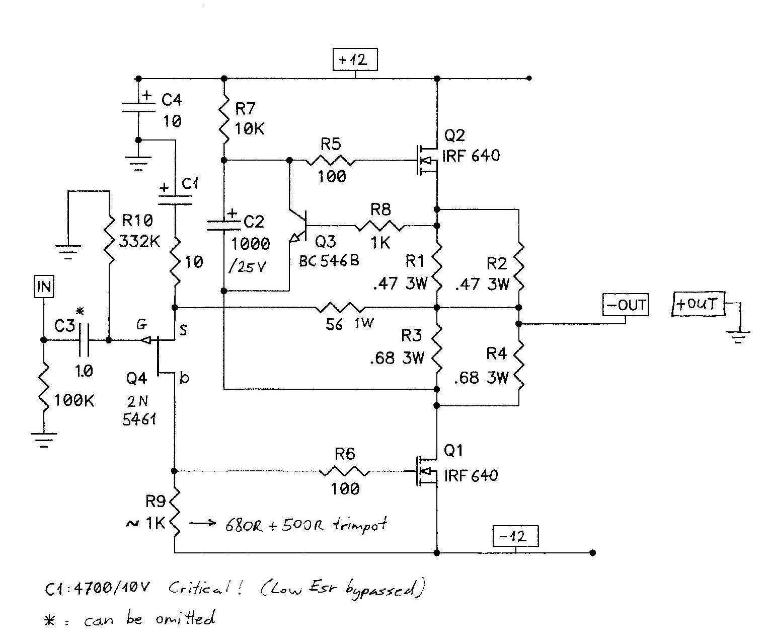

If you like SE class A with super sound quality, give this one a try..... It is NOT my design, it's a modification of the Nelson Pass Amp Camp Amp. I changed the input Jfet to P-cannel, so it can be fed with symmetrical supply, and entirely DC coupled (well except the low freq. limit introduced by C1). It is dead stable (running without any readjustment for 3 months). Idle current should be set to about 1A with R9, power supplies must be well filtered (now mine is using 2x33.000 uf + a simple darlington based capacitance multiplier). Its output with +/- 12V is around 5 Watts , and let me tell you, this must be cleanest 5Watts I've ever heard..... In the past I tried , (built, listened) at least a dozen similar SE amps, but this one beats them all.
