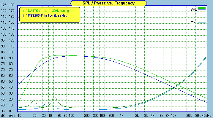

Cambe said:Hello,
I was wondering what would the low end response be like for the intergrated sub version and how it would compare to the vented floorstander version?
Cambe
Here's your answer, attached. Looking at only the simmed response, the vented floorstander has much more output below 100 Hz. Most would call that alignment bass heavy.
The low end response curve is of lesser importance than the following issues: power handling and distortion. On those 2 very important specs, a single RSS265HF is leaps and bounds above a pair of DA175's. In other words, the integrated sub version is best for those who like it clean and loud.
On the other hand, if you don't listen very loud but you like lots of bass, the vented version could be satisfactory. Or you could build one of the other designs out there using 4 of the DA175's for a little more power handling at the expense of a huge enclosure. Ask around on the PE forum about that one for another option.
