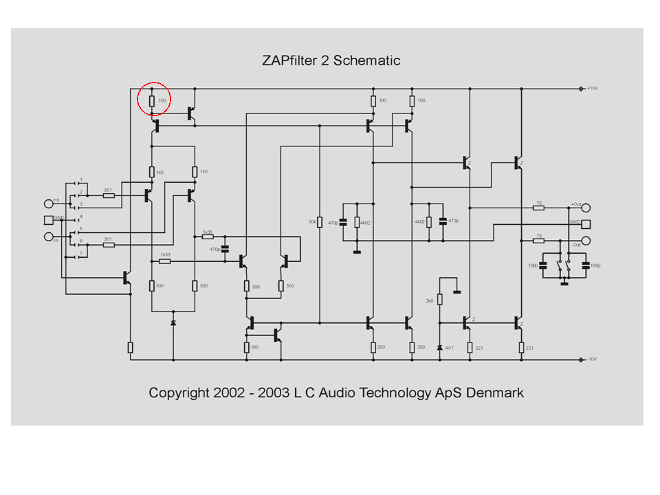

Sorry to revive this old thread, but any update on the problem Sarman or others? The problem is, I have exactly the same issue with DC offset as you . I'm using the Zapfilter in my Sony SCD-XA3000ES player, it uses balanced voltage output DAC, BB's DSD1608. Old analog stage completely disconnected. Since the Zapfilter has gain of 2, I'd only installed a simple 1:1 10K voltage divider between the DAC and Zapfilter inputs as advised by LC Audio. The sound is great, so no problem here.
After powering up both channels stay below 2mV of DC offset, however in a couple of minutes the left channel climbs somewhere to 100mV (changing). Right channel fine (<2mV). When I open the player and let the fresh air get in (the zapfilter+its PSU get really hot in there, I cannot even touch the regulators) the DC offset on the left channel gets down. I even succeeded in getting below the 2mv level. So a problem with temperature instability it seems. Moreover I found that a connected load (amplifier's attenuator) helps the matter, without anything connected to Zapfilters outputs, the DC offset gets to some extreme levels (see included measurements). The DC offset of the DAC is negligible, below 1,6mV.
Zapfilter outputs:
LEFT CHANNEL: +toG -190mV -toG -300mV +to- 94mV
RIGHT CHANNEL: all around 1mV
Zapfilter inputs:
LEFT CHANNEL: +toG 1,292V -toG 1,294V +to- -1,6mV
RIGHT CHANNEL: +toG 1,297V -toG 1,298V +to- -0,7mV

Hi Karlosak,
This e-mail i received in 8th Aug. 2003 was the last communication we had with Lars, unexpectedly it solved the problem exactly. And guess what.. It was his mistake.. Read on..
Dear Mr. Salman
Did you solve this problem to your satisfaction?
We have found a new solution to this problem, that has turned out to be the result of our subcontractor using transistors with a different hfe sorting than we prescribed. This caused the input to be slightly common mode DC sensitive, even if DC should be completely undetectible to the first stage.
It can be solved simply by adjusting the common current mirror 10%, by mounting a 1k0 SMD resistor on top of the existing 100 Ohm resistor in the current mirror. (Not in the signal path).
After this the ZAPfilter input will be DC stable up to around 6V common mode, and the DC servos will be centered from 0 - 2.5 Volts.
See picture here: www.lcaudio.dk/zf2dcfix.jpg
We regret the inconvenience caused by this component change, and we hope you enjoy your ZAPfilter after this modification has been introduced, and the problem is gone.
Best regards
Lars Clausen

Thank you very much Sarman for the reply. I would like to try your solution, but the picture link doesn't work.
Could you please describe the position of the 100Ohm resistor in the current mirror? Or better, indicate the parts in the ZAPfilter picture:

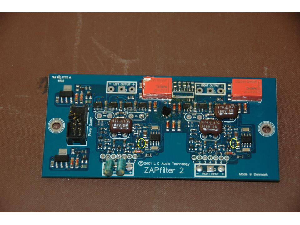

I don't remember the exact position of the resistor. I must open my cdp again to take a photo of the fixed ZF2 but this is quite a task. Instead i highlighted the resistor on the schematics of the ZF2. You can easily identify the resistor from the schematics,

Hi Karlosak,
I thought maybe i am wrong about the resistor( there are other 100 ohm resistors on the schematic, and to my memory it was the one on the first stage).
So I opened inside my cdp and checked where the 100 ohm resistor is. I cannot take a photo in cdp because the zf2 is placed in a very tricky place, however i can see the modification through a hole in the main PCB of the cdp. I took a photo of my old Zapfilter (which is abused quite a lot!!), and highlighted the actual 100 ohm resistor. Sorry for the wrong information if this picture proves i highlighted the wrong resistor on the schmenatic on my previous post.
Yes, you were wrong.
The resistor you previously highlighted in the schematic is in a red circle, the resistor in a yellow circle is the right one, it's in the second stage of Zapfilter :
This time the effect was readily evident - but in a negative way: -0.8V left and -0.4V right. I didn't realize I would need bigger resistance in my case, since the offset was negative.
The resistance of this resistor is crucial though. Just a little change of 10Ohm made this shift. I left only 1K0 there, around +7V DC at the outputs! Then I put 160R in there (nothing better at hand), around +1.9V DC. Finally I put together a parallel combo of three resistors that measured 122R and that worked! It started at +200mV and quickly settled to zero (<2mV). I haven't tested it yet in an enclosed player for a longer time though.
I'll leave the right channel as is (no problem there), and aim at 115-118R in the left channel. I'm buying a bunch of 82R-150R SMD resistors tomorrow for a piece of mind I'll post then what worked (if anything).
Hi Karlosak,
Your experiment does not sound like the right thing to do. Lars' explanation of the fix is that it increases the safety margin for sensitivity to common mode voltage in the inputs of the ZF. So there is no optimum value for the current mirror resistor, which you're trying to find.
This evening i did some measurements. My ZF installation has 2.523 V common mode voltage which is near perfectly identical on all the four inputs. My cdp uses two DAC chips, one for each channel averaging two DAC channels for each audio channel. So this is no surprise. The outputs read 0.0 mV dc on both channels. And these figures are rock stable... No change after heat-up or prolonged playback.
Bearing in mind that your ZF2 has half the dc as my ZF2 in the inputs it is more likely that your problem is something else. Maybe you have a faulty DC servo on the left channel. And let me remind you that none of my ZF2 channels behaved perfect before the modification. It is just that one was performing much worse than the other. You say your ZF2 right channel works fine. This suggests that at this point you'd rather request a replacement rather than experimenting.

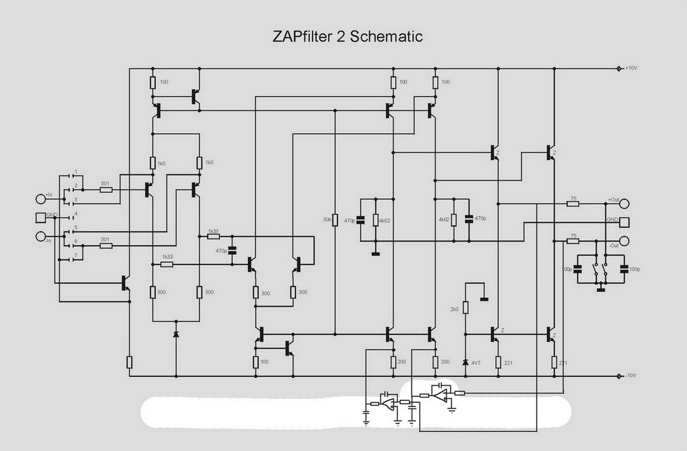

I got cuirious about the servo design as it appears to be a "trade secret" and as such omitted from the published schematic. After staring at low-res pics for almost two hours i think i see the way it works. Would be nice if someone in possesion of a board (Lars? ) can confirm.
Sorry about the ugly drawing.
