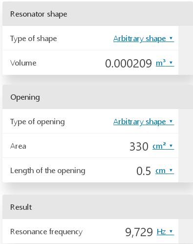

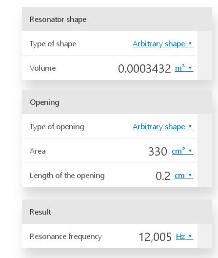

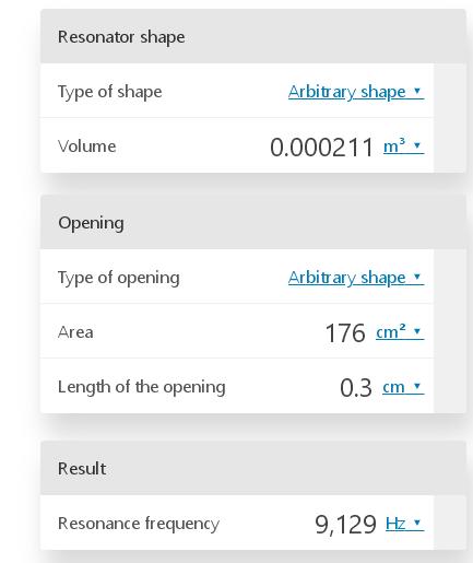

But what about the Helmholtz resonance:

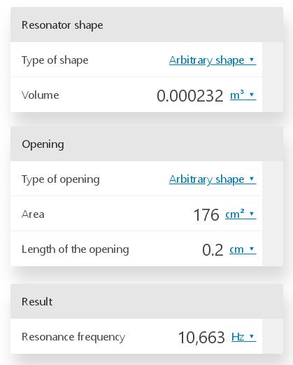

I want to push the Helmholtz resonator frequency up above 10 kHz, any potential harmonics will not be audible and the resonance itself might even be desireable helping the frequency response in the highs.

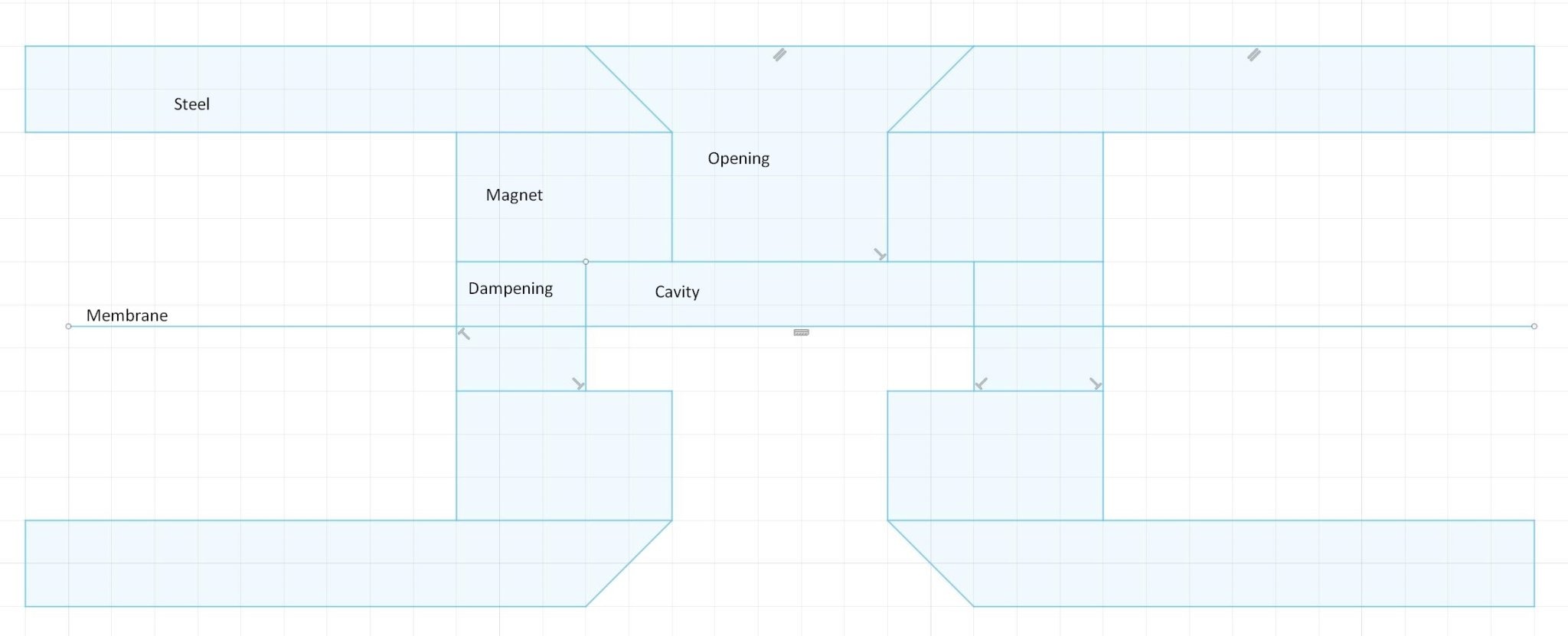

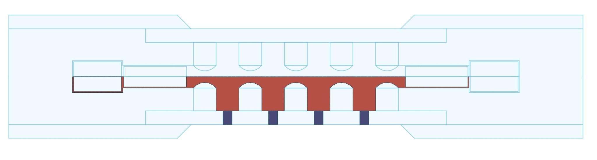

So the larger the opening area and the lesser cavity and opening depth will increane Helmholtz resonator frequency.
The cavity is in brown and the opening is in blue.

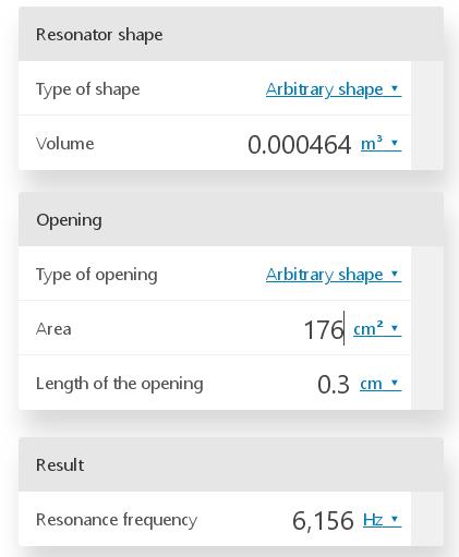

The cavity's area above is 211 mm2, so the volume is 2.2 m x 211 mm2 = 0.000464 m3 (0.464 litres).
Not taking the effective volume of the dampening itself into account.
The opening area is distributed across the front plate and has to be seen as a percentage of the area between the magnets.
The total opening area is 4 x 2.2 m x 5 mm = 0.044 m2 = 440 cm2.
With 40 % the opening area is 176 cm2.
The lenght of the opening area is 3 mm = 0.3 cm

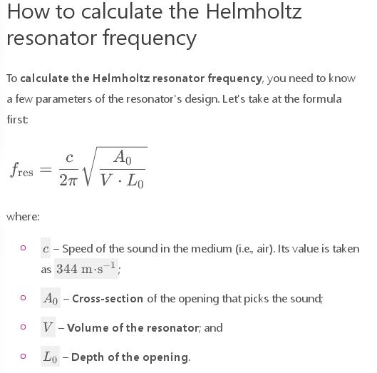

I'm using this calculator.
Please correct me if I am wrong!

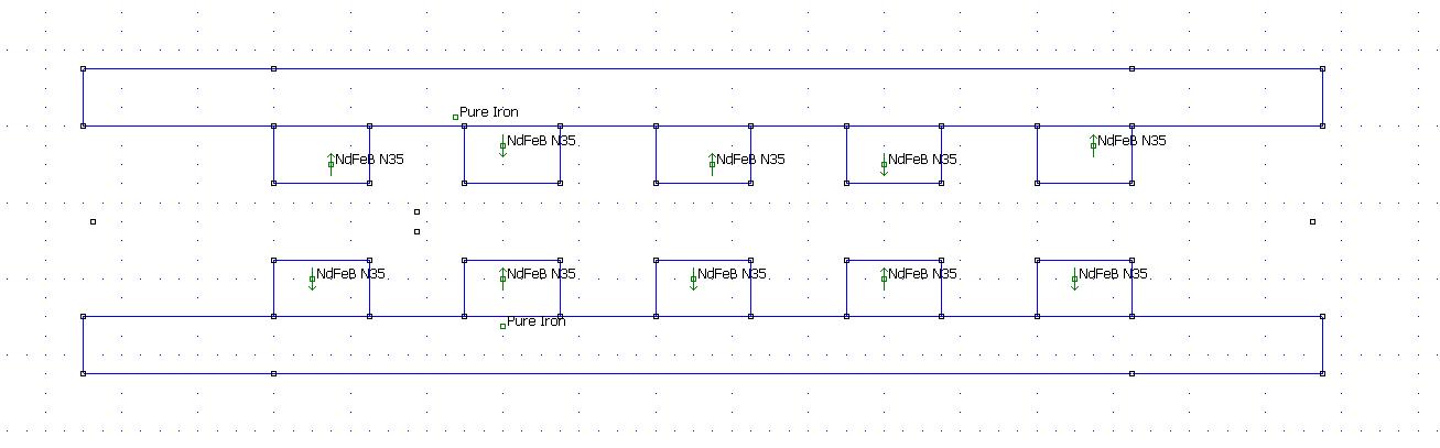

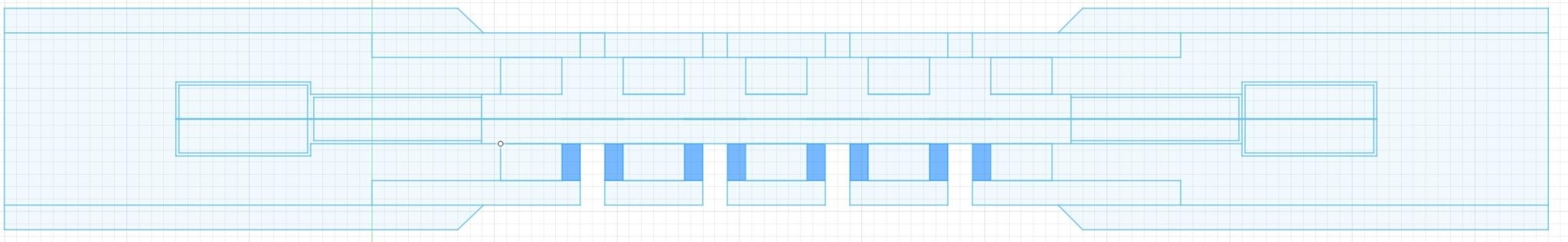

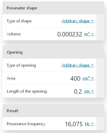

So I changed the motor, having 100x5x3 mm magnets instead (Yes,l I know Joppe!). I also reduced the gap to 4 mm:

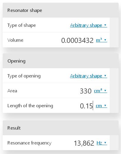

Giving an cavity area of 156 mm2 and thus a cavity volume of 0.0003432 m3.
With a more reasonable perforation ratio of 75% and 2mm steel plates, the Helmholtz resonator frequency is well above 10 kHz:
The reduced gap width compensate for the thinner magnets:

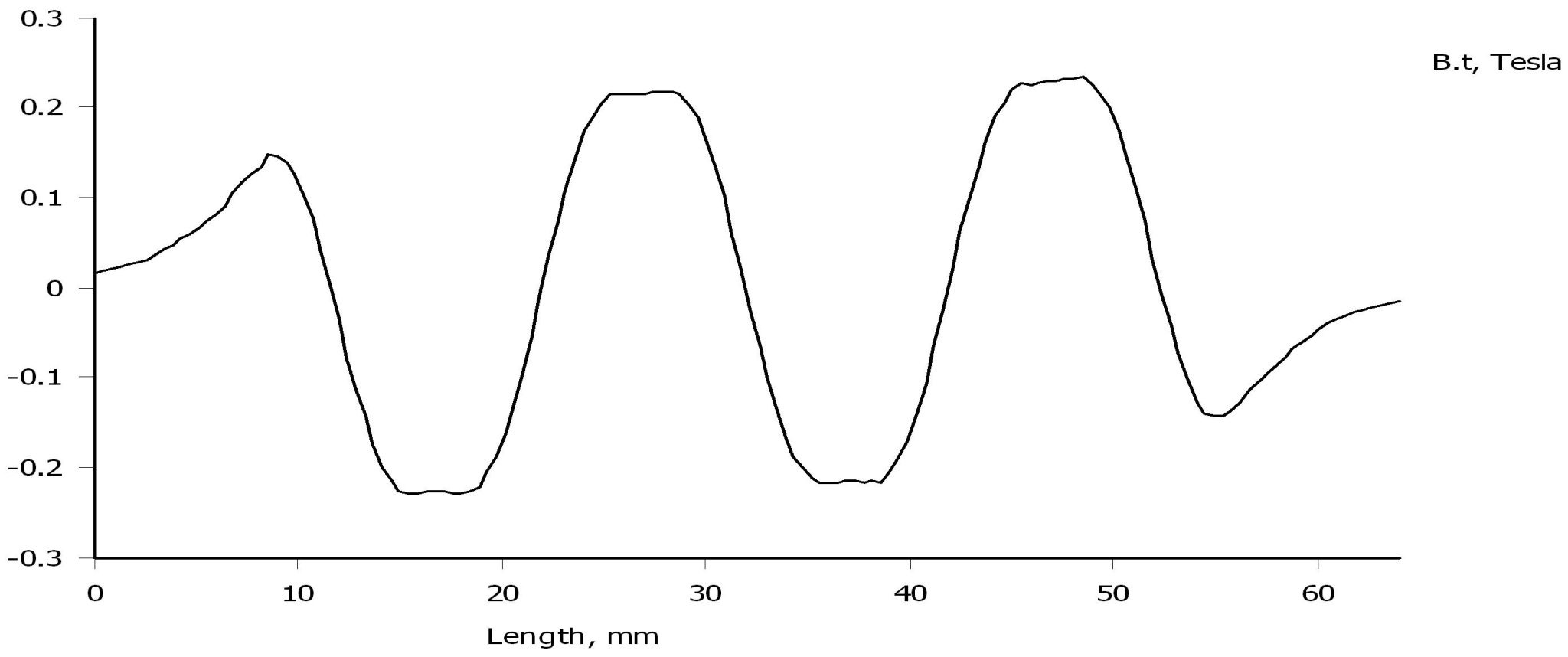

So the magnetic field density is still good:

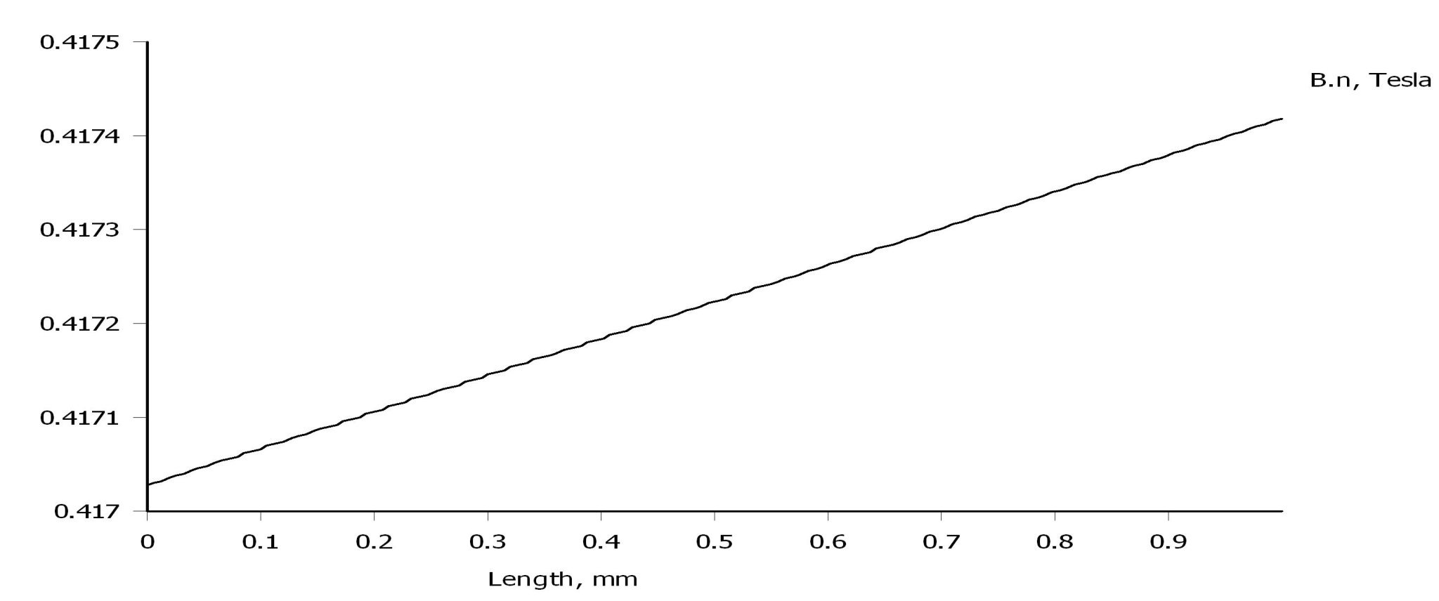

The density's lineary is still very good:

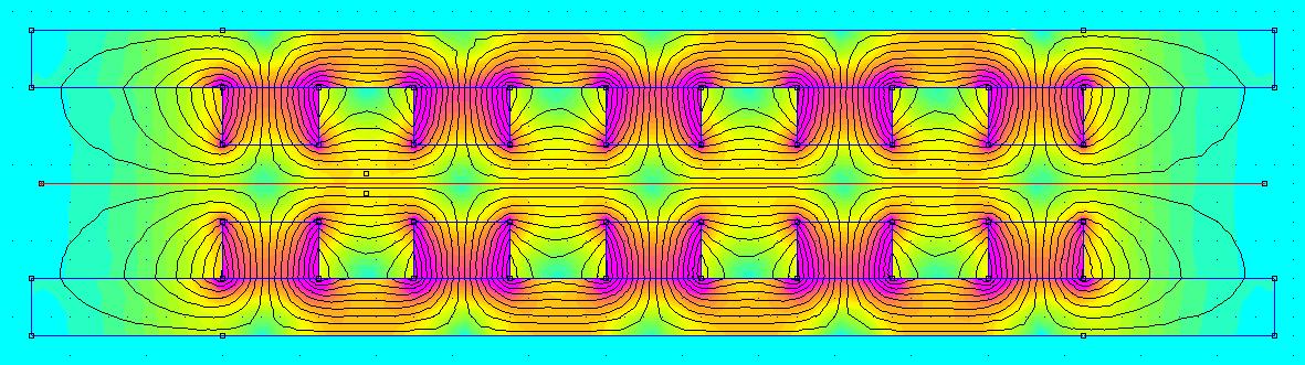

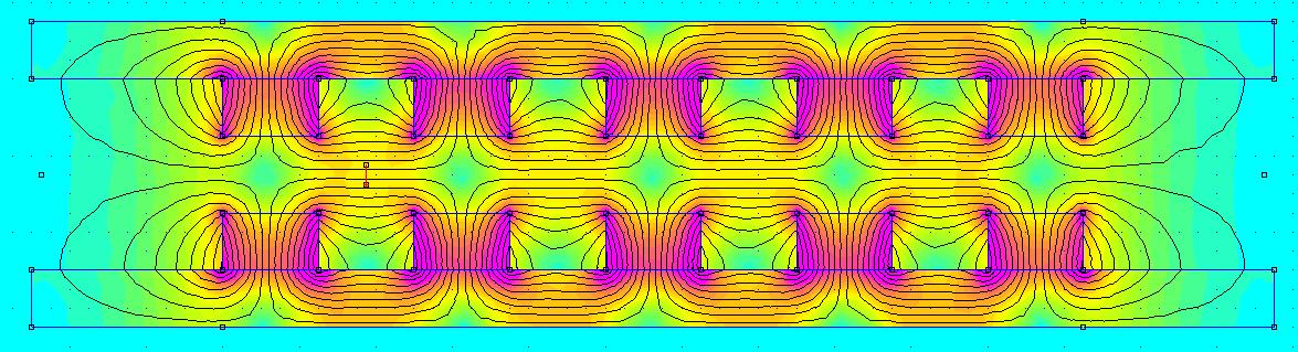

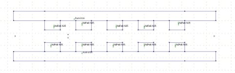

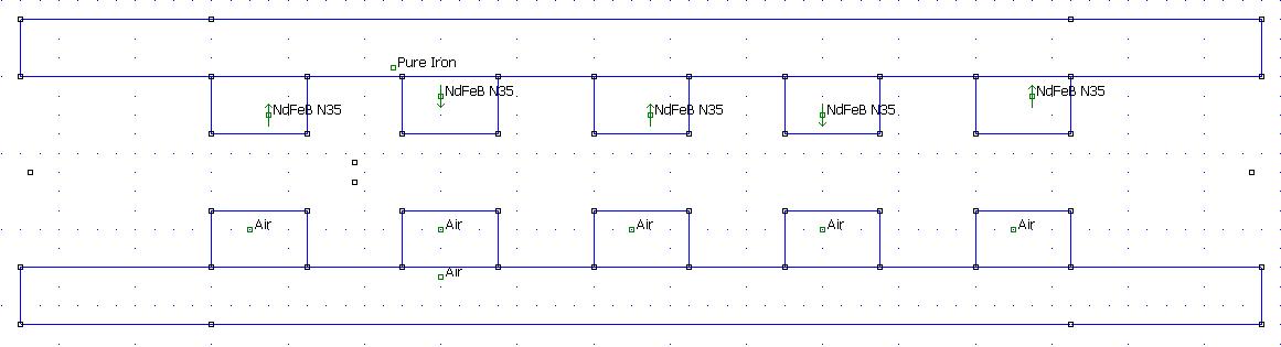

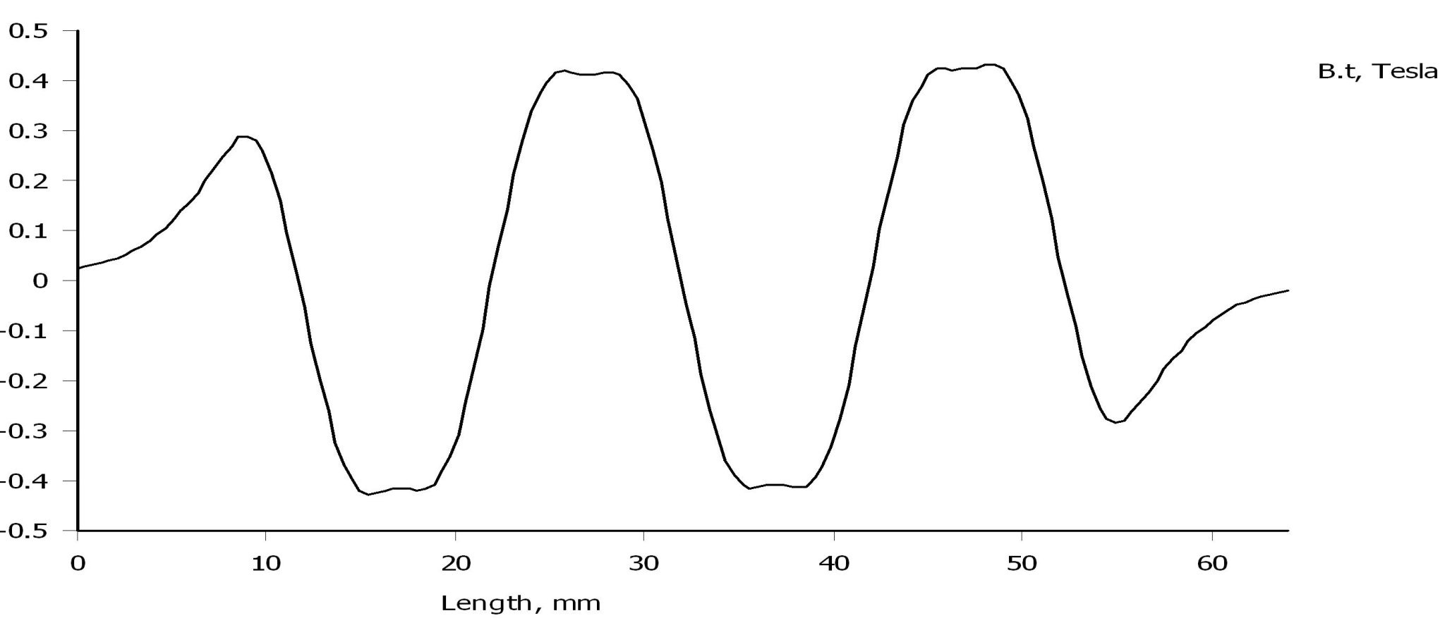

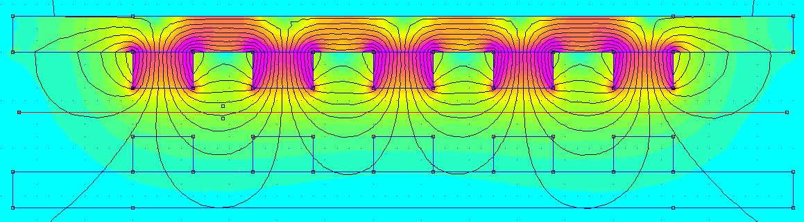

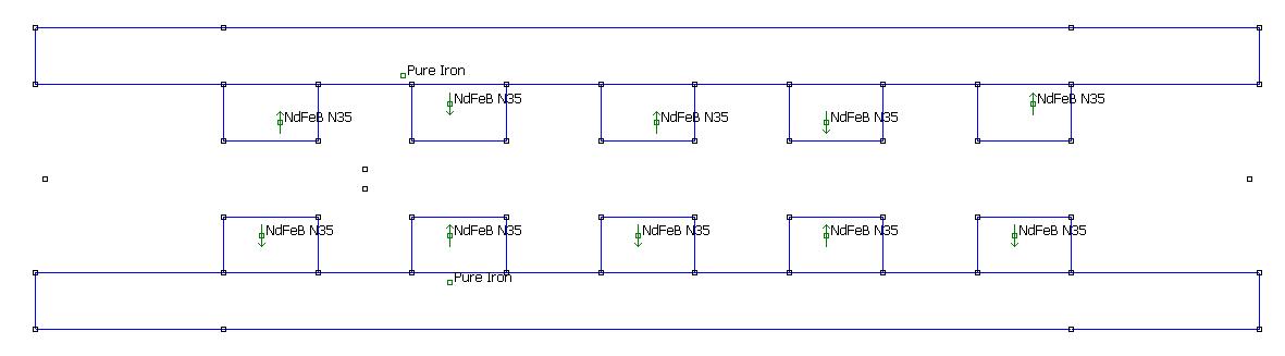

Here's a side by side comparison between PP (top) and SE (bottom):

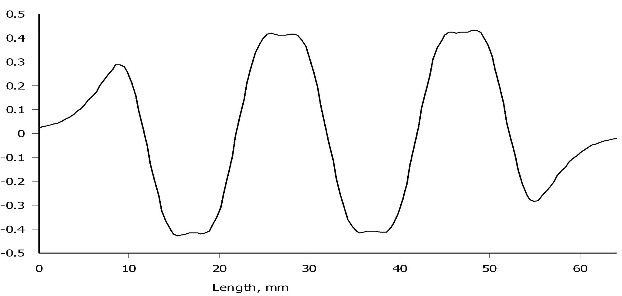

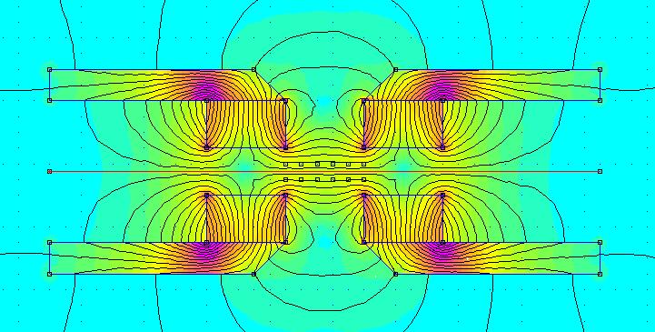

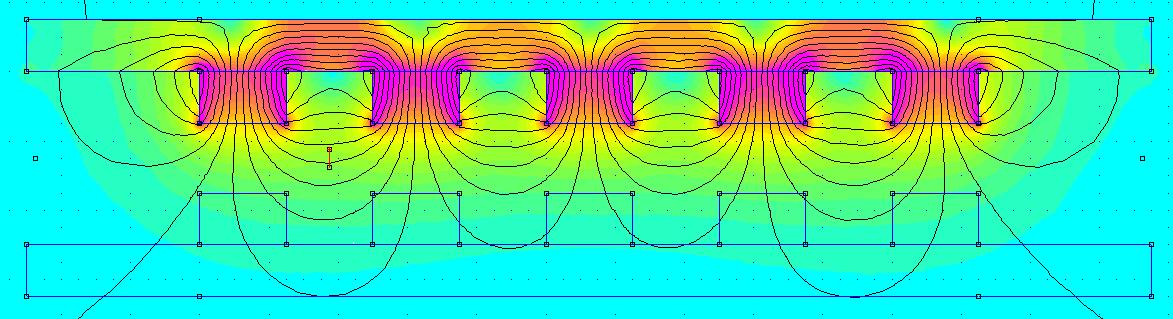

Simulated magnetic field densities across the magnets were the membrane is:
The the tangential magnetic field intensities we use:
Almost half the intensity, as expected.

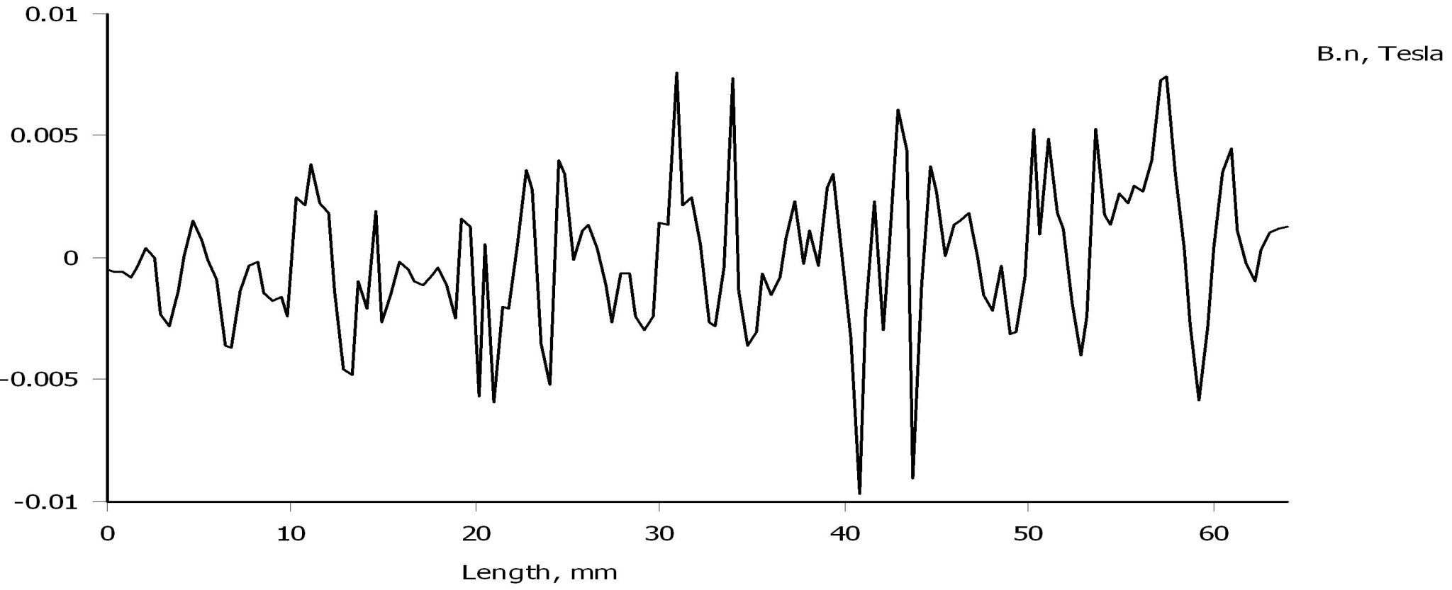

The normal magnetic field intensities we don't use and want as they will skew the membrane:
Almost zero for PP but a disaster for SE.

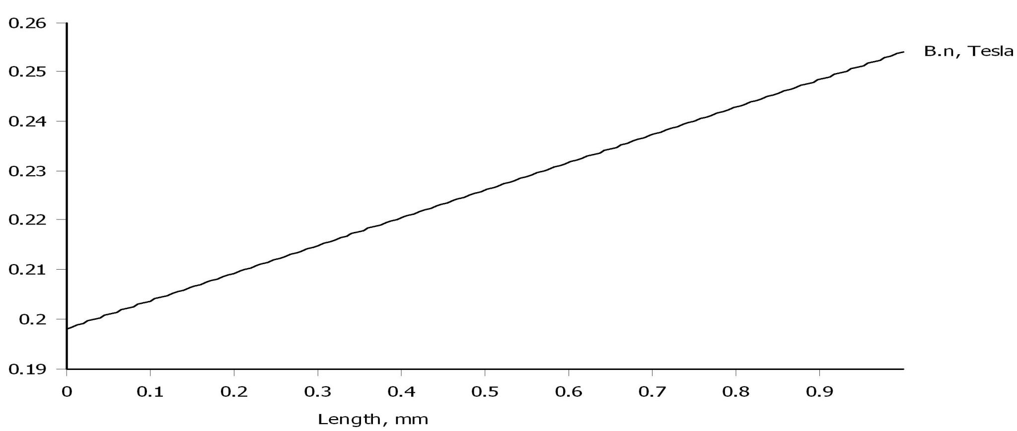

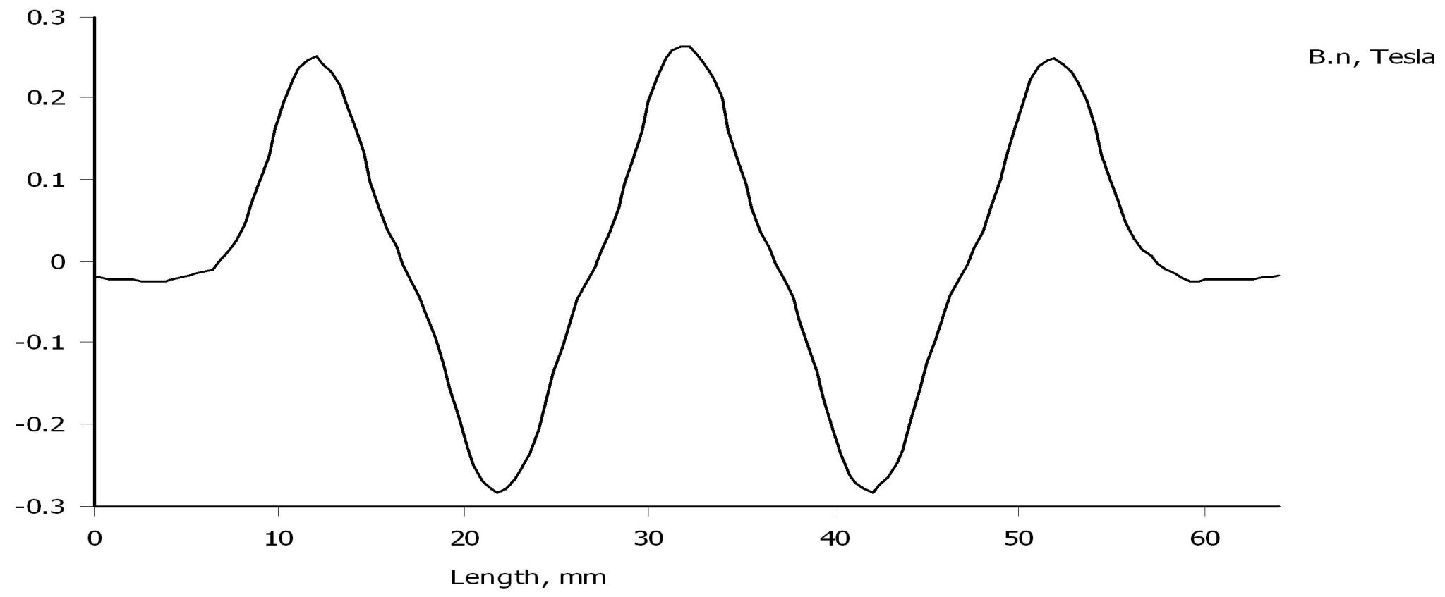

Simulated magnetic field intensities in the gap were the membrane moves, assuming we want an one millimeter Xmax:

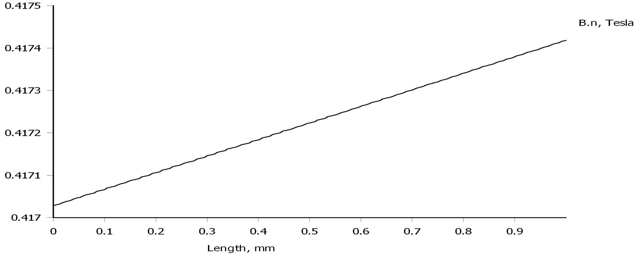

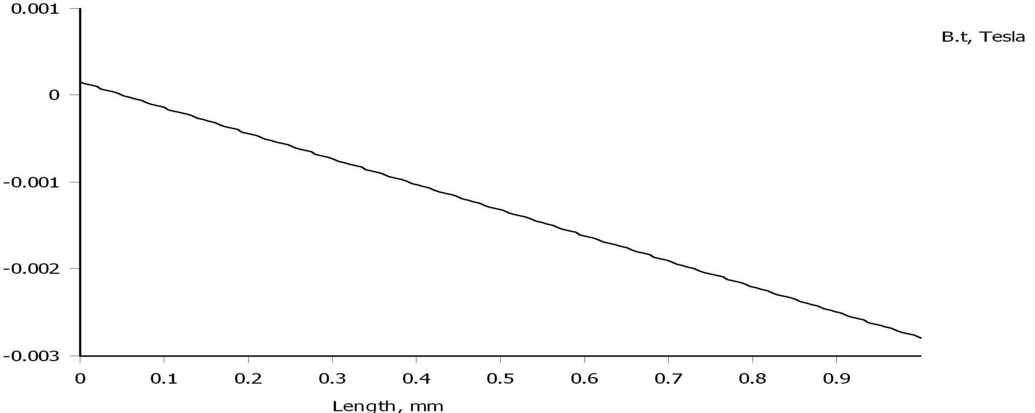

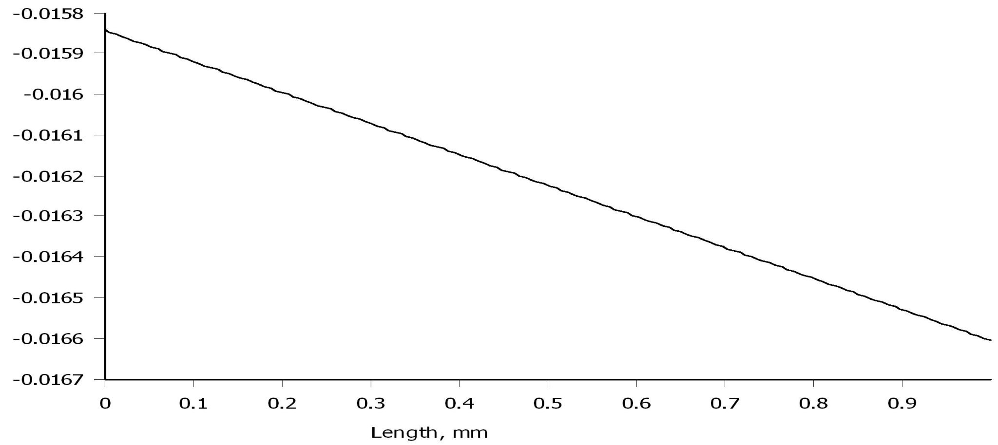

Here we want the magnetic field intensity, normal as the simulation in 90 degrees here, to be linear as it will otherwise result in compression and other distortion:
That's less than 0.1 % for PP and 6 % for SE.
Here we don't want any tangential magnetic field intensity:
Six times higher for SE, but probably inaudible in both cases.
Now, Helmholtz resonator frequency can be easily equalized. It might even be inaudible if it is high enough.
But the distortion that single ended introduces cannot not be reduced with equalization.

nice one SE vs PP , there is some debate about calling it PP, depending what people mean by it :) since it is not push pull.. hehe
but yeah that is a huge difference, and i still think it makes allot of sence down low. for tweeter duty on such a huge foil. (so things wont move at all) might not make a huge difference if any. but its cool to see in theory it does !! really nice project !!! i am glad you are buidling something like this :) more people should !i did not know that graph could look so smooth in PP, i always had this garbage (single ended, like the picture before) so i never used it after that
there is one thing that people do forget. how smooth and flat a SE can measure due to not having any magnets in front , i personally think for top end it measures the best out of the gate without the need for DSP. depending on the length. since long ones need some sort of EQ anyways :)

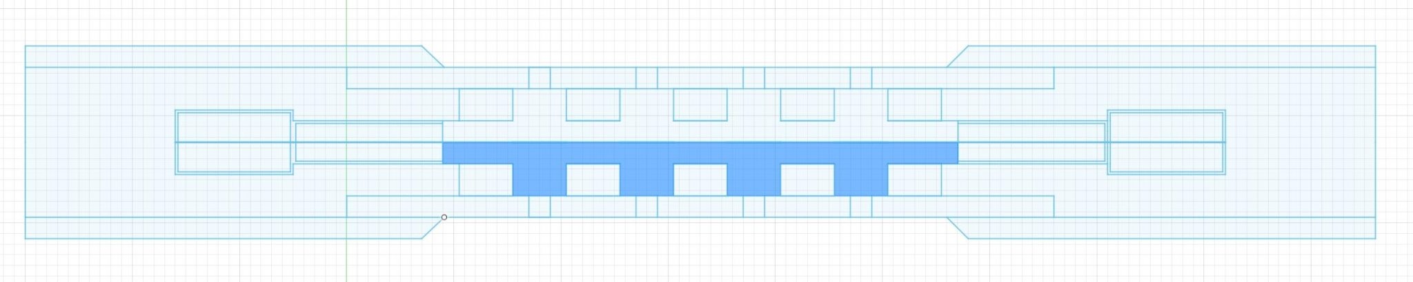

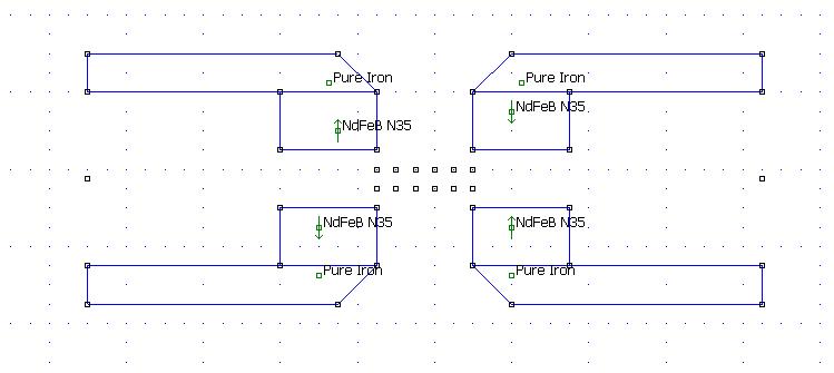

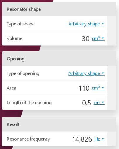

Anyway, here's my take on a planar magnetic push pull tweeter:
The gap is only 3 mm as the excursion doesn't need to be large for tweeter frequencies.
Dampening can be placed on the actual magnets.
Note that there's no steel plate between the magnets; it is almost a ribbon tweeter in that respect.
The downside is of course that the sound emitting area is only 5 mm wide and 220 cm long.
Helmholtz's resonator frequency is up:
If I have done the calculations correct, that is:
I don't know how much the tapered part of the steel affects the frequency.
So what do you reckon, is such a narrow tweeter feasible?

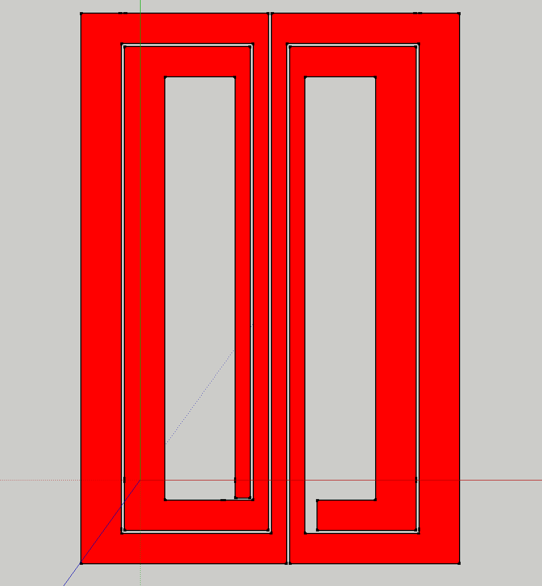

yeah it is feasible, i made one in the past. problem is getting the current back down to feed it again. with a regular coil and 6 magnets the return patch adds to the output. but i am guessing you chose this on purpose :) been extra small in width. i do like it, there is nothing in the way (metal or holes) will have rather great output, is small. only downer is the return path. either by wire (most efficient but needs soldering, or make gold plated fingers on pcb JLCPCB). or what i was thinking about on the same coil with very wide traces. something like this :)
The idea is that the left and right returns are not close to the magnet structure and are glued down on a spacer or something , so it can add to the output. getting impedance high enough becomes also harder without wasting to much power in the return path, thats why in this drawing they are much wider.
i still think having wires as return, is the most efficient (hardly any loss in the returns) , except that you want thick wire as return, and ripping the solder joint of the foil is rather easy :) so maybe a kapton flex double sided piece with nice holes to solder in to could work miracles. tape it on the membrane where the connections are, solder it, then solder thick wires to the kapton flex pcb acting as a cable relief. i was thinking about this as well :) for some time
