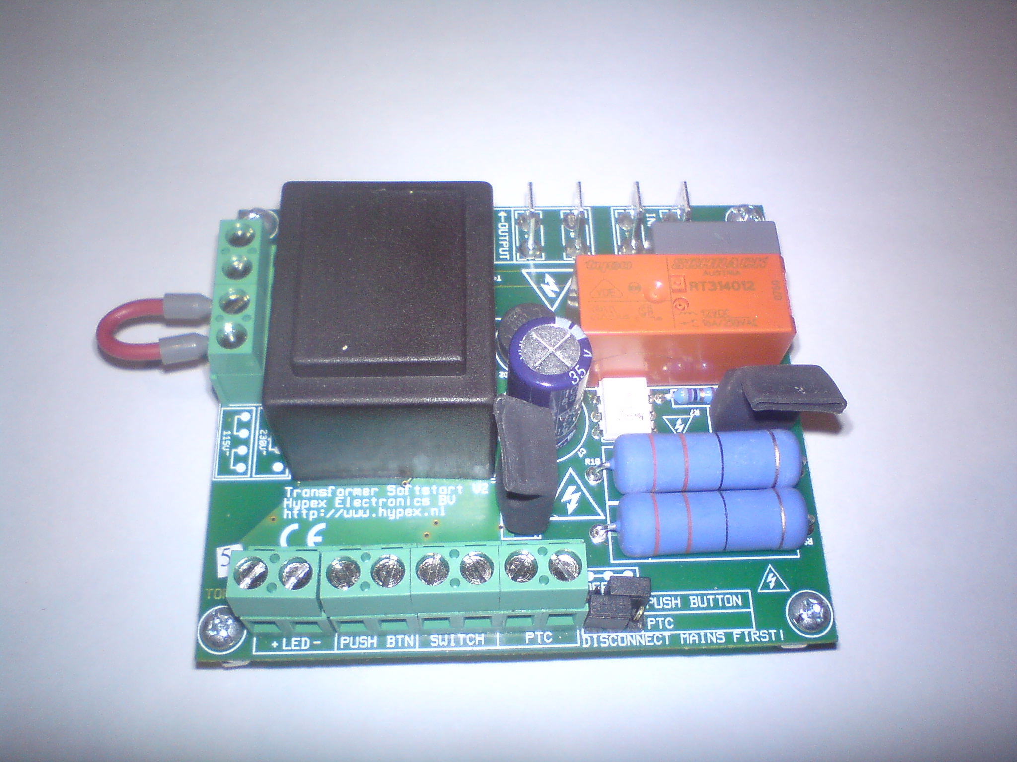

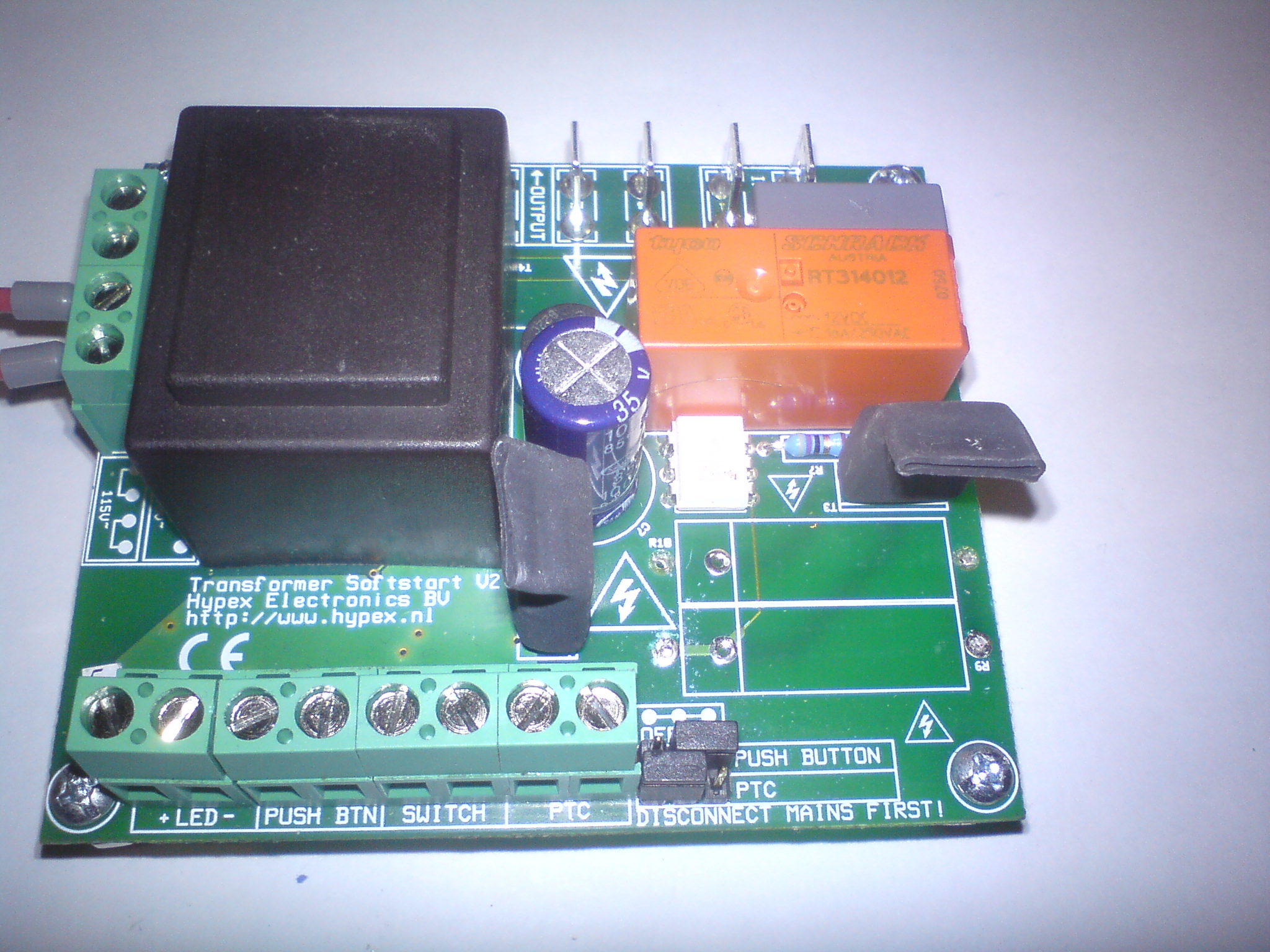

The capacitance requires a slow charge circuit.
The transformer requires a soft start circuit.
The two circuits are different.
One can cobble together a combined circuit that does both jobs, but the slow charge part is severely compromised by being fitted on the primary side. Slow charge should be fitted on the secondary side.
yeah
over-engineering is way to go
living in Athens , with European (220-240Vac) mains , means that 10-15R/10A NTC (placed in primary side , of course) will perfectly do the job
if more conservative , then "classic" soft start gadget circuit but with NTC's instead fixed resistors - will be perfect and really soft start solution .
usual ones , with fixed resistors , aren't universal solution ...... charging time must be tweaked to ensure non-sparking of shorting relay contacts ; using NTC's instead fixed ress. , especially with prolonged delay , will ensure long life and proper operation of shorting relay contacts

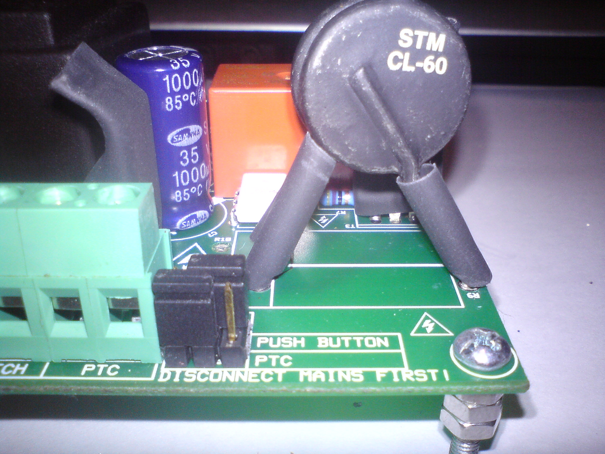

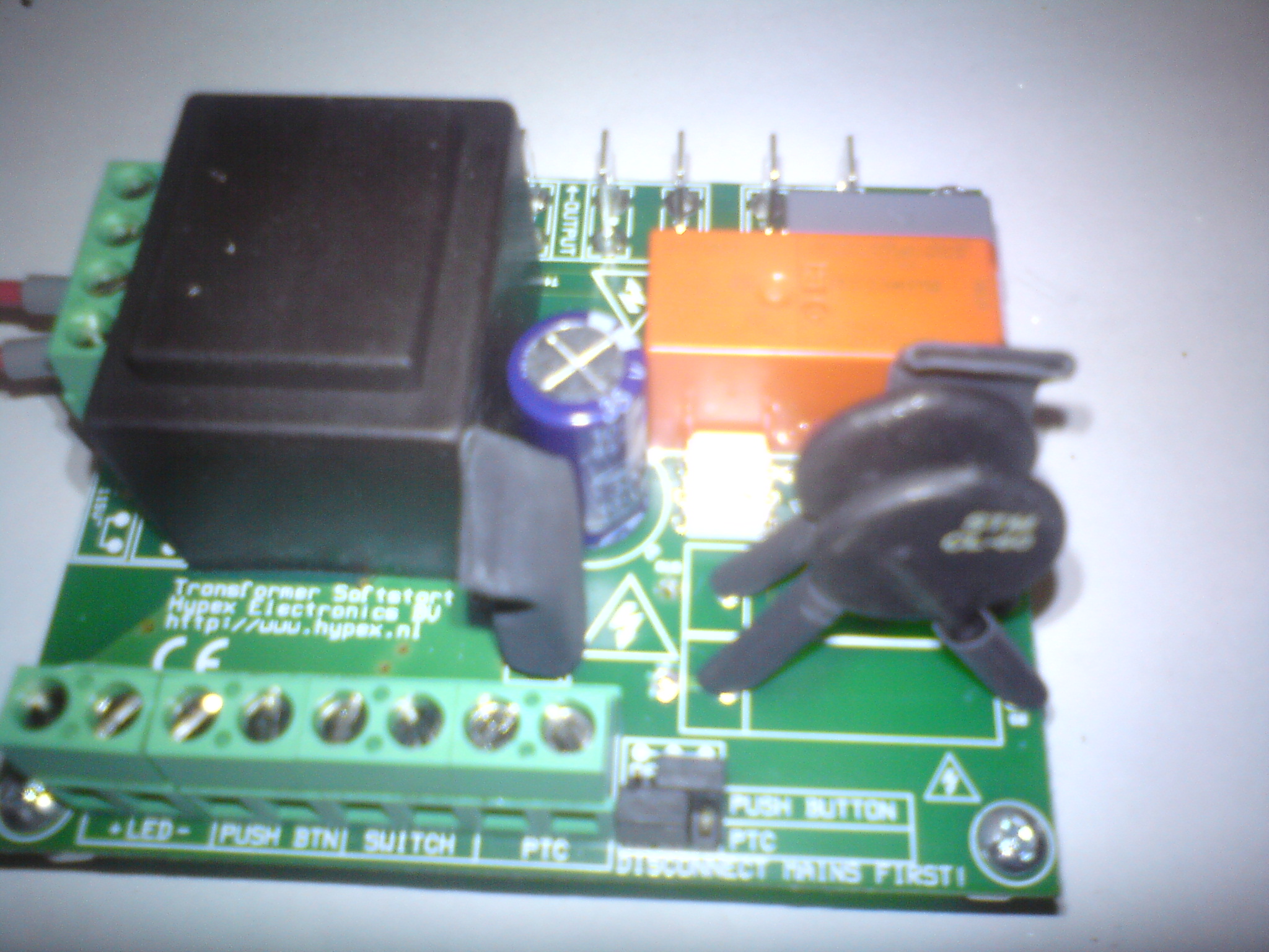

CL60 is perfect for a high power 110/120Vac primary.
Put one CL60 on each of these primaries and you have an excellent soft start.
This shows in some of Pass schematics. The two 110/120Vac primaries have a CL60 on each.
When you need to series connect the 110/120Vac primaries for 220/240Vac operation, you still need the two CL60. This time the CL60 are effectively in series.
Note that in both supply situations the CL60s are NEVER in parallel.

CL-30 is rated at 2,5R at 25 degress celcius and 8A of constant current flow, while CL-60 is rated at 10R at 25 celcius and 5A current.
Googled and mousered it fast.
http://www.ge-mcs.com/download/temperature/920_325a.pdf
you would need 8 off CL30 to give you a total of 20r to limit the start up surge current.
you need 2 off CL60 for the same 20r.
BTW,
I consider 20r of limiter resistance to be far too low for all transformers under 1kVA and 220/240Vac.
They cannot use a close rated fuse, eg. 750VA would require a T3.1A and with only 20r for soft start, this fuse is likely to blow too frequently.
Another example. I am using 140r @ 240Vac for a 80VA transformer and it starts on a T500mA.
BTW,
The issue in that case is that since the F5 works at ~180W, the constant current expected to be run through the thermistor on the primary side is a bit less than 1A.
This means that the CL-60 thermistor will work on ~20% of its max current capacity (5A), meaning at full F5 operation, it will be around 1R .
And 4 in series give 4R
On the other hand, a CL-90 (120R @25 celcius and 2A max capacity) will give an even bigger initial current reduction and will eventually work at 50% giving ~3R resistance at full F5 operation.
Another issue that concerns me is that the recomended max capacitance rating for them is ~1500uF @240VAC. Aren t we pushing them way above their comfort limits? According to the datasheet, this is not their max safety threshold, but rather an indicator that their life might be shortened.
Maybe we should use 2-3 in parallel? (Which of course starts another round of discussion about what happens if one of them burns and/or shorts...)
