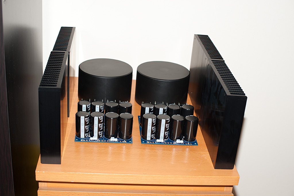

Yeah too bad about the 400VA limit... And those won t be available until August or something if i remember correctly...
About attaching them, the top "bell" is screwed to a shaft which has a M5 (I think) hole so you just drill the bottom of your chassis and fit it.
Nice and easy.
I will post more photos soon
Nice and easy.
