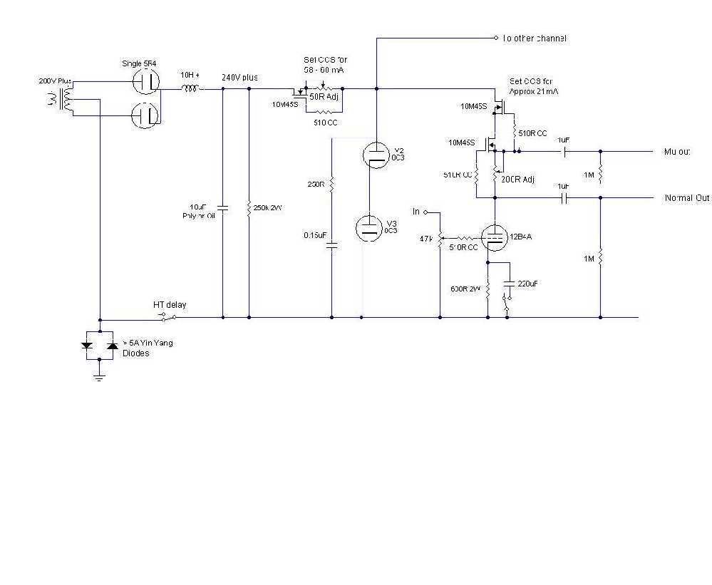

You could try using a plate ccs as per the attached circuit diagram and compare it to the cathode ccs you are currently using. As an upgrade to the ccs shown in the schematic you could use this:
http://www.pacifier.com/~gpimm/self_bias.htm
As shown with a 1 uF coupling cap the linestage is fine for driving loads down to about 30k (or even lower if you don't need seismic bass). For driving really low impedance loads the mu out works best.
For a choke loaded version try the H3007 plate choke from handmade electronics (around $20) which works very well with this tube.

I'm driving a DIY KSA-50 MK-2 with my 12B4. While the 10 mfd capsmay seem large they work extremely well and the LF reproduction is floor ratting! Speakers are Dynaudio Audience 9's. Also I have bypassed both the cathode and ouput coupling caps with multiple other caps, mainly Wondercaps of various values. This 12B4 was my 4th version and so far the longest lived.
We've used this version of the 12B4 for all the Pass Shoot Outs so far. Everyone that comes over and listens ends up building one of them pretty much the same way.

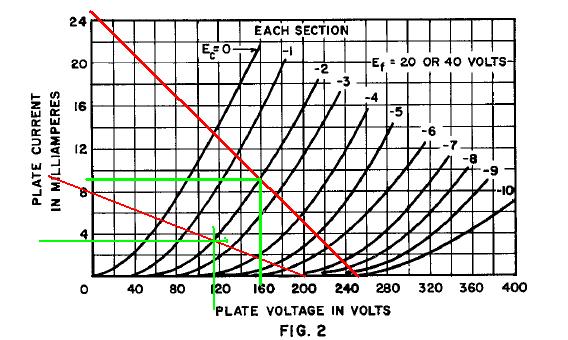

Hi Arnoldc/all,
My Rp ~ 6.3k (paralleled some resistors, was fishing around operating points) , b+ = 260v and my Vp ~ 120v.
Why plate choke ? Plainly curious ... I have read posts where people have been happy with it, I really wanted to try an opt but the gain is barely enough for me right now ... don't want to loose anymore, so thought I'll try the plate choke. Might end up trying gary's ccs too, will post a comparison if I try.
The handmade electronics H3007 from the earlier post looks cheap enough ... at 60H, assuming 2K plate at my operating point, -1db is at 20hz (see attachment). When calculating the B+ required for a choke load do you just use the dcr of the choke eg. 360R*23mA and add it with Vp or is there some other method ? This seems too simple/too low ?
Is this attempt waste of time ? Any pointers will be of great help.
Thanks,
Praveen
Thanks Arnold,,
That's pretty much where I was thinking of running it.
Praveen, your voltage calculation is spot on. Chokes and transformers can swing the positive voltage that you need to provide for a ccs. I think you will find the comparison between choke and ccs interesting, as they sound quite different. Although the H3007 is not a boutique component, it is an excellent performer with a low DCR.
pm

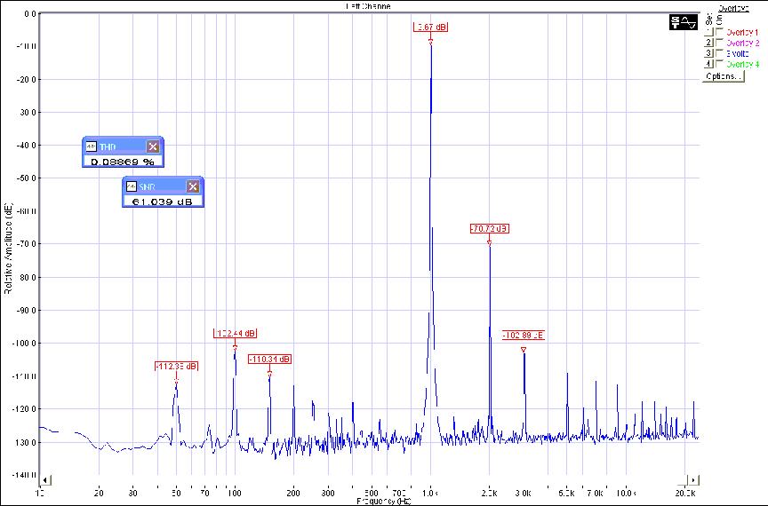

I took these FFT's several months ago. Just found them.
The noise floor of the 12B4A seems lower than the EH6922. The second harmonic distortion is however higher by about 8 db compared to the 6922. Sound card was an ESI Juli@, which is now dead ! Still do not have replacement NJM4580 V opamps !
Output voltage was 1 volt into 100K ohms.
Just put it up FWIW.
