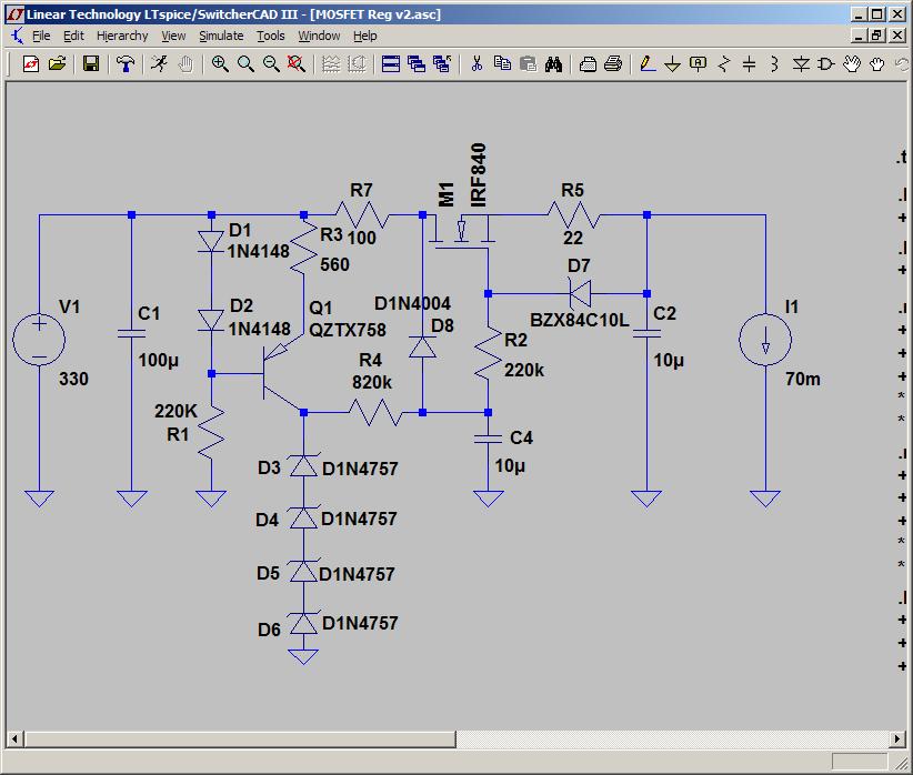

arnoldc said:
adjust the zener string for the proper output voltage.
Your input to this is after rectifier or after rectifier-C-R-C-R-C? So add zeners to raise the final output voltage? Can the caps by lytics, your diagram seems to show poly?
thanks for your help!
