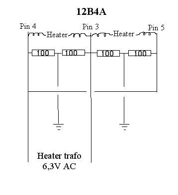

Jan, with 6.3V use series connection on the 12B4 filament. My prototype was like that, however, my final one was 12.6 volts as i needed lower current due to small size of my chassis (see the picture gallery). i used AC and there's no audible noise (i have not measure it yet).
Yes you can use ac for the heater. You will get lower hum levels with a dc heater but ac heaters do sound very good with no intrusive hum.
To keep the hum as low as possible connect a potentiometer in parallel with the heater and take the slider to ground ( earth ). Keep the slider at the center position. Using an mV meter measure the hum and tweak the slider in either direction till you get the lowest reading. This is easier done with a spectrum analyser . Many PC based ( free ) software spectrum analysers are available on the Net.
Alternatively you can solder a resistor to ground from each heater terminal . Say 100 ohms 0.5 watts ( for a 6.3 volt heater) . The transformer secondary used for the heater must be floating ( not connected elsewhere ). So you will now have two resistors going to ground. Try it , its easy.

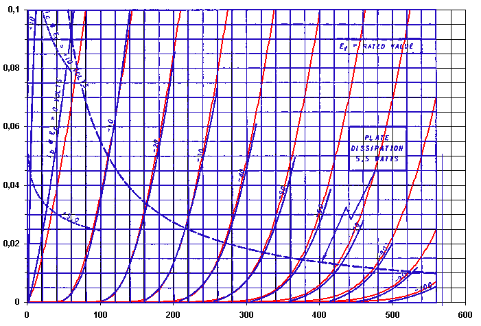

In the Norman Koren model I did use:
MU=6.5 EX=1.35 KG1=630 KP=59 KVB=1300 CCG=5P CGP=4.8P CCP=1.5P
This is optimised for a plate voltage from 100V to 300V and fits very well in that range. Attached an overlay of the curves, blue is datasheet, red is model

ashok said:Yes you can use ac for the heater. You will get lower hum levels with a dc heater but ac heaters do sound very good with no intrusive hum.
Cheers.
I am trying to visualize this in my head... You often need to elevate the heaters by means of a voltage divider from B+. You would connect the slider of the pot to this voltage divider, and not to ground in this case, right?
.....connect the slider of the pot to this voltage divider, and not to ground in this case, right?.......
Right. I forgot about this scheme. I've attached a schematic. So if it has to be raised to some B+ voltage , then its connected as you mentioned and as shown.
The capacitor is important.
Cheers.

I have a question.
How much current does the line stage draw?
I looked at the curves and saw that for the grid voltage to be 0 (zero) the current has to be 75mA.
That number seems too high, is that right?
How do I figure out the tube current from the curve?

You seem to have not figured out how to find a plate current for a certain grid voltage.
Take a supply voltage like say 200 volts. On your ( anode current vs anode voltage ) graph pick the 200 volt anode voltage and zero plate current point ( on the X axis ).
Next determine what plate load you are going to use . Say 5 kilo ohms. Now divide max plate voltage ( = supply voltage) of 200V by 5K ohms. That gives 40mA. Now pick 40mA on the Y axis where plate voltage is 0. Join the two points to get a load line of a resistive 5 K Ohm load.
You can now pick an operating anode voltage and corresponding plate current along this line and determine the grid voltage you will need. You will need to pick an operation region that is linear over the range you want to swing the output voltage.
eg. Va=95V , Ia= 23mA , Vg=-10 volts . Now that is just an example and not an operating point you must use.
Hope you get the gist of how to do it. Plenty of material on this is available if you do a Google search.
Cheers.

lawbadman said:How do I figure out the tube current from the curve?
http://www.mif.pg.gda.pl/homepages/frank/sheets/093/1/12B4A.pdf
Ashok summed it up. For a complete explanation see this site: http://members.aol.com/sbench101/. Look down the page for the section on Loadlines. That will show you what Ashok was describing.
