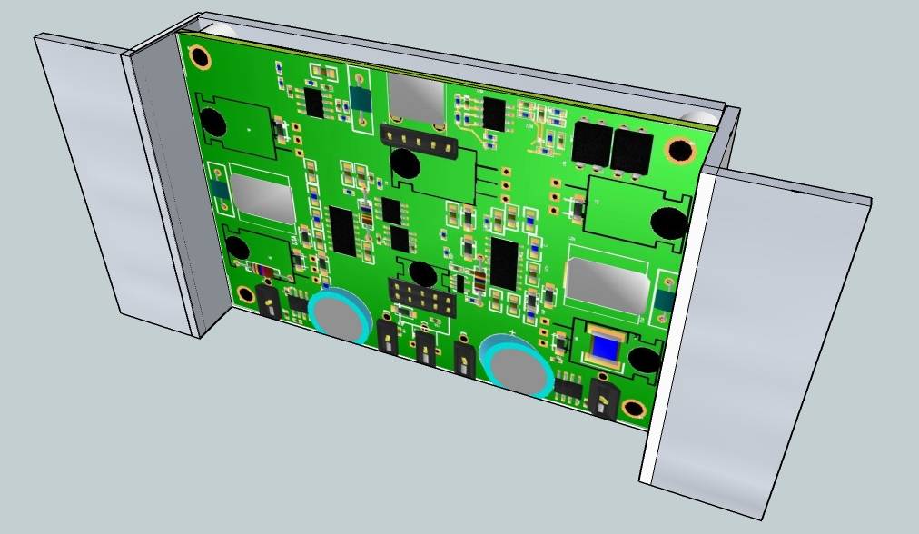

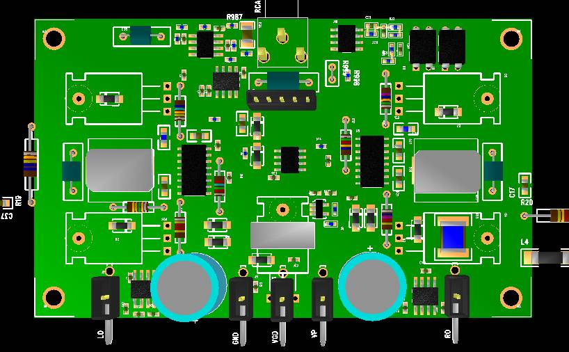

Form Factor
For starters, here is the form factor I came up with so far. (No routing yet, I’d like to stay some more time in the placement phase). Measuring 90 by 60mm, it fits onto a heatsink plate or extruded profile. Output MOSFETs are TO-220, mounted underneath the board which has holes drilled to access the mounting screws for the transistors.
http://www.diyaudio.com/forums/attachment.php?attachmentid=237851&stc=1&d=1314661880
Two TO-220 BJTs are mounted in the same way. One is the regulator for the gate drive voltage, and the other is a Vbe temperature sensor.
Input is at the top of the board via an RCA jack, while output and power connections are at the bottom. These can be either screw terminal blocks, or faston males.

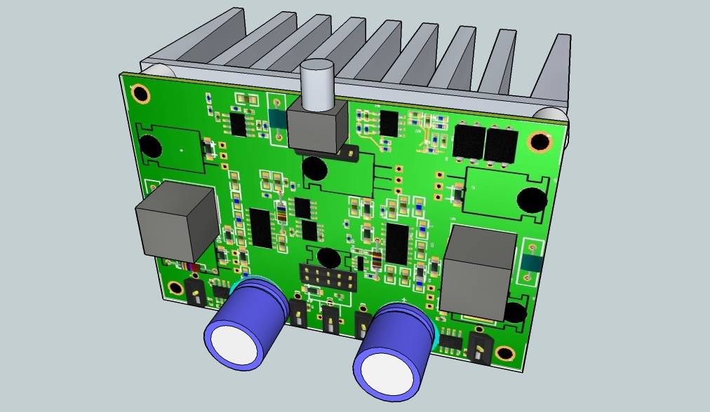

Below are two possible heatsink mounting options, the first could be built into a (low power) active speaker, the second is beefier.
http://www.diyaudio.com/forums/attachment.php?attachmentid=237854&stc=1&d=1314661880
Of course, many more variations are feasible. BTW can you tell I have been fighting with Sketchup?
http://www.diyaudio.com/forums/attachment.php?attachmentid=237855&stc=1&d=1314661880
The two metal cubes are the output inductors. The layout accomodates the SAGAMI as in the RD, the Wurth WE-PD, plus there is enough real estate to accomodate larger toroids.

Would you able to mount inductor of the order of t130?
Vertically, no problem. See the protel render, attached. I just need to remember to drill additional holes for passing a nylon strap to hold the inductors. BTW what gauge wire are you winding the T130 with?
