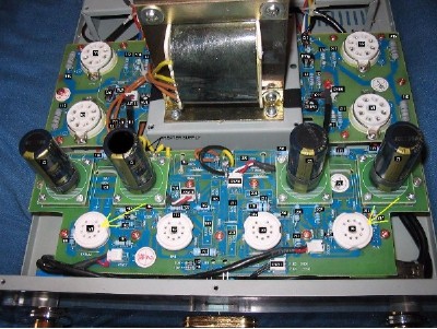

Q1. of the 4- 6N1s that sit at the front, which two's are the SDRP pre-amp buffer ?

[ Q1. of the 4- 6N1s that sit at the front, which two's are the SDRP pre-amp buffer ? ]
They are V1 and V4 as shown by yellow arrows on attached photo.

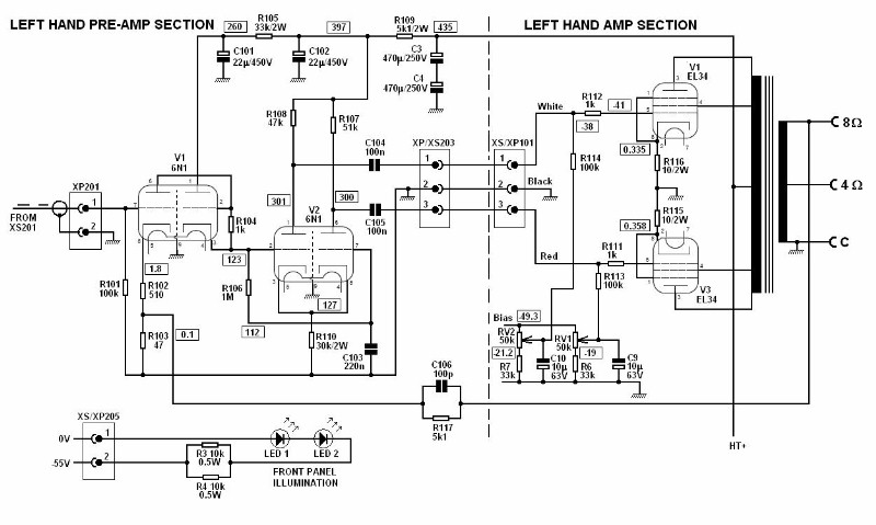

Hi Al
Yes the 6922 will impose less demand on the heater line but personally I would be very cautious of the other supplies around these preamp valves. Attached is a redraw I made of the left channel with measured voltages. There is 300V Anode voltage on one stage and the cathode sits pretty high too, I never had the courage to try a 6922 in case of flash-over. Scary!
I did find the original Chinese 6N1's very sharp at the high end and they produced a lot of sibilance, putting in the Svetlana Golds was quite noticeable but I suppose it all comes down to ones preference in the end. I did buy a cheaper set of Svetlana 6N1s, they had Black markings. I was never happy with them and finished up putting back the 2 year old Golds. I suppose I shall have to save some pennies up and invest in a new set of those, cannot explain the difference, just more air? sound stage? stereo presence? whatever, they just sound better.

Tks again Les.
Your circuit is the most detailed and nicely drawn one that I have come across to date - really appreciate it.

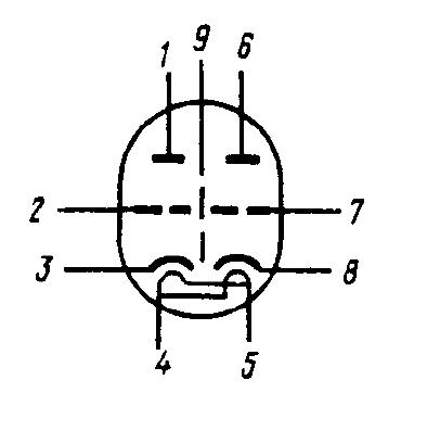

You could check out the individual electrodes for short circuit using a multimeter but a better check would be with a higher voltage such as a 250V insulation tester.
Looking at the valve base with the gap in the pins at the bottom, the pins go clockwise 1 to 9.
Check out a low reading between pins 4 & 5 to prove the heater has continuity.
Check out insulation between pin 1 to pins 2,3,4,6.7.8 & 9.
Then Pin 2 to pins 3,4,6.7.8 & 9.
Then Pin 3 to pins 4,6.7.8 & 9.
And so on to finish up testing between the last two pins 8 & 9.

I did look at the circuit carefully posted by you. Now I do understand what you are saying - the plate voltage design for the 6J1 of this amp will be on the high side of the 6922. Plugging in a 6922 will result in it operating at a plate voltage very close to the spec max or even slightly higher than the spec max.
I do see the logic now -
6J1 replacing a pre-amp circuit designed for 6922 is ok but not the other way - it does not means that 6J1 and 6922 are interchangeable both ways (Some web postings suggested that if 6J1 can replace 6922, therefore 6922 can also replace 6J1, which is not a 'safe' assumption).

The circuitry in places is virtually identical and the improvements/mods detailed are very tempting to try. For example, take doing away with the 30k long tailed pair resistor. Would a simple circuit as attached be capable of replacing the resistor with any advantage?
Also it is stated that if this is done the two plate resistors, currently 47k and 51k should both be made 47k?
In fact it had already been suggested to me that one of these resistors, possibly the 51k, should be made variable e.g. 39k with a series 22k preset. This would allow the outputs feeding the EL34's to be equalised.
Noted also is the change of B+ resistor from 5k1 to 12k, that seems a bit of a large jump to me and though it might lower the gain of the pre-amp, would it improve the sound quality?
Finally the feedback components (5k1 with 100pF cap), the cap is indeed a ceramic one in the MC10L, would a mica make any difference here? Would lowering the gain of the amp by changing these components to 1k2 + 500pF be an advantage?
I must say I am tempted to disconnect the OPT wires from the screens of the EL34's and connecting the suggested 47 Ohm resistor between plate and screen to give a triode configuration, just to find out how it sounds.
