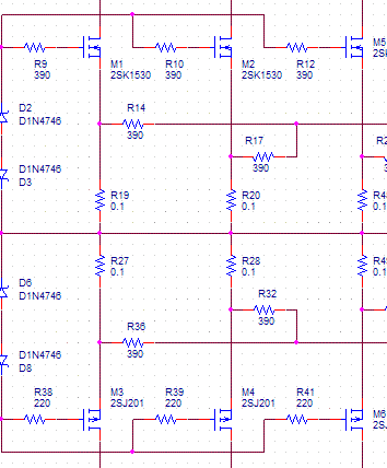

4. This is an interesting comment. That cap costed me a PCB revision! The prototype was built with only one pair of output devices and no cap was required as long as the diamond buffer current was over 10mA. For whatever reasons, when I was adding more pairs all kind of strange switching effects happened, also depending on the gate stoppers values. Increasing the buffer current was not an option (power dissipation), increasing the gate stopper was also not an option ('cause I was targeting 10MHz unity gain frequency) so here's the cap and BTW, 10nF works fine as well.
With gate stoppers of 390 respectively 220 Ohms you are asking for trouble (i.e. cross-conduction), in particular when targeting at a BW of 10MHz and high slew rate. No one is using such large resistors. Cordell: 47 and Stochino: 0.. 22 Ohms, for example.
Increasing the gate stoppers makes things only worse.
Using a diamond topology (highly unusual in a high power amp) as remedy solves only halve of the problems (indeed fast turn-off but now slow turn-on) and is a waste of silicon and PCB space.
A conventional driver stage and appropriate gate resistors could have easily solved cross-conduction and related issues.
so, I really don't see any advantage of your approach, only disadvantages.
1. Take a deep breath.
2. Put your glasses on (if applies).
3. Open this: http://www.diyaudio.com/forums/showthread.php?postid=1596058#post1596058
4. Look careful at the picture and try to identify the gate resistors. Hint: they are close to the 2SK1530/2SJ162 gate pins. If you don't know which is the gate pin just ask.
5. Identify the gate resistor values. A magnifier can come handy.
Now you can rest and continue to elaborate brilliant ideas. Meantime, you may want to recall how many times you posted or otherwise published schematics with some errors.

R10=390 and R39=220, see below! I'm sorry, but it is really your schematic.
How about your glasses?
edit: Is the photograph of your amp supposed to be a replacement of a schematic? Not the most efficient and accurate way to exchange design ideas.
