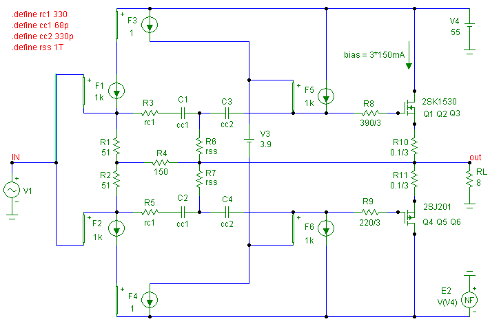

TPC vs. TMC
syn08 said:
[snip]
In both my simulations and experiments, there is a huge difference between a simple Miller cap and TPC. It's only TMC that does nothing compared to TPC.
............... if there are certain topologies and configuration where TMC has a significant advantage over TPC, this is worth an in depth study for which simulation is the ideal tool. You may want to revisit this topic and let everybody know about.
[snip]
Common sense (and theory) tells us that TPC (two pole compensation) reduces both the distortion of front-end and OPS as well, while TMC (transitional Miller compensation) reduces only the distortion of the OPS. So one may wonder why using TMC at all. The point is that the phase response of TMC is much better (TPC shows a nasty dip). Since -generally!- the OPS contributes the most to distortion, little is gained by a further distortion reduction of the front-end. In this regard, TPC has no advantage over TMC, it only spoils the phase response, resulting in overshoot. So far so good.
Back to YAP. Ovidiu reported: "In both my simulations and experiments, there is a huge difference between a simple Miller cap and TPC. It's only TMC that does nothing compared to TPC. "
Hmm.... at first glance rather weird I thought. Later on, I realized that it only makes sense if the OPS is NOT the main contributor to distortion. Was that really the case? According to my sims, definitely yes!
I've simmed two circuits (TMC or TPC disabled): one with ideal and distortionless components in the front-end and one with such components in the output stage. Et voilà..... THD20 of the first one was 9ppm, while the other one produced 30ppm! So most of the distortion stems from the front-end, making TMC ineffective.
Re: TPC vs. TMC
I'm afraid I don't really follow. Care to post the schematics you used? Thanks.
Re: Re: TPC vs. TMC
Of course I could post the schematics, although extra work to make them 'publishable'. Moreover, as you are not familiar with specific MicroCap symbols (I suppose), this might lead to even more questions. So I think it should be more efficient if you clarify what exactly you don't understand. But I guess you have some trouble with the meaning of "ideal and distortionless components", right?
These are, using MicroCap terminology, so called "dependent sources".
In the first schematic, I've replaced the BJTs by "current-controlled current sources" and gain of 1000, except in case of the current mirrors+cascodes, then the gain is of course just 1
In the other schematic, I have replaced the MOSFETs by "voltage-controlled voltage sources" with a gain of 1.
That's all. If you have more or other questions, please, let me know.
BTW, what about my question which you can find here: http://www.diyaudio.com/forums/showthread.php?postid=1595502#post1595502
TPC vs. TMC
In the meantime I realized that there may be mores sources of confusion, like using the word 'front-end'. By this I mean the drivers and pre-drivers (and not the circuit around the op-amps). Also the term OPS may lead to confusion. By this I mean the power MOSFET stage.
All together, enough reason to post at least one of the schematics. I hope I have taken away any confusion now.
Notice that I too have tweaked the compensation to lower the BW to 8MHz, not that it really matters, as the purpose of this exercise was to pinpoint the main sources of distortion. As it seems, these are the drivers and/or the pre-drivers, so not the MOSFET stage. If that's indeed the case, then this explains why TMC (opposed to TPC) has no advantage at all.
BTW, Douglas Self told me once he didn't get excited (his words) about TMC. I'm pretty sure that also in his case the effect of TMC was swamp by other kinds of (non-OPS) distortions.
Re: Re: Re: TPC vs. TMC
Yes, that concept of "distortionless" was unclear to me. I understand now... I still have some difficulties in understanding why the front end may have more distortions than the OPS, I'll take a closer look myself.
I'm not sure I understand your question about the LT1166, could you clarify what is the behaviour you noticed?
