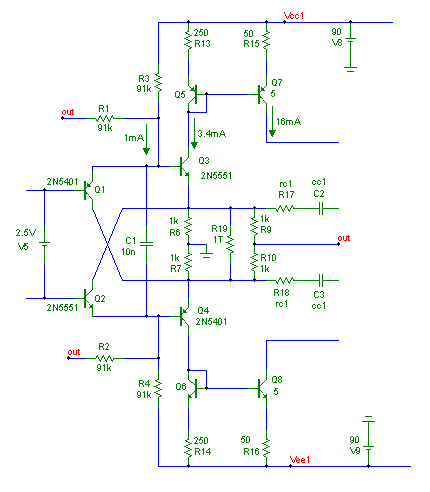

2nd reply
Hi Andy,
Using +/- 90V rails, this version consumes far less power in the resistors that act as a CCS (R1...R4), although the currents through R6,7,9,10 are still rather high at full output power. Increasing the resistor value not only decreases the bias current (no problem, just increase V5), but also lowers the current feedback, which we don't want.
Perhaps you wonder why increasing the gain of the OPS anyhow? As mentioned elsewhere, for two reasons:
1. A better step response, no overshoot neither peaking at about 3MHz.
2. Lower supply voltages for the front-end and 'headroom' for voltage regulators.
But at the expense of wasting power in the gain setting/feedback resistors (R6..10). As you see, there is no free lunch.
As for that 'small resistor', now I see what you mean. It's R19, right? Indeed, one can up the bias current with R19, but, as said before increasing V5 does the same job.
One more thing: I feel uncomfortable with the high power dissipation in Q7 and Q8. Why not using simple 1:1 current mirrors and adding an extra class AB EF stage before the drivers? And, perhaps even more important, you can use the emitters of this stage as the take off point for the frequency compensation. In this way you have sufficient gain (one beta) inside the compensation loop. Opposed to YAP, this paves the way to a more sophisticated compensation scheme, TMC or TPC for example.
See also: http://www.diyaudio.com/forums/showthread.php?postid=1613482#post1613482
Edmond.

Hi Andy,

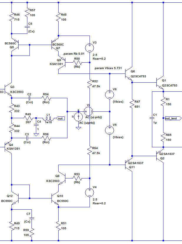

Re: 2nd reply
I had looked at this briefly in the past and had oscillations. I was also having other problems at the time, so I didn't pursue it further back then. Since things were more stable now (or so I thought), I decided to revisit the predriver idea.
I did indeed see oscillations again when the predriver was added, and tracked it down to a local Miller loop instability. I was initially able to get it barely stable by putting base resistors in the CB stage of the Hawksford cascode, and based on this data, I found that under high-slew conditions, the total peak base currents into the predriver were about half of those into the driver. Not as much of an improvement as I would have hoped, but it gave hope for reducing the "VAS" current from 30 mA to 10 mA, which would then allow replacing the 2SC4793/2SA1837 cascode transistors with KSA1381/KSC3503. I also got a slight reduction in distortion, presumably due to lighter loading on the "VAS".
This led to the need for analyzing the local Miller loop gain. With non-complementary circuits, I have always done this by blocking the global feedback (for all but DC) by putting a huge series inductor and shunt capacitor in the global feedback loop, then putting a loop gain probe inside the Miller loop. This results in a bandpass filter-like response for the Miller loop gain exactly as expected. But when I try this with complementary circuits, the results are nonsense. I had almost given up on this, but then I realized that for this configuration at least, it's possible to artificially join the two halves at the Miller feedback pickoff point and put the loop gain probe there. See the picture below. The simulated Miller loop gain of this configuration is just as I expected.
In looking at the loop gain of some idealized circuits in this configuration (just ideal controlled sources and no EF in the loop) I convinced myself that the Miller loop gain of this configuration, in the region where it is flat with frequency, is exactly its current gain. Maybe this is obvious to you, but it was not to me . Anyway, having a current gain of around 6.8x was the source of the Miller loop instability. The Miller loop gain magnitude wanted to stay flat, or even peak a little, in the region of tens of MHz where its phase was dropping off a cliff. In desperation, I tried the series RC networks shown below in the current mirror to reduce the current gain to about 1 at high frequencies. I thought this might ruin the distortion and the slew rate at the expense of stability. Not so. I was able to get a 90 degree phase margin in the Miller loop, without degrading either the slew rate or the distortion at all. So I'm a happy camper now. I may try more exotic compensation techniques later, but it's not obvious to me how to stabilize the Miller loop for these. I'll have to think about that some more.
As it stands now, bias current in the drivers are 30 mA, 15 mA in the predriver, 10 mA in the "VAS" and about 1.85 mA in the input stage.

Miller
Hi Andy,
Now things are getting interesting, as I encountered the same problems with the Miller compensation and I'm using the same technique (an additional lead-lag network) to suppress oscillations of the VAS.
Before going further I like to know some details:
The value of Cci, Rci, Cx and ULG of the Miller loop.
Also, what kind of output stage, BJTs or MOSFETs and how many of them?
How high are your 'high-slew conditions' (in V/us)?
I'm asking this because I'm amazed why you need so much VAS bias current.
BTW, the VAS of my (still virtual) amp draws only 4.5mA and at 100kHz sine and full power, the AC component is less than 1mA-pk-pk. (OPS: 4 pair of MOSFETs + driver, no pre-driver, VAS current gain=24dB ).
Edmond.

Re: Miller
Hi Edmond,
ULG of the Miller loop is about 20.5 MHz. At 1 MHz, the Miller loop gain is 1.1 dB down from its max value of 15.2 dB at 27 kHz. Cx is 100 pF. Cci is also 100 pF. Rci is zero. I know the latter sounds strange for a CFB stage, but when the feedback is taken from the VAS collector, I've observed that the best Miller loop stability occurs when Rci is zero. Based on only a very quick and preliminary look, just the opposite seems to be true when the feedback is taken from the predriver emitter - Rci needs to be non-zero in that case.
10+10 IRFP244/FQA9P25. Simulation uses EKV models I've developed for these.
I'm trying to get non-slewing behavior with a square wave input of +/-80V, low-pass filtered by a buffered 2k/390pF filter. See the attachment below. This gives about 205 V/us. I vary R58 to adjust the max dv/dt of this signal as needed.
I see I've caused some confusion, mostly because I'm confused myself! Here's what happened. In early simulations with this square wave signal, I found that the output would completely go crazy when one of the VAS transistors would cut off. I did a bandaid of increasing the VAS current for this reason. But this was before I figured out how to get meaningful Miller loop gain sims by joining the complementary halves of the circuit as in my post #270 above. Once I was able to do so, I realized that my prior experiments were with a VAS that, while not an oscillator, was only marginally stable. I believe there was some kind of large-signal instability triggered by one of the VAS transistors going into cutoff. Once I was able to get a robust phase margin in the Miller loop using the series RC compensation network, I found there was no problem at all when cutoff occurs under high-slew conditions. In this case, the input stage cuts off and the VAS does not. I'd like to go back and experiment with reducing the VAS current still more (it's 10 mA now), and also eliminating the predriver. I haven't done this yet though.
Yes, as far as sine waves go, peak currents are very low. What I'm doing is applying a stimulus to the circuit as shown in the attachment below (or to parts of the circuit like the driver/OPS combo by itself). I look at the peak current through E5. This can be unexpectedly high. For example, with a diamond buffer input at the front end of the output stage, the peak value of the sum of the base currents is in the uA range with an 80 Volt peak sine wave at 20 kHz. Yet when the 80 Volt peak square wave below is applied, I get about +/- 15 mA. (BTW, the odd arrangement of two series sources is to get a square wave that starts at zero Volts, then goes to +/- 80 Volts thereafter).
