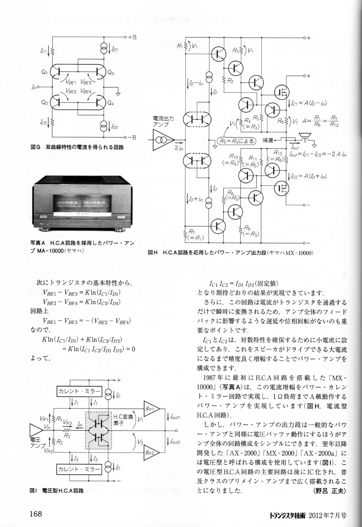

I scanned and summarized it for this forum;).
(attached img003)
On 図G(illust. G) obviously Iin = IC1 + IC2
Next , from fundamental characteristics of transistor,
VBE1-VBE3 = Kln(IC1/ID1)
VBE2-VBE4 = Kln(IC2/ID4)
circuitly,
VBE1-VBE3 = -(VBE2-VBE4)
then
Kln(IC1/ID1)+Kln(IC2/ID2) = Kln(IC1・IC2/ID1・ID2) = 0
therefore
IC1・IC2 = ID1・ID2 (fixed)
we can obtain linear Iout with amplifying IC1 and IC2 with power current mirror.
図H is a current type HCA circuit,the output stage of MX-10000 .
But general power amp's output stage is voltage buffer,
so voltage type HCA circuit is invented .
図I is voltage type HCA circuit of AX-2000 MX-2000 AX-2000a.

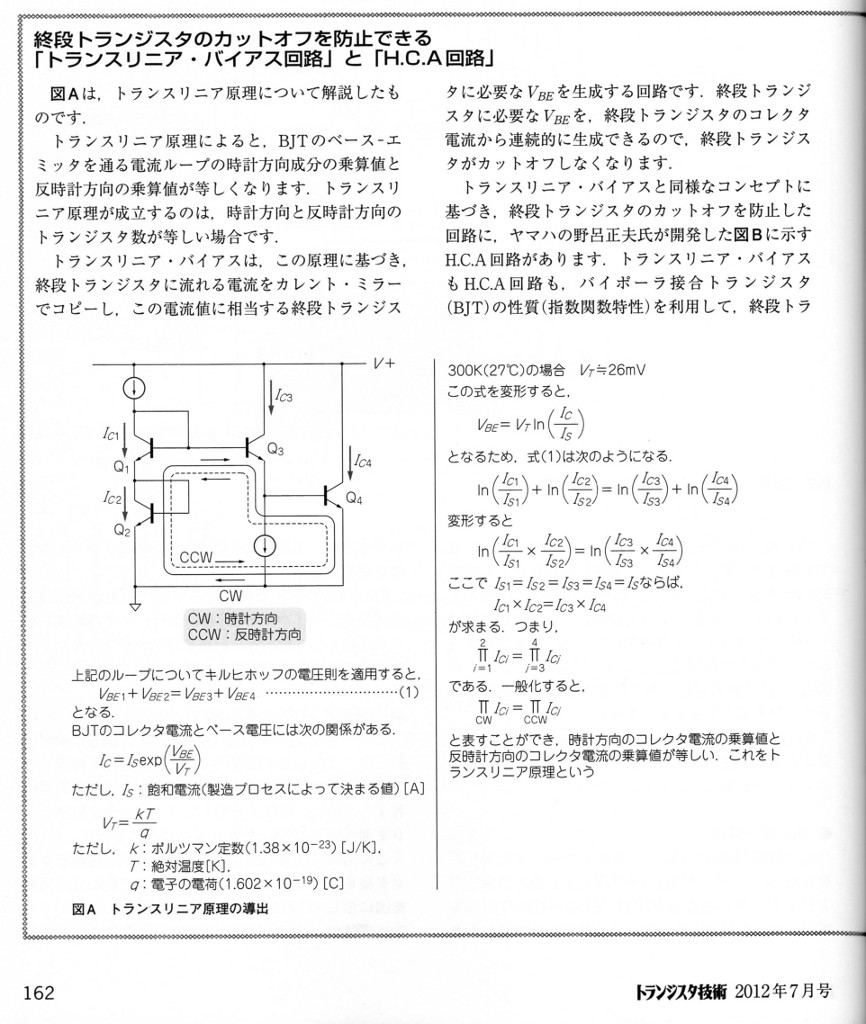

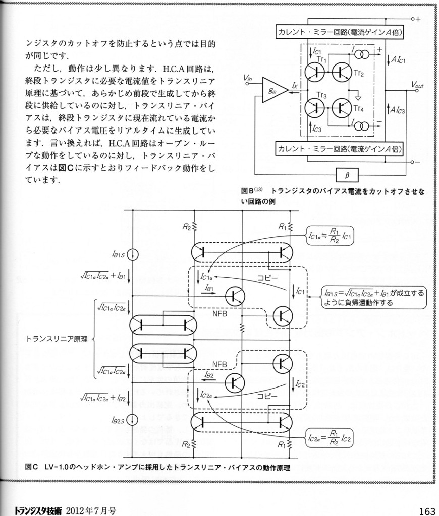

img005 and img006 explains another non-cutoff circuit : translinear bias circuit.
translinear bias circuit feedbacks output current while HCA is open loop like working.
circuitly,
then
therefore
