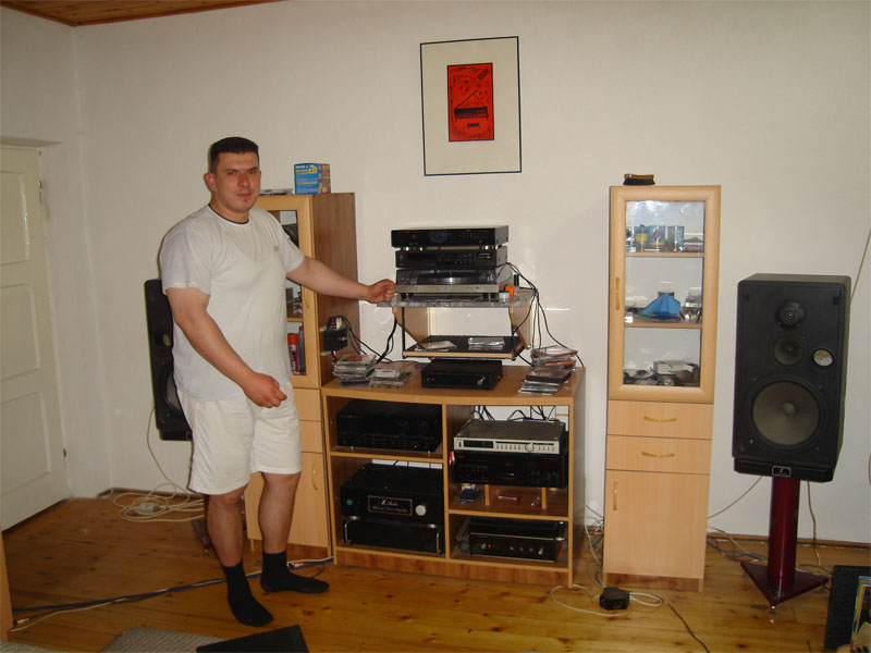

Hi All audiophiles!
This is getting stupid to compared active vs. passive filters.WHo think's that is easy to buy or made three or two stereo amps driving with active xo plus three pair of expensive speakers cables, just do it.
I have here three way passive loudspeakers and for high end listening I just listen them directly from one big amplifier 42 kg of weight which is my home made.
When I want to feel more sound pressure I can easy switch bypass switch on my active xo. it is just a two-way, and cut the freq on around 75 Hz, and other bass part of the sound goes to another amplifier just for my sub woofers, but in my loudspeakers which now runs as a satellites is also inside three way passive crossovers.
As some said before a very rare example of very good active speaker is Genelec but everything is inside box, filters amps P.S., so it is a compact piece and you need just a good cd player to connect.
