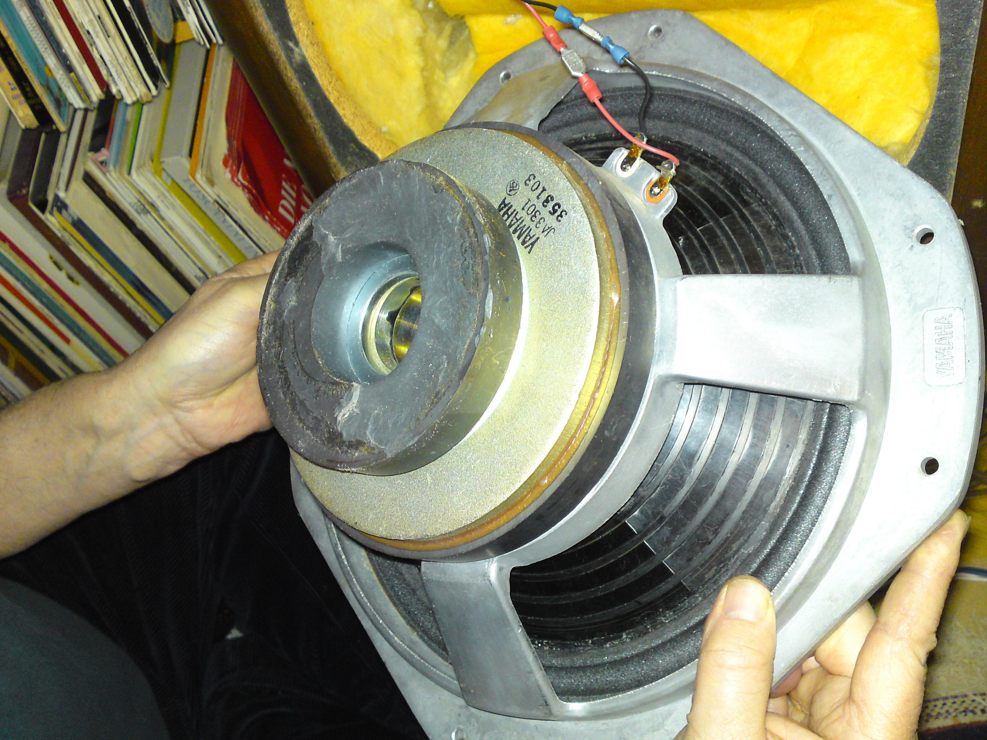

Event Horizon expresses strong doubts about the usefulness of adding a magnet that does not have a snug fit to the base plate of the woofer magnet. Well, I had similar doubts before consulting a friend of mine who is an acoustical engineer. As I recall it he said that using a smaller magnet that attaches to the curved part of the back plate only moves the magnetic field of the new magnet a couple of mm out of the ideal position which is of minor importance. After having tried adding a magnet I am convinced that this one of the cheapest and most gratifying mods that you can do to improve the lower register. If you have the magnet I would like to encourage you to try this before passing judgement.
The magnet does not to have to be glued to the back of the woofer. You turn the repelling side of the new magnet towards the back plate of the woofers magnet. When it gets really close it is attracted and attaches without the need for any glue.
Hopefully I will be successful in attaching pictures. It is the magnet and the woofer of the NS-2000 joined together without the help of any glue.
I tried to ad more pictures but was unsuccessful.
Interesting that you say it effects the bass end. I would expect this as the magnet will alter the Qts, however the standard driver Qts is approximately 0.22 which is pretty low & indicative of an already pretty strong magnet & an overdamped response in the standard cabinet.
By placing the magnet on the back as you have done with the poles repelling each other you have slightly increased the concentration of magnetic field in the gap yet again, lowering the driver Qts even more. I shouldn't think it'd be much at all in all honesty & as i mentioned, doing this is much more sucssesful when the whole magnet is flat against the rear plate of the motor structure.
If you notice a difference & happen to prefer it then fair enough :D
