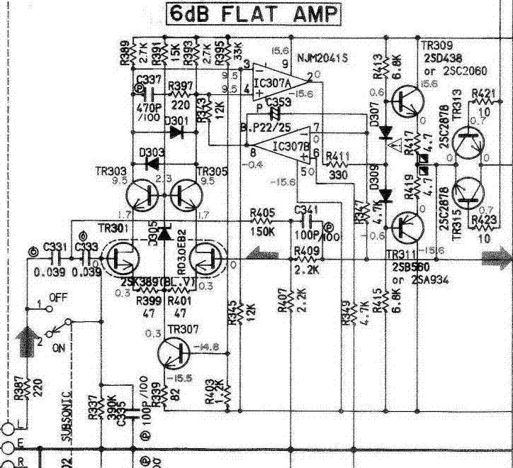

c- series output muting
During the weekend I analysed the c-65 circuit in mor detail. Unfortunately c-65 has exactly the same protection circuit on both line and headphones outputs. The headphone oputput does not bother me.
The line output can be either shortened or a small relay based circuit added. I'll post such a circuit this or next week. It needs +12V PS, a darlington and two relays (or one dual) plus a few diodes, resistors and a cap of course. The PS can be built on two 1n4004 diodes, 7812 regulator, a few caps while AC can be taken from the transformer. PS can be located close to the transformer and relay circuit on the output.

Hi, Janusz,
The relay is is a good idea.
For the signal of command you can use what arrives on the base of the transistor of muting.
To change the OP-AMP can be a good idea. nevertheless it needs to find a best substitute
this is scheme of line output c-80

yamaha c series preamp mods
Hi Robby,
If your yamaha has not relly been used or seldom used you may choose to replace a few crucial celectros in audio path with upgrades. Next parallell all audio path and PS and associated electros with polypropylenes of required values, replace PS diodes with fast soft recovery ones, desolder all the audio path op-amps, solder in sockets, get BD adaptors and choose modern op-amps to your liking.
My choices for the equalizer section are lm4562s as these are low noise and fast enoughfor that purpose and not very expensive. In tone control section I have currently op275s but ultimately I'll use opa2132Ps (or opa2132PA as a minimum).
If you want to go up from opa2132P then the best upgrade would be expensive opa627au. In all other circuits I use opa2132P except for the headphone section. I haven't yet decided which op-amp to use there. The top solution would be opa2132P plus two buf634 buffers or something similar.
If you really love your yamaha c-80 then you can use opa627au everywhere except for the equalizer section, where lm4562s are good enough. Keep in mind that variable loudness op-amp is always in the audio path so it must get the same grade op-amps as gain stages outside the equalizer section.
The only other things to do are reducing heat generted by PS (eg new toroids and a few holes in the top cover in the right places), deoxidising and lubricating your pots plus some upgrade of the output muting section.
You may go for a good relay circuit or just wire across CEs of these two pairs of transistors on the output after these have been gently removed - just in case you liked them back. Wiring the output is the simplest thing to do.
cheers,
Hi Robby,
cheers,
