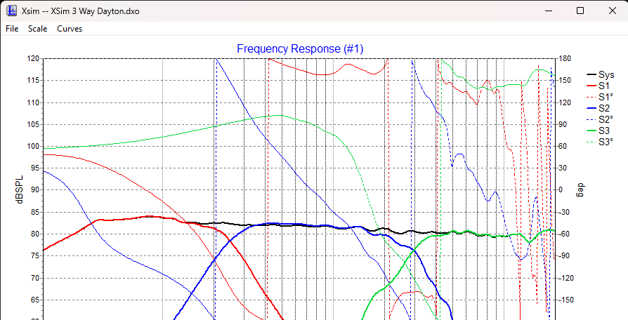

Help me understand, there is response and phase for each driver, that's four per cross and six all told. If you focus on one cross at a time, when you manipulate one driver at a time you'll notice both response and phase for that driver will change.there are 2 traces lines/driver, both acting differently,

I see the the fr line then 2 correspoing trances lines for each driverHelp me understand, there is response and phase for each driver, that's four per cross and six all told. If you focus on one cross at a time, when you manipulate one driver at a time you'll notice both response and phase for that driver will change.

They're measured, as in I'm using the data files provided by Dayton Audio. I removed the resistor from both the woofer and mid, barely made a difference, which is awesome, one less component needed.
I understand my question about phase may not be important, but I've worked out how to manipulate them, hence the question. I watched one example, where the trace came in from a rather high angle, say 160-180deg, but then flatlined around 0deg. I'm just trying to understand what the aim is here so I can work towards correct phase alignment🙏

They do not include your box so you do not have data for the baffle step. You want your bass to be a few dB higher.They're measured, as in I'm using the data files provided by Dayton Audio.
Kind of. The baffle affects all drivers, but only from a certain frequency. If you are trying to estimate the effect it's better to go for an overall step in the response rather than adjust only one of the drivers.

I adjusted the mod sensitivity by another -3dB, now being a total of -6dB, which meant I had to adjust the mid and high drivers in order to maintain my -3db tilt, which was implemented to both elevate/maintain the lower frequencies, but also soften the high mids and high frequencies.

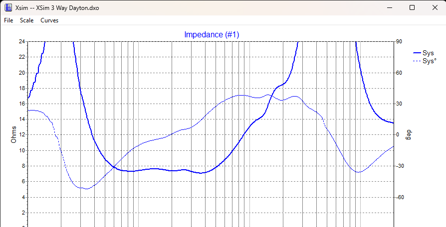

In making those minor adjustments, I raised the impedance, the lowest point now being around 7Ohms, which is near perfect for my old amp.

Altering the mod sensitivity isn't the correct way here to deal with the lack of low bass below BS. You need to attenuate the drivers with padding - ie using the components of the crossover to achieve this as per AllanB's linked posts. The sensitivity controls on the drivers in XSim are not for this purpose.
You need to work with the raw sensitivity of the drivers in the crossover because this is how loud they will play in a box with a passive crossover. If you read AllenB's excellent thread he linked more broadly then you will see there how to construct the circuits to deal with differences in sensitivity between drivers.
