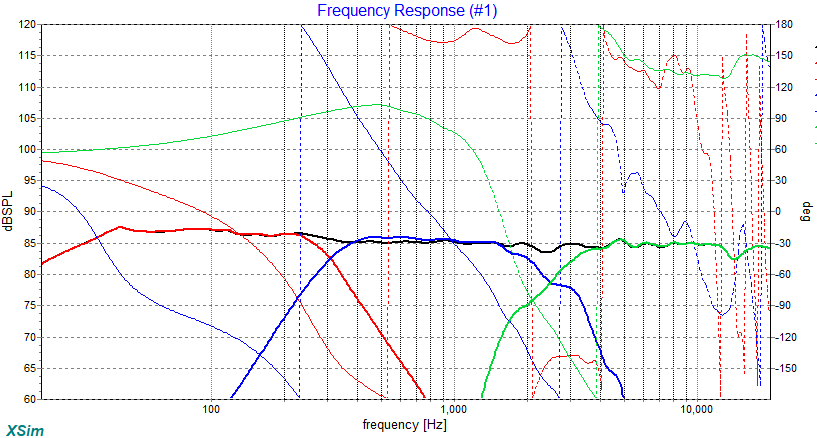

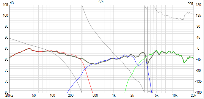

Well this is interesting, was looking for a more robust application so I turned to Vituix, inputed the exact modeling from XSim and now everything looks like ****. Can anyone explain the variances before I go down this road?
Ultimately, I want the results to be confirmed across both applications before proceeding, at least within a +/-10% variance.

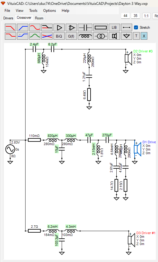

@Stormbringer748 Unfortunately, we are flying blind here. Can you please post a screenshot of what the circuit diagram looks like in VitiuxCAD? That will at least allow some basic getting our bearings...
By the way, the XSim response looks very nice.

Why does the voltage source in VituixCAD have a source impedance of 8 ohms? I think that's the (minor) error. You are essentially driving the loudspeaker system from an amplifier with a damping factor of 1!! That's why the response is so different between XSim and VituixCAD.

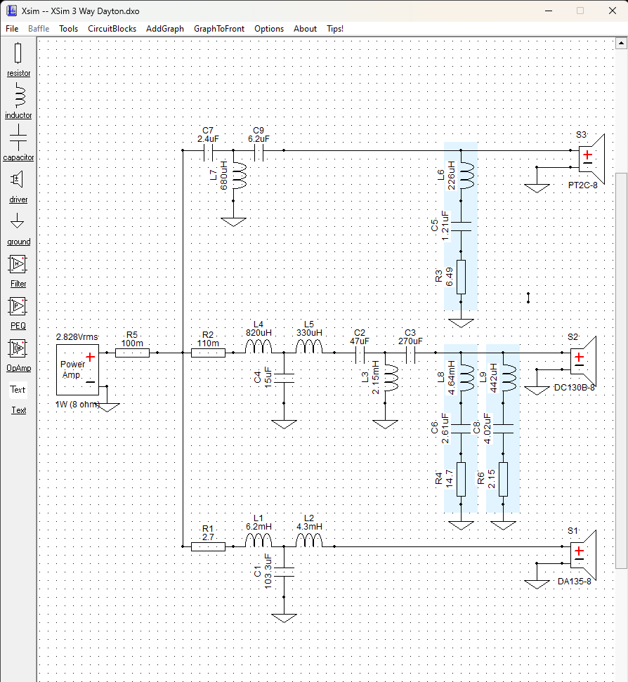

The annotation in XSim, which is "1W (8 ohms)" simply indicates that the 2.83V voltage source will produce 1W of power into an 8-ohm load.
You have inadvertently provided an excellent example of how amplifiers with a low damping factor will affect the frequency response of a loudspeaker system. Well done!

In XSim, you have set a source impedance of 0.1 ohms, whereas in VituixCAD you have set it to 8.0 ohms. The difference in those values leads to the major frequency response differences that you have encountered. You need to make that source impedance 0.1 ohms in VituixCAD to match XSim. That's an amplifier damping factor of 80, which is conservative and will lead to differences of only a fraction of a dB between that and a source impedance of 0.01 ohms.
Change the source impedance in VituixCAD to 0.1 ohms and the resulting response curves will then be much closer between the two programs. Note that VituixCAD seems to be able to include lossy inductors and capacitors, whereas I'm not sure that XSim can do that, unless you specifically add extra appropriate circuit components. So don't expect the results between the two programs to be identical, unless you go and change the loss-inducing part of the circuit components to be negligibly small.

In XSim, it's a way of adjusting the voltage referenced back to a resistor of a given value for 1W of input. It has nothing to do with the source impedance of the voltage source that's being included in the circuit. XSim assumes an ideal voltage source, and you need to add the appropriate series resistance if otherwise needed.I'm still confused though, because I set the ohms in both X and V, so why the variance?

You did not set the source impedance, you set the level at 1W into 8 ohms, which changes the output Voltage only.You say that I had set the impedance within XSim to 0.1, but I didn't, it was set to 8,

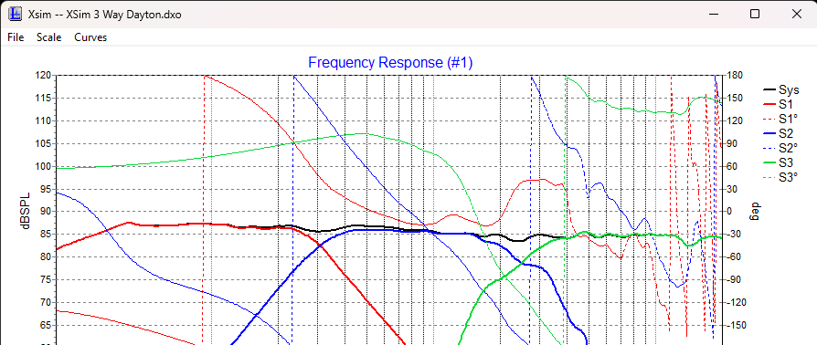

I've been reading copious amounts of material and yt vids for about a month, so totally new with zero experience in electronics. As with everything there are competing thoughts on the subject, with some saying you need to get it right, others saying just focus on the frequency response as phase isn't so important. It's hard to know who right and who's wrong.
My limited understanding is this, I should be aiming to have the phases cross each other near the intended crossover point. Close or way off?

It's difficult to manipulate both until you get used to it. That's why I suggested getting it within 90 degrees.
Getting it to cross at the crossover is an incomplete picture, but having phase the same an octave either side of the crossover is a good goal.. later you may learn other ways to do it.
