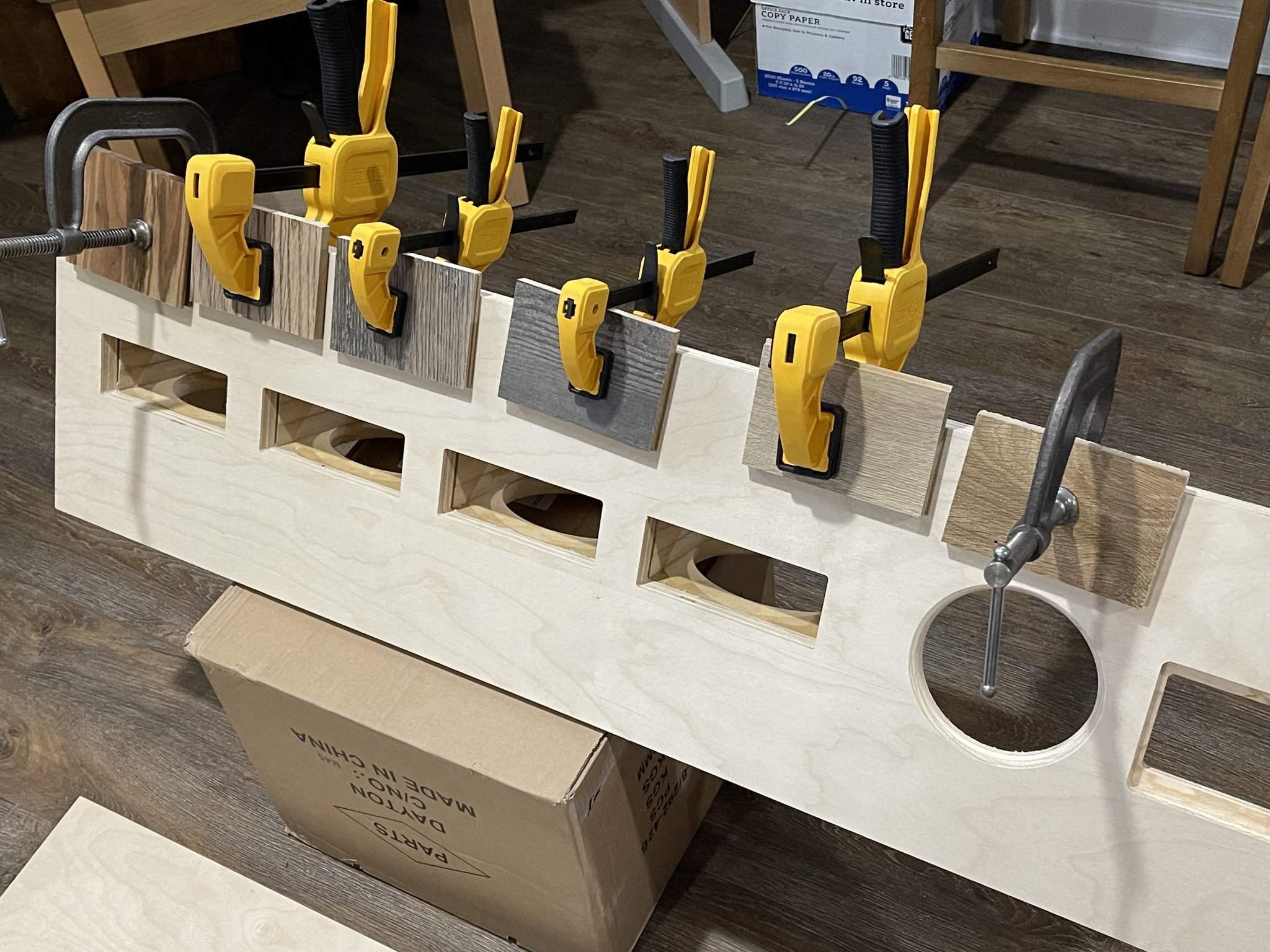

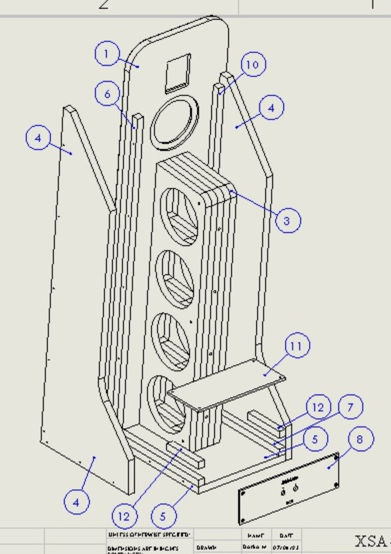

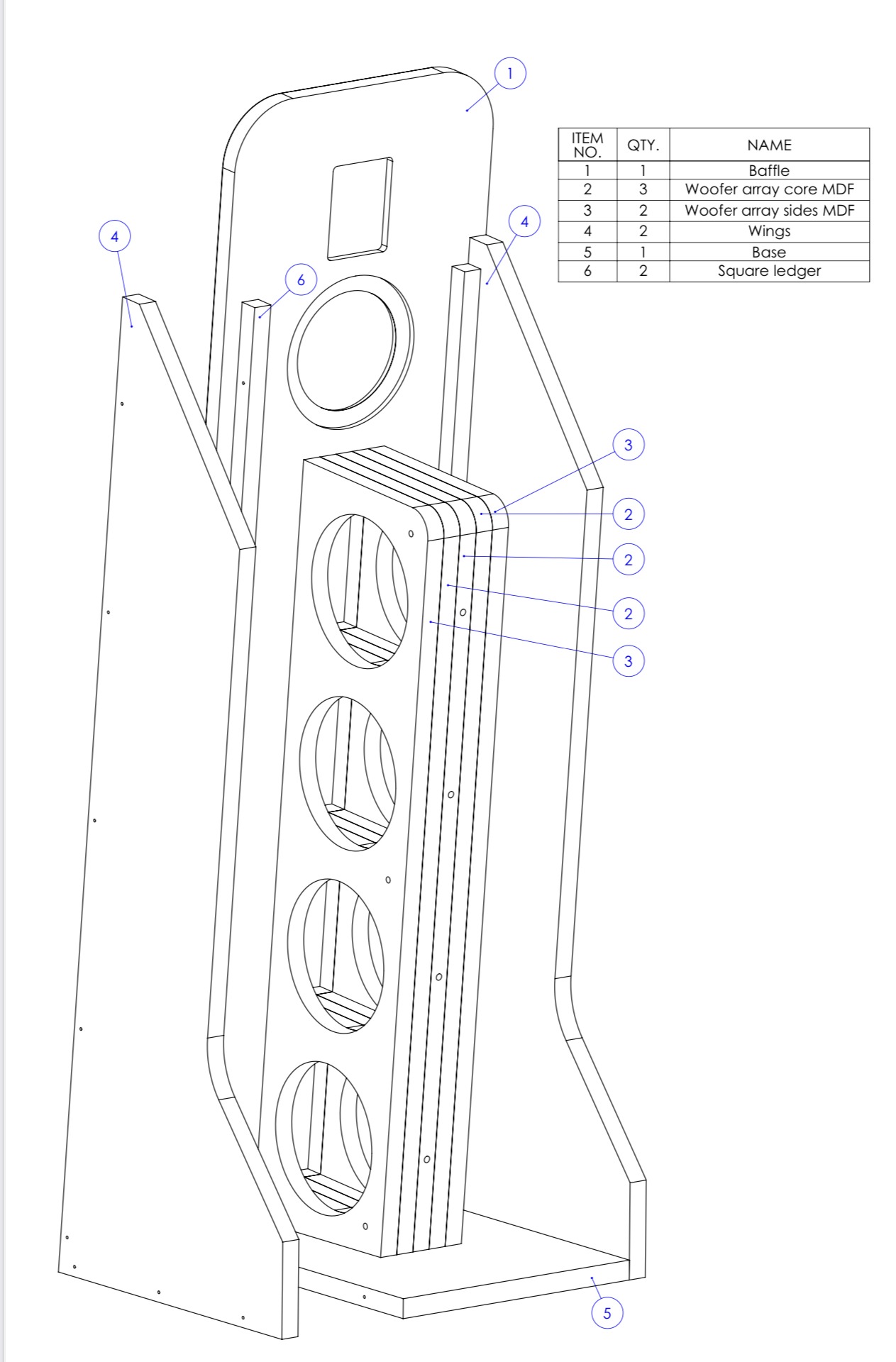

More progress gluing the 3/4in square ledger onto the baffle using Titebond and clamps. The wings have predrilled pilot holes for you to make accurate and well spaced holes for the wood screws to mount the wings to the speaker. I only have enough clamps to do this one at a time. The glue sets under clamp pressure in under an hour so it goes faster than you think.
I am trying to decide on the finish. I’m going to paint it either white or black. No stain or oil this time.

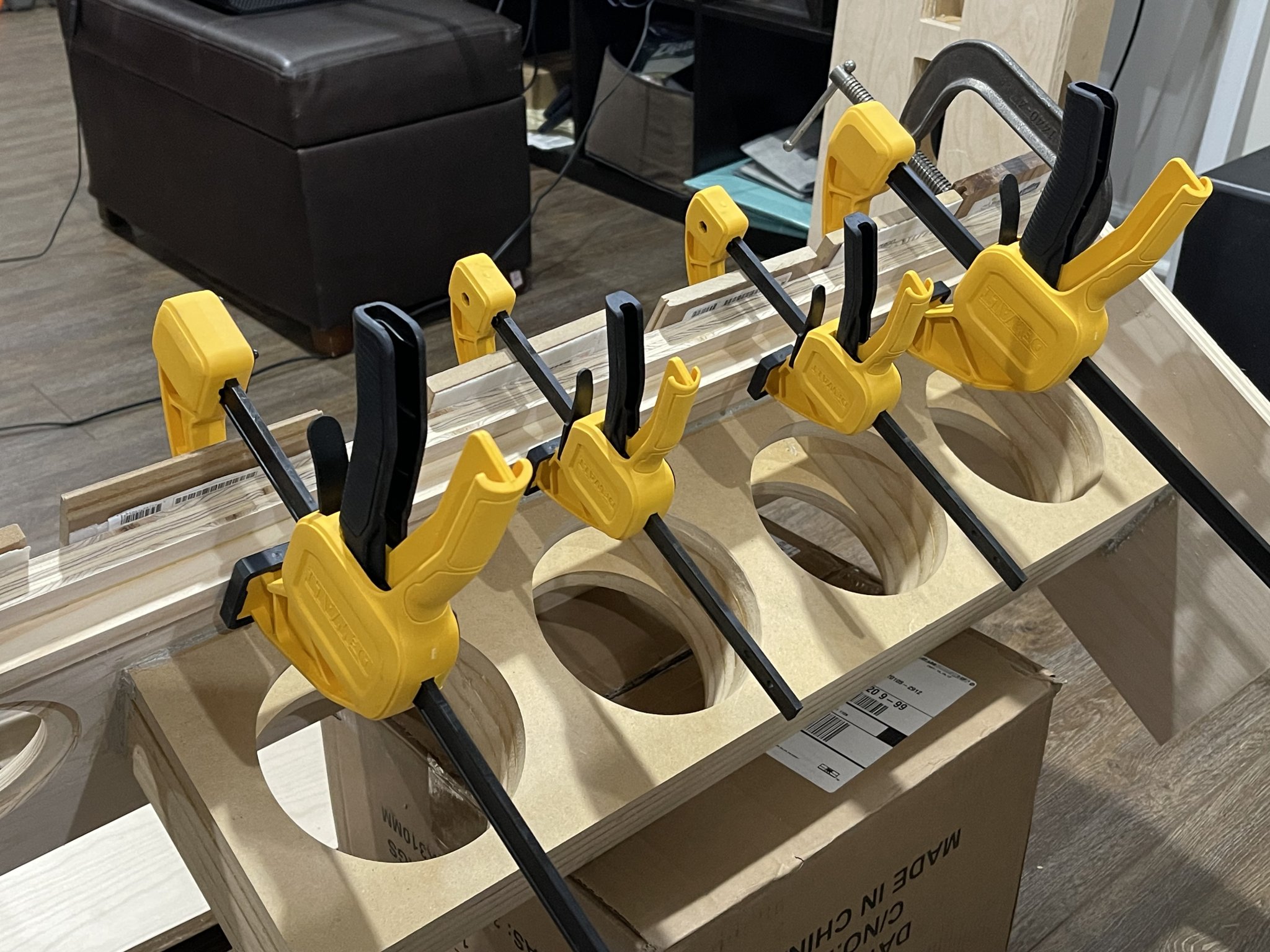

Proper glue? I heard someone mention a glue brush, I figured it would be in different container.
It is construction adhesive.

I use Titebond and 1in stiff flat paintbrush for painting trim. Apply glue to MDF sheets and spread with brush.
For gluing woofer array to baffle and base I used Loctite PL Premium construction adhesive in large caulk gun tube. The PL Premium is too thick and viscous to spread with a brush. A popsicle stick works though. Make sure you use gloves. The stuff has no known solvent that is effective. Once it gets on your hands all you can do is wait for it to cure and leave a film that you can peel off your hands.

You will also need at least 6 clamps to be able to assemble these parts evenly. I used DeWalt brand but they are pricey. These might work just as well.
WORKPRO Bar Clamps for Woodworking, 6-Pack One-Handed Clamp/Spreader, 6-Inch (4) and 12-Inch (2) Wood Clamps Set, Light-Duty Quick-Change F Clamp with 150 lbs Load Limit Blue https://a.co/d/bhZPCDk
