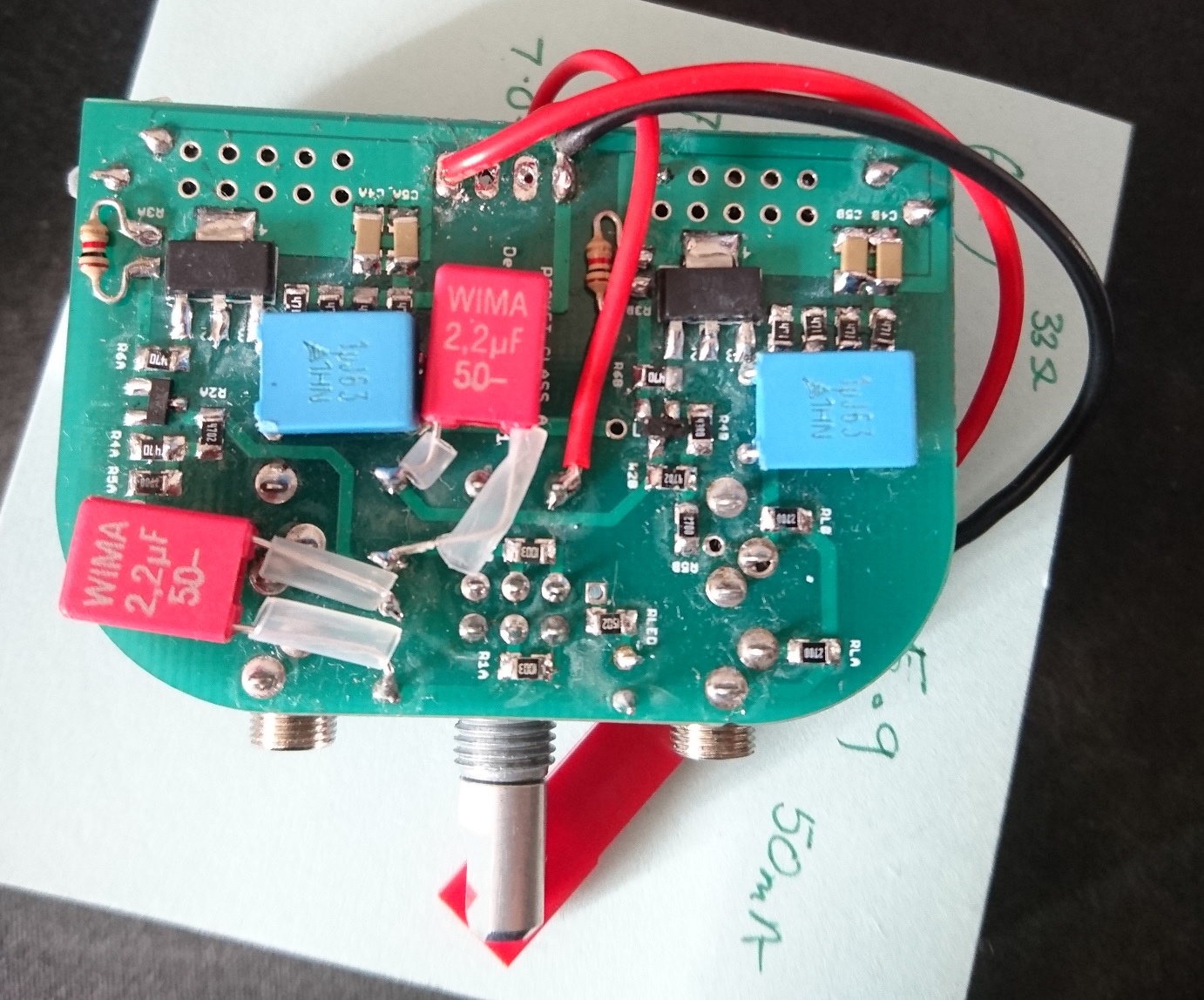

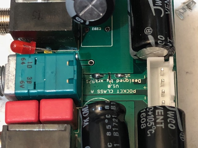

Hey Stellar - sorry I haven't been getting email notifications on this tread for whatever reason, thought it had gone quiet. I still had to cut the trace, but instead of soldering to the trace (worried it may cause the trace to lift later on) I used the vias/header hole and the pot leg instead
I haven't tried, but I think keeping the header for power would still be possible? If you wanted to do what I did and stuff the capmx between the power & output caps you might have to use thinner gauge wires in that case.
YOB, did you manage to wire in the CapMX without cutting a trace? Looking at this photo of your work. Looks like you are going between a connector header hole and a pin from the switch in the pot? Seems easier!
643684d1509698346-xrk971-pocket-class-headamp-gb-orig1-jpg

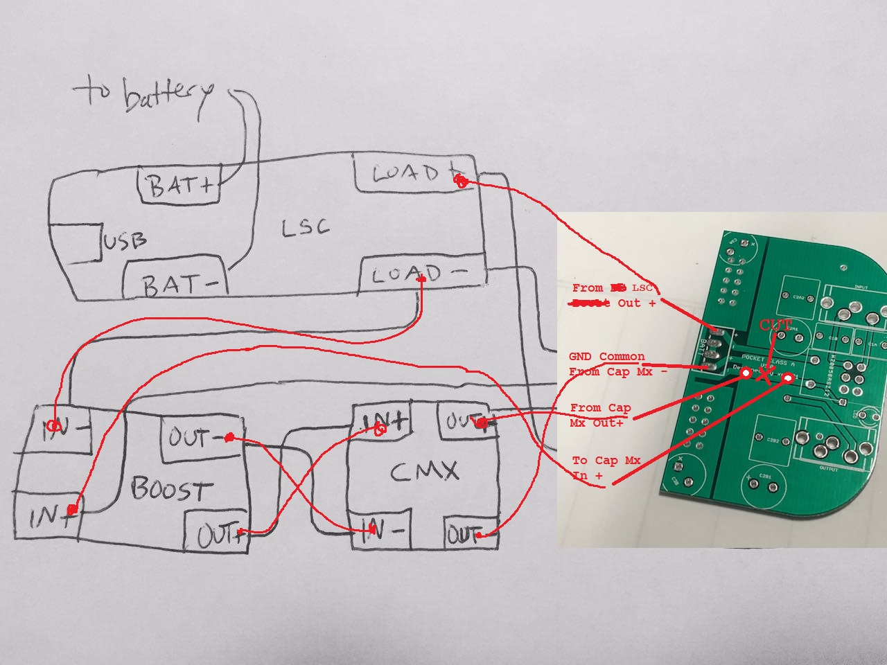

Below is how Raptor suggested connecting it in post 1178 (red lines are cuts). He also said that he had to remove the header for some reason. Is that really necessary?
652656d1514047633-xrk971-pocket-class-headamp-gb-img_3003-jpg
Maybe adding the additional boards require the more difficult hookup? Sorry I have to lean on you all here but as you know my grasp of circuitry is zilch. I don't want to screw anything up...

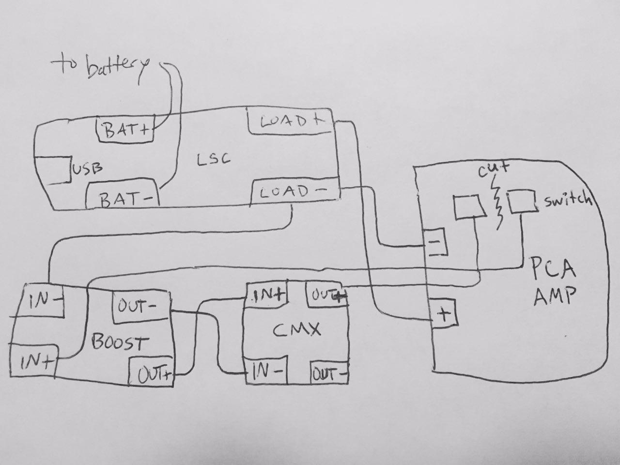

It's currently 3 degrees Farenheit in my shop, so no soldering tonight, but I can still doodle indoors...

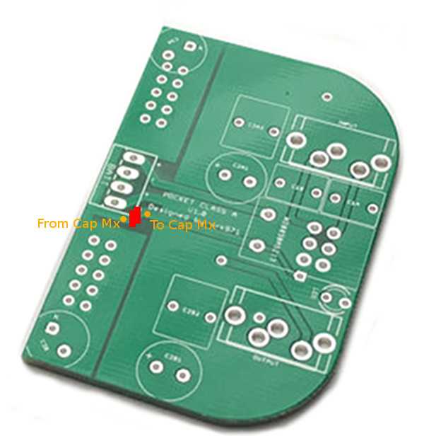

Battery/USB -> LSC Board -> Battery Terminals on PCA -> Trace Cut -> Boost Converter -> Cap Mx -> Back to other side of the trace cut and off to the PCA circuit.
I am trying to draw a wiring diagram for connecting all four boards per the RaptorLightning mod, based on the above quote from post 1239.
654164d1514862643-xrk971-pocket-class-headamp-gb-photo_2018-01-01_21-35-59-jpg
I am almost certain it ain't quite right :) Please, can I get some help? Should something be connected to BOOST IN (-)? Any other mistakes? I left CMX OUT (-) disconnected because that's how it looked in the original photo of post 1169--even though that was before Raptor changed the layout.

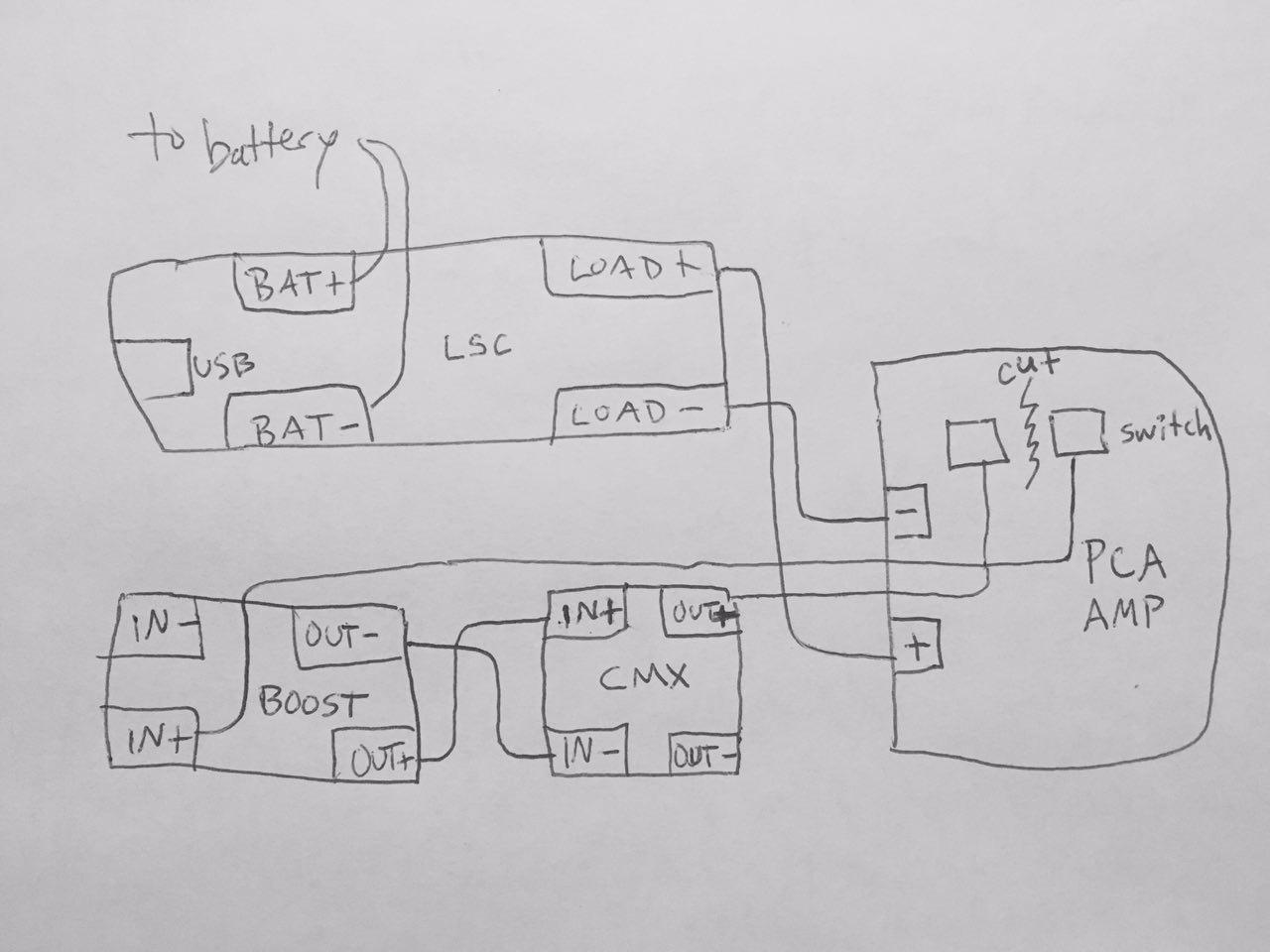

I think the only thing is in- of the boost should be connected to load- from the load share or -ve on the pca board (all the same). Cmx doesn't need out- connected because all the -ves are the same - you've already made the -ve connection from load share => pca so don't need another one (but won't hurt if you do)
Like this?
attachment.php

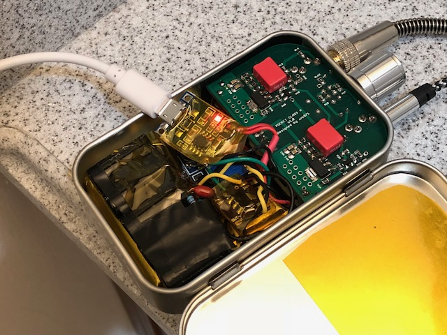

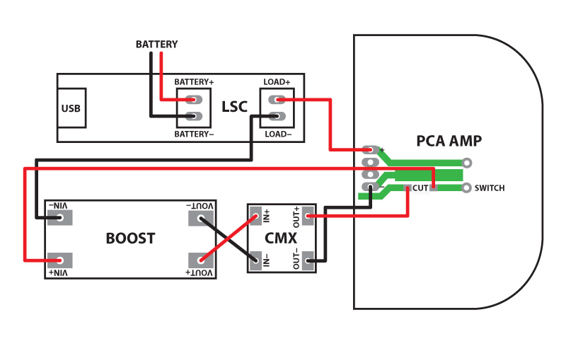

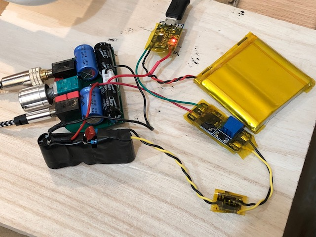

I just implemented the above diagram and it works well. I added a CRCRC after the cap Mx and before the amp. It can still play music even when charging via USB as shown in photo below. My charger module has just one connection for the battery and the output. The battery itself has the smart protection circuit built in. I am running at a full 18v Vcc to see how well this can play low impedance phones. I have also retrofitted the new resistor values for low impedance. It turns out adding a parallel 4k7 chip resistor to 1k makes it an 820R so you don't need to uninstall. I did swap out the 270R R5 for 220R though.
Here is closeup of the trace cut and the new solder pads added to go to battery and cap Mx input:
attachment.php
Here is testing the flat-pack for functionality before putting it in the case:
attachment.php
Here is the finished amp undergoing a charge and playing music at same time:
attachment.php
I don't mind opening the lid to charge. Having the power switch function to turn on/off the cap Mx is a nice touch.

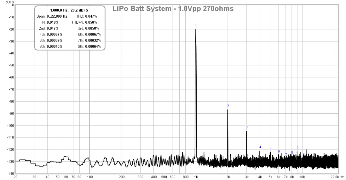

Here is FFT for 1Vpp itno 270ohms (0.05% THD all H2 and H3):

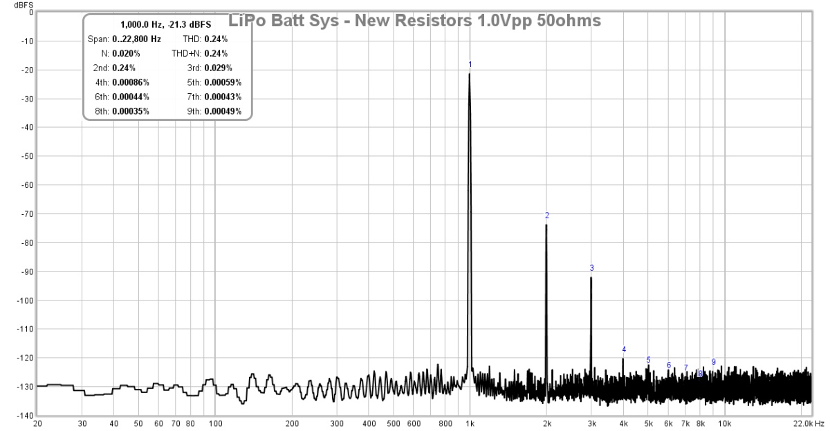

Here is FFT for driving 50ohm load (0.24% THD, and about same harmonic profile)

The DC step up and CRCRC combo is doing a great job with keeping noise to a minimum level, flat at -130dB.
